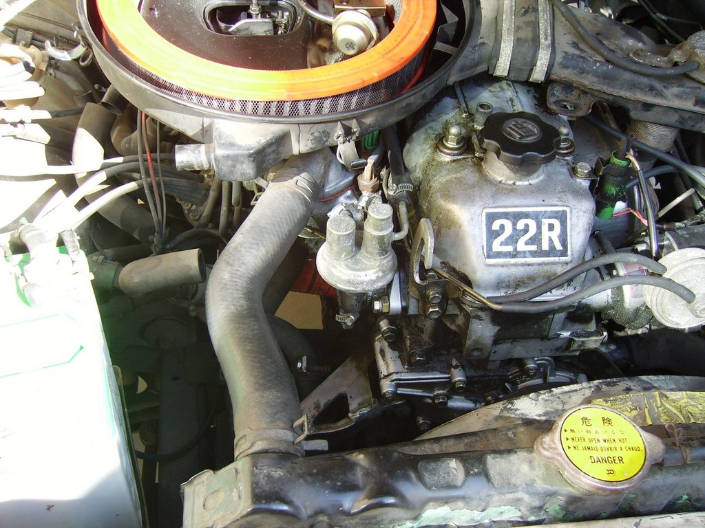

I recently over heated a bit going up this big hill (didn't go into the red) pulled over but it wasn't cooling down. I stopped the truck a hurt a hiss. This was hot coolant bubbling out of my intake manifold.
the truck needs a water pump (it's getting loose) and I'm guessing the timing chain needs to be replaced so I'll probably be starting this once I source parts.

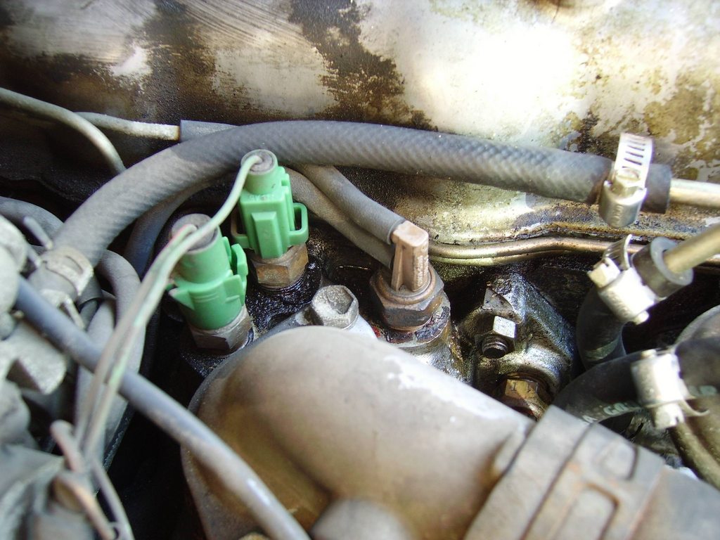

pulling the wiring off was easy! I might be wanting a rebuild carb too.
any suggestions for getting parts? I don't want cheap gaskets.

Read your post, great pics. I gave a few observations. Looks like the original hose clamps and old radiator hose, the radiator cap looks original too. My '80 has @ 100,000 mi and I have replaced the radiator, pump, thermostat, belts & hoses and of course coolant. As long as you have the radiator out for the pump, take it to a radiator shop to have it cleaned and/or fixed. Do the belts & hoses if you haven't in a few years. It feels great to know that your truck is ready for whatever comes, after all it's a Toyota and that's what they're made to do, everything!

I tore into the truck more today. The carb and intake manifold are off. I've been trying to track down a rebuilt cali smog carb with no luck so I'll probably rebuild it. Yeah the hoses are old and the hose clams have rust. I found somewhere onlike with the silacone hose set for $55 i think it was and saw one for about $10 more on ebay that had heater hoses too. I have a lot more work to do on this truck, I pop'd the valve cover to adjust my vales but might pull the whole head now to make sure it didn't warp any.
