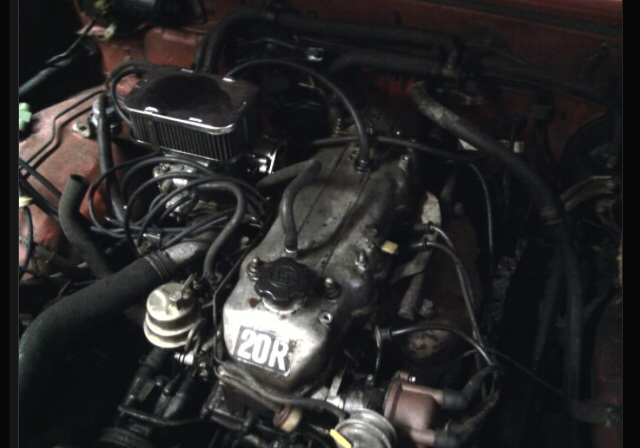

Just bought a 79 4x4 and the motor runs but seems to idle high and not smooth.
Will also backfire some.
From what I know, the motor is a reman 20r with a weber 32/36 and crane electronic ignition.
I believe that I have correctly plugged all the vacuum lines and that has seemed to help tremendously.
The truck also does not have a muffler and is running a header to a glasspack.
I'm suspecting there is another leak somewhere.
Any other things that I should be looking for?
Here's a pic of the engine bay, I'll post some more detailed pics when I get then today or tomorrow.

get a bottle of carb cleaner and spray it around the base of the carb where the adapter is, alors where the intake manifold meets the head, if the idle drops or stumbles you have a vacuum leak there and may be the cause of your problems, also if you have the two piece redline adapter for the carb they are known to cause vacuum issues. Keep us updated!

I'll definitely give that a shot, it looks to be a pretty half a** job at desmogging.
