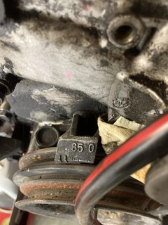

Looking at my 22R in the garage you can use the timing marks.

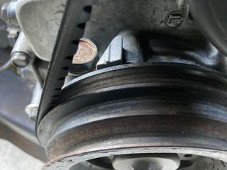

My 20R doesn't have something like this, or it has broken off? A quick search found other 20Rs with a similar setup. Early 20r?

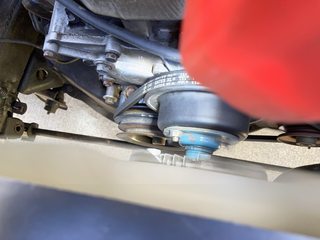

Here is where I set the timing. Based on where it was before it was adjusted, and using the 22R as a reference.
Runs decent now, but I'd like to verify everything if possible.
