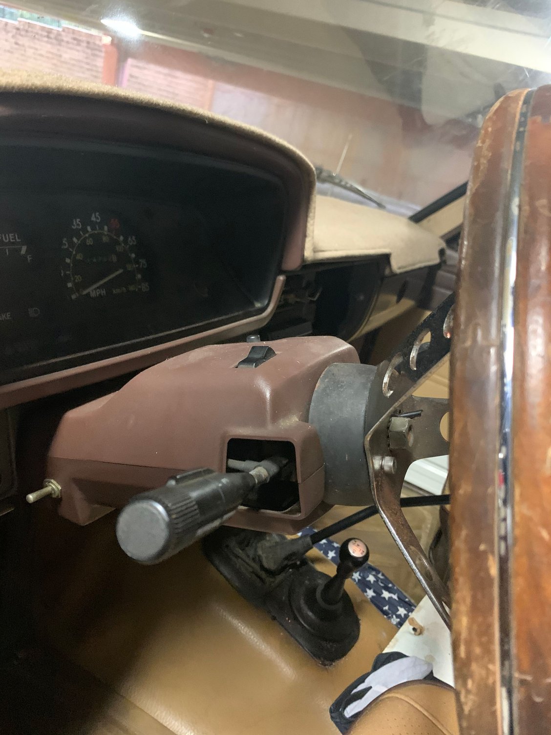

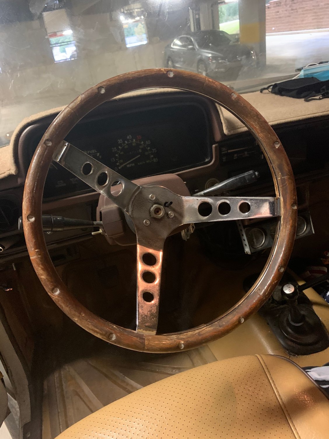

A picture of the steering wheel you have on it would help, as well as a picture of the steering wheel adaptor.
As you can see, the PO made a terrible mistake replacing the stock wheel with this crap. That is why I want to replace this. From what I’ve seen I can get a nice aftermarket wheel for the price of a used factory wheel

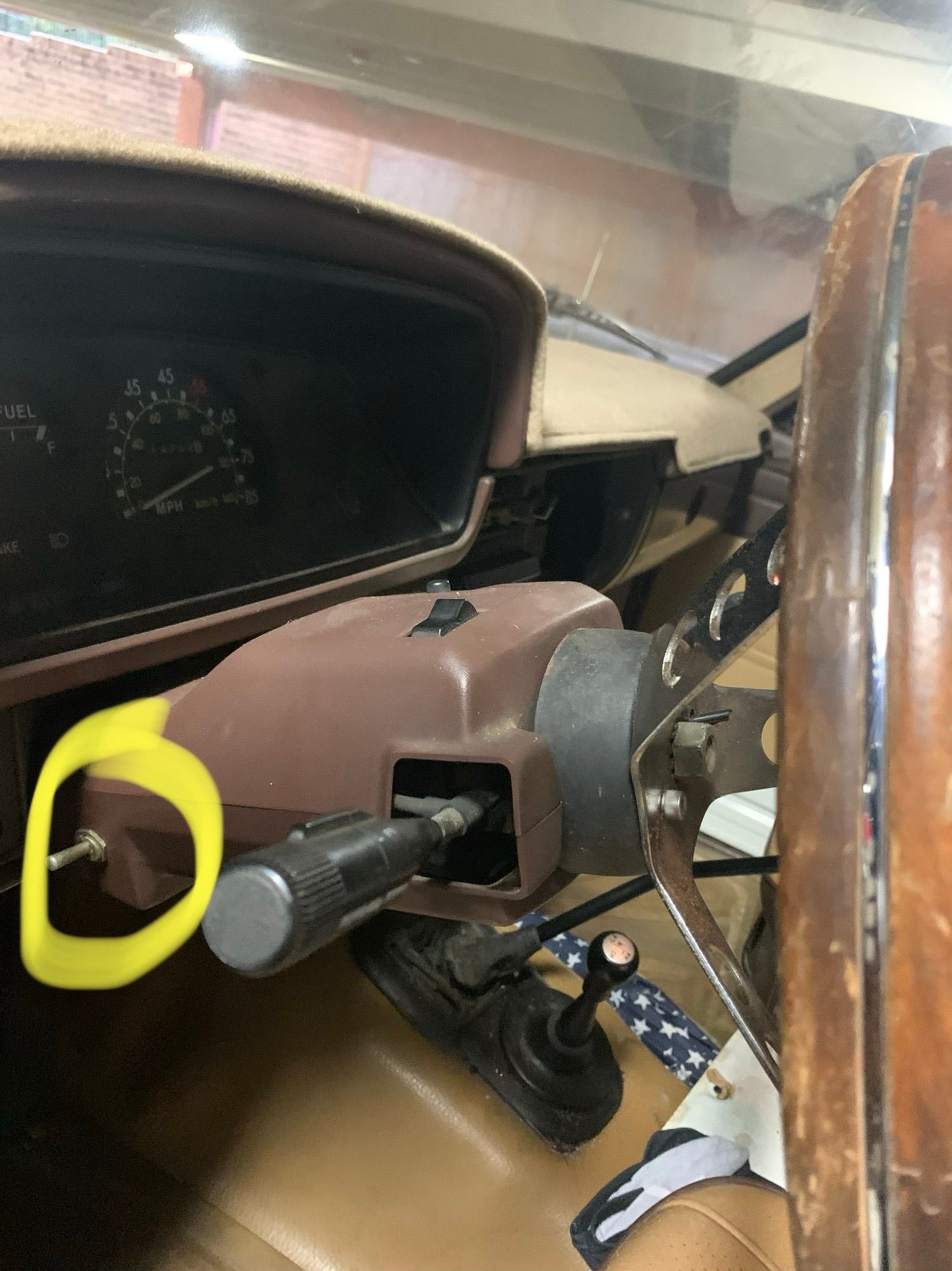

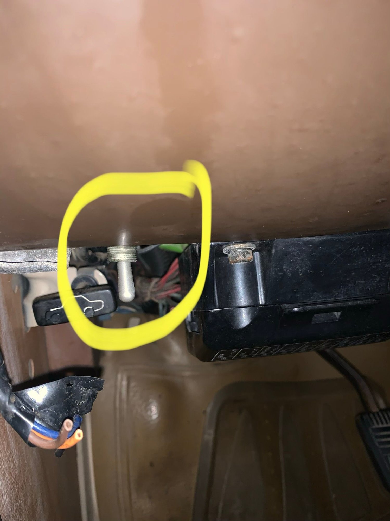

While I’ve got these pics posted I might as well ask what these two toggle switches do. Can anyone tell me?

Those toggles look as though they were added by the PO. They could be anything, really.
Have you tried switching then on to see what effect they have? I suspect, and may well be wrong, the one by the hood release might be a kill switch. Try starting the truck with it in both positions. If it won't start in one position or the other, bingo, you figgered it out.
As to the other two, you're going to have to trace out the wires to see where they go. That may tell you what they're for. They could be nearly anything, though.
As to that red thingy, with blades like a fan, where did you disconnect it from? Where was it mounted originally? It looks like it went onto a device of some sort. I wonder if one of you mystery switches actuates the red thing? Maybe?
Sorry, not super helpful...
Pat☺
Thanks, Pat. I’ll try the one by the hood latch after work to see if it’s a kill switch. One of the other two switches makes a sound like a pump running. I’ve tried to locate where the noise is coming from but have been unsuccessful. I’ll keep trying.

The red thing kind of looks like an aftermarket horn.
As noted, none of those 3 switches are factory. Neither is the little decal "Travel Tanks AUX Main"
I wouldn't be surprised if there used to be a secondary fuel tank or switch activated fuel pump.
You'll just have to chase the wires.

Well the switch by the hood latch is a kill switch. The switch on the steering column I’m unsure of but it makes an awful sound when flipped. I can’t tell that the one by the lighter does anything but I believe it once went to an auxiliary fuel tank. I’m still unsure about the red thing. It’s had that horrendous steering wheel without a horn button since I bought it. I’m going to replace it as soon as I can. Once I get the wheel off I hope to figure out what the clicking is when the wheel turns.

I’m looking at a Nardi Wheel and hub adapter. The 82 pickup isn’t listed. Which of these would work?

The steering wheel you have looks like a Grant setup. From the Summit Racing web site for the steering wheel adaptor application chart ( https://www.summitracing.com/parts/g...ns/make/toyota ) it looks like the same kit will fit all of the other Toyotas listed in the link I gave you. The same kit also fits Chevys, etc. The Grant P/N is 3593 ( http://www.grantproducts.com/product...#28/33/356/383 )
