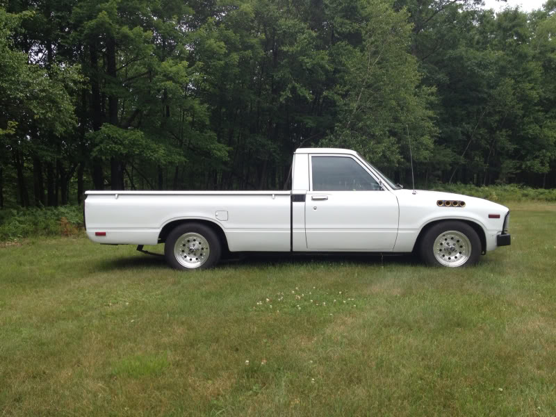

Man... I was hoping you'd say like 1/5 of the way... I wonder this has something to do with it then...P.O. put it in. In December it truly is a COLD air intake. Sorry to threadjack, found this that might help anyone looking.

Looks pretty cool. Were gonna take those things off the fender right?

Thing is... that is the fender. The intake runs through it. Like...there's a big old hole under there.

that sounds possibly cool. More pictures. I still want a little 2wd first gen someday.
