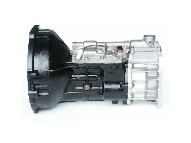

cool learned something new
found this on Marlin's website, according to the caption L45 (4 spd), L50 and L52 (both 5 spds) look the same externally--thanks for enlightening me
