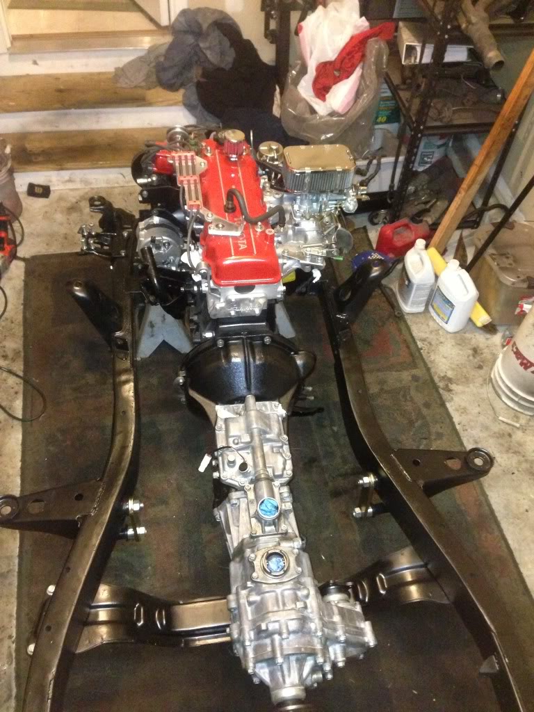

Hey everyone! The 81 is going to get major work done in the next couple weeks if all goes according to plan. I bought a 1977 2wd Toyota longbed 5 speed with 47,000 original miles to drive in the mean time while i work on the 81. Im going to rebuild the 81's original motor and and try and go through the entire truck with a fine tooth comb to semi restore and have everything in good working order. will be posting pictures finally!!! Thank you all for your help so far and i know im going to have a ton more questions once i get deep into it so dont go anywhere!! Ha ha! Im also going to have some first gen parts for sale because my girl friend is parting hers out so look for my add in the classifieds in the next week in the parting out section. THANKS AGAIN Y'ALL!
