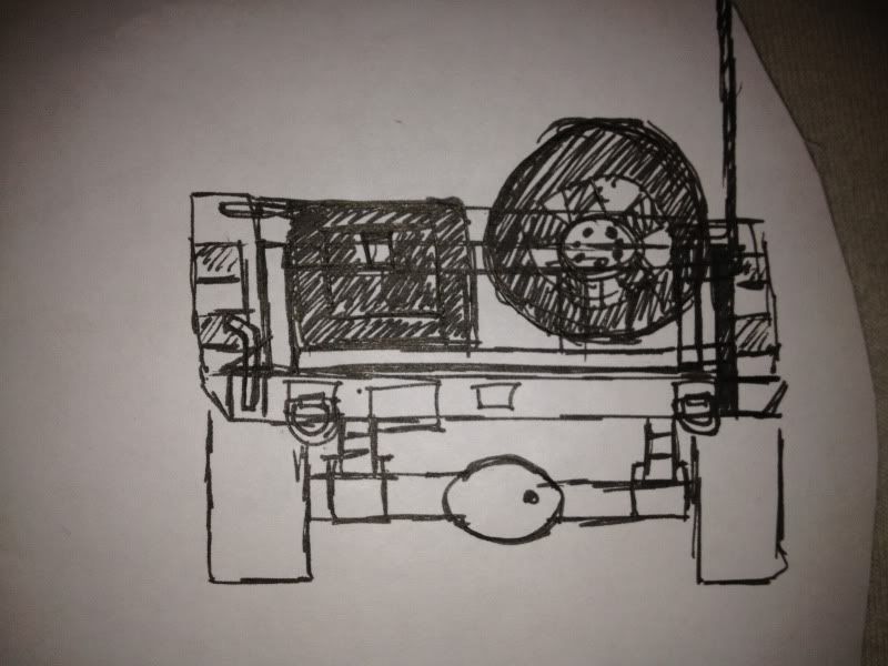

So I have decided to make a rear tire carrier, and something to carry a small lockable container\toolbox.
My poor sketch of what it will look like.
