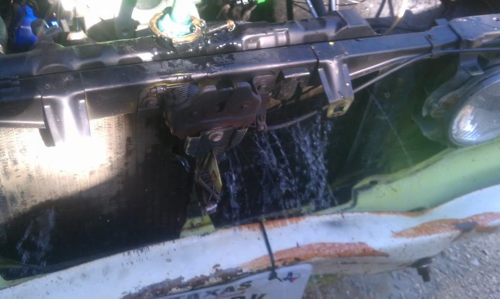

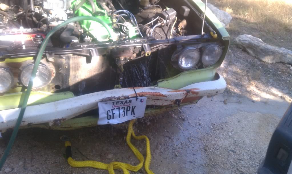

Time for an update on the project. It was about a week before Christmas I was headed to a friends house and just happened to hit a Deer
. I was able to get my truck to their house and shut off before any damage could have happened but I did lose my grill and radiator. Heres a pic of what I found the next day when I shoved a hose in the radiator to look for the hole

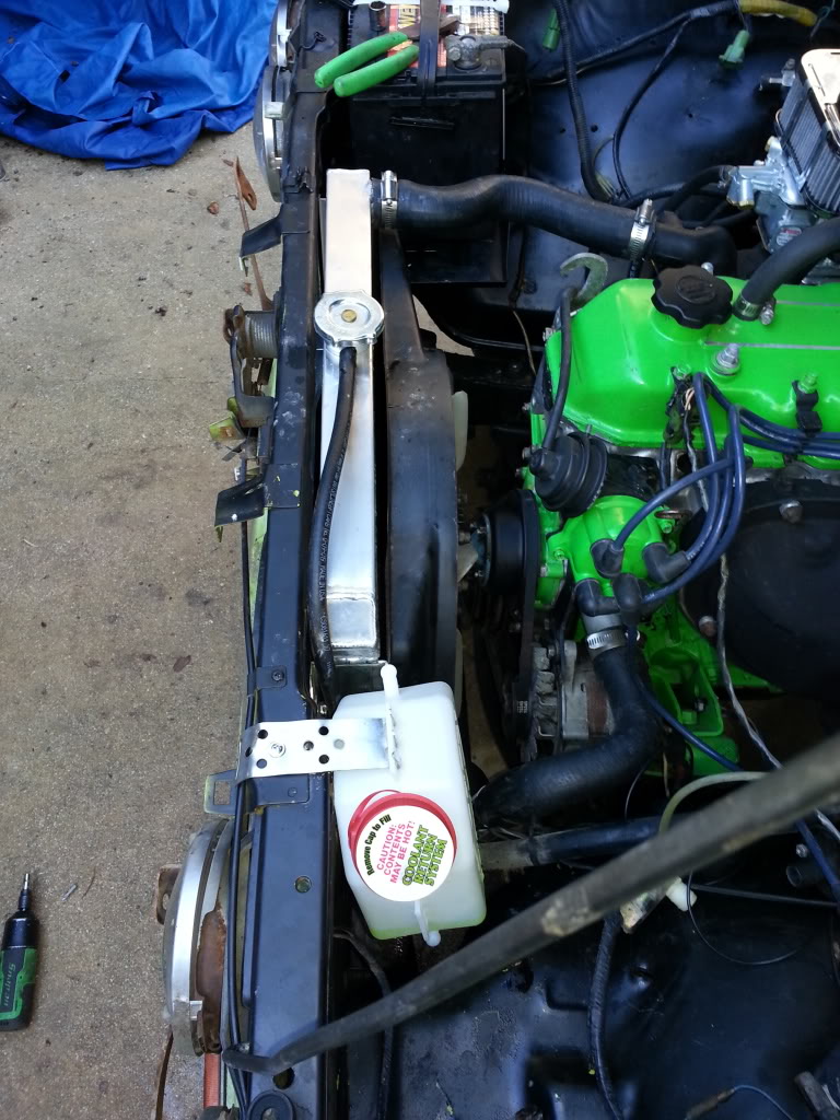

Ill admit that this pic now looking back is kinda funny how bad it was, But being december I had to wait till January 1st to order a new radiator. I went with an all aluminum one.

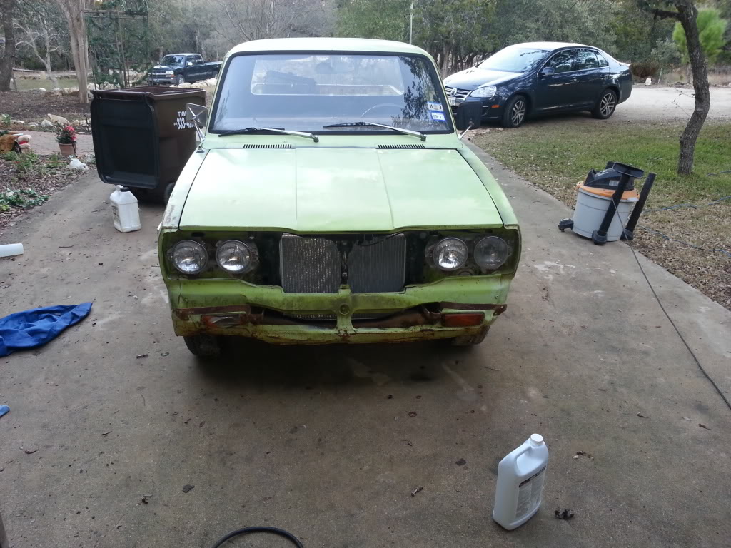

I got a new used grill from Jims and its on but forgot to mention I needed the center piece so that will be next month. Some good news was I got a great hookup on xmas presents from the fam and fiance,

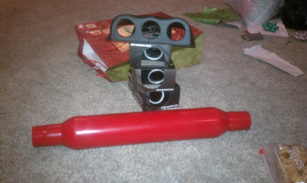

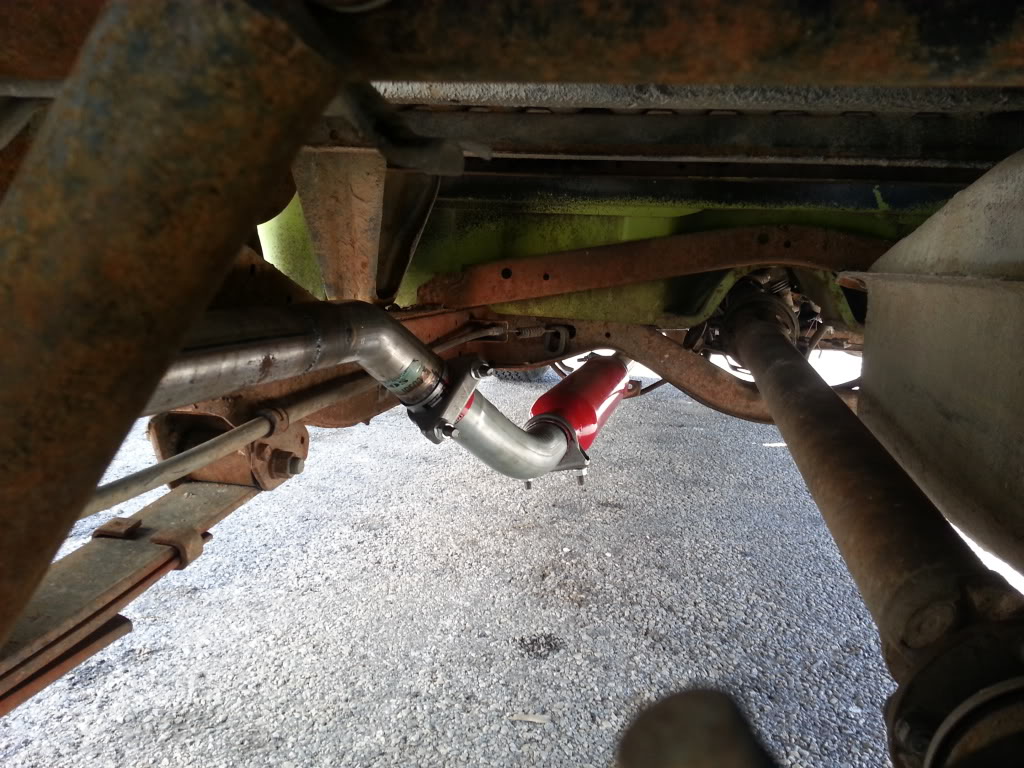

Glow shift Oil pressure, Tach, and Water temp gauge. I dont trust the idiot lights on the dashboard and want to know exactly whats going on with the truck than a glitching light telling me I have no oil pressure (if that ever happened). And today During my lunch I went and upgraded the whole exhaust to 2" all the way back with the cherry bomb.
I still need a tip but it sounds way better than the 1" rust and muffler that was on it. I wish it was more loud or had a growl to it, But i guess it is just a 2.4L. I'll be getting the gauges mounted this weekend hopefully, and then start on the body repairs.
