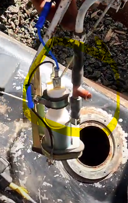

Some time back I replaced the in-tank electric fuel pump with a new one. On the rubber line going from the pump outlet to the steel hardline of the pump stalk, there was a brown plastic(?) piece that looked to me like a recirculation valve. It looks like this:
Photo Credit - Youtube/LegacyNorthWest
Figuring it was just a recirculation valve & that it was seemingly not functional, I didn't reinstall it, instead just putting a rubber fuel line in place. Whelp, I'm here to say that I was wrong.

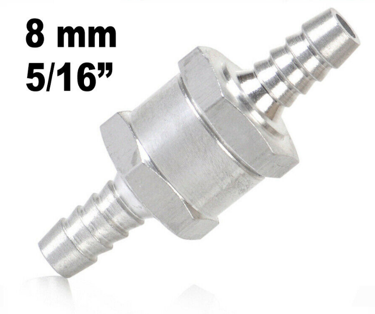

But I did find a good replacement for it. I found this one on Ebay:
The size shown is correct for 1975 to 1978; I don't know about later models but I would think they are the same. Fuel line check valves need to be installed as close to the tank as possible, so I ended up putting this one in the middle of the rubber line that connects the tank hardline outlet to the hardline that's fastened to the underbody.
Now that I've got that check valve back in the fuel line, cold starts take about 1 second or less of cranking before the engine starts! It's a huge difference.
