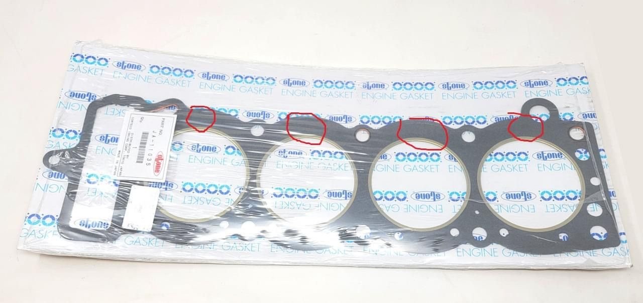

Have a 20r and need a new head gasket, cant seem to find a OEM one anywhere. Any suggestions for a quality replacement. Or is it possible I can use a 22r gasket because i can get a toyota oem one. thanks

Ishino-Stone gaskets are high quality. Here's a reasonably priced set on Ebay::
Japan Full Gasket Set by Stone for 81-82 Toyota 2.4L Pickup Celica Corona 20R | eBay
You have any idea why they dont have coolant openings on that one side? Mine has them, some HG have the holes and some don’t. Not sure the reason

Are there corresponding ports in both your head and block castings???
yes there is

millball's Avatar
Joined: Aug 2013
Posts: 4,264
Likes: 683
From: Southern Arizona
I would think you would want a gasket with the holes then.
If either your head or block did not have ports, the gasket holes would be irrelevant.
