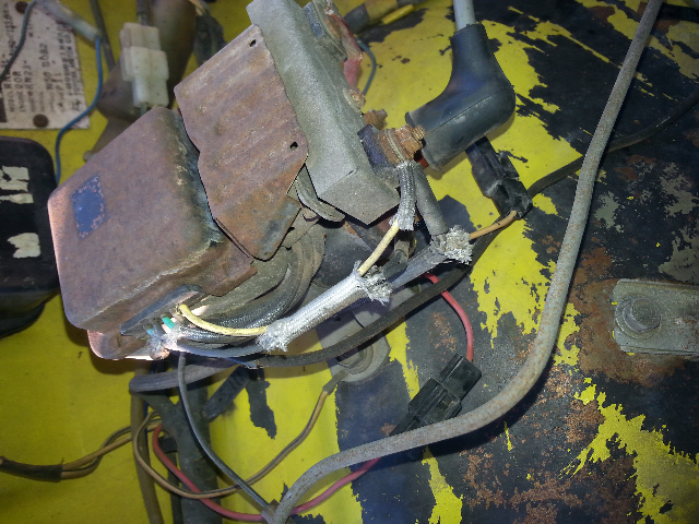

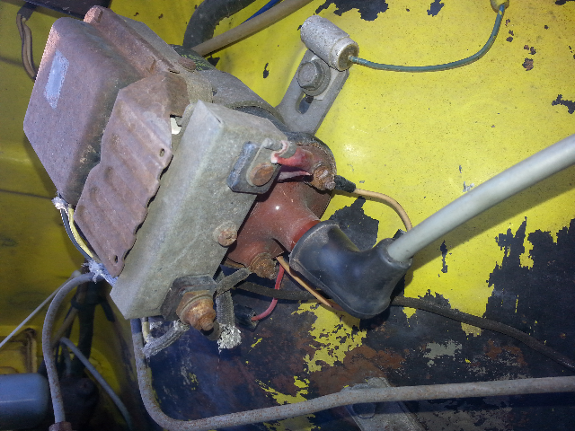

Well the master tech at work was telling me that the resistors to the coil can go bad. I have a logic probe but I don't know what to probe on those badboys
Old Aug 26, 2013 | 02:15 PM
77yotajrrrsh's Avatar
Joined: Dec 2012
Posts: 12
Two views
