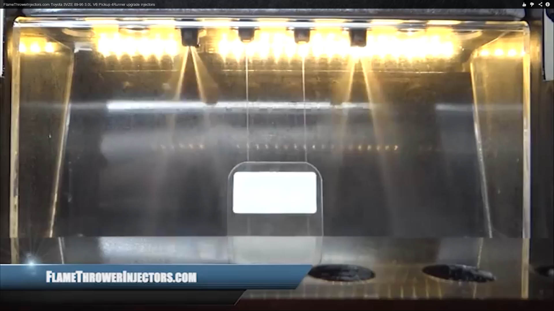

so the injectors in question are indeed superior technology, but is the v-spray pattern right for the engine design? i'm a 22re guy, so I can't answer that for the engine in question... is the spray pattern hitting the intake wall?
despite the spray pattern, why do they seem to work better for some people, but not others? air density at altitude is going to be a bigger factor, so what handles the air flow measurement? primitive afm... I would try adjusting that, per the above suggestion.
here is a frame grab of the spray pattern differences:

22RE's have a 2-hole design which might actually spray a mist, not sure since I don't own one. 3VZE injectors (at least on a 91) spray a stream. The injector technician showed me the flow after the complete rebuilt which was a stream. He noted that some of the Toyota cars/pickups have the mist pattern and were better but these trucks didn't. Perhaps other years spray a mist, once again I can't say I've only owned one.
I switched injectors to a 4-hole mist and got better low-end torque and a "seat of the pants" increase in power. The guy was right, and I trust a guy who's spend 10+ years of his life working on nothing other than injectors.
Obviously though, some of our trucks can't handle the different kind of injectors. Maybe the injectors were faulty, maybe the ECU couldn't handle the spray pattern difference, really can't say. But the bottom line is it's your truck and you can do what you want to it. Mods are always a bit of a gamble, some are great and some aren't.
