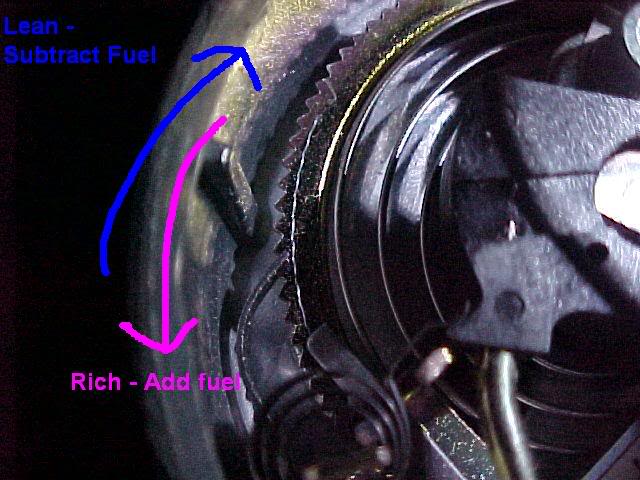

Yeah, it's not altitude. I wheel my truck at 6000-7000 ft with no issues.
Big Bear, I'd try adjusting the cog inside the volume air flow meter. Cut open the silicon and pry off the top. Take a sharpie and mark the original position so you know where to turn it back to. Once open, release the metal tab holding it in place and rotate counter-clockwise as shown below:
Start out with about 4 clicks lean. If still not work, try 6, then 8, 10, etc. etc. That will fix the issue unless you got a more serious one like a bad ECU.

He has taken the best approach...he's selling them and going back to the Denso injectors. No need to fuss with the VAFM at this point...
