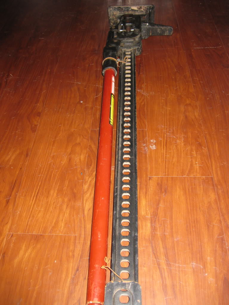

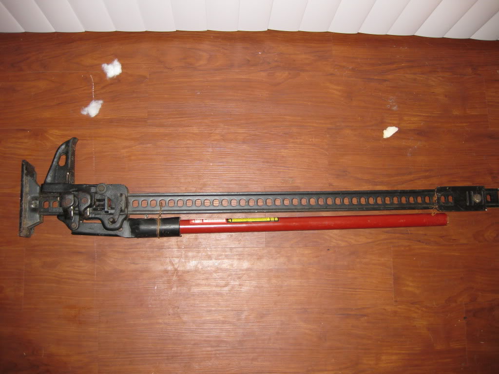

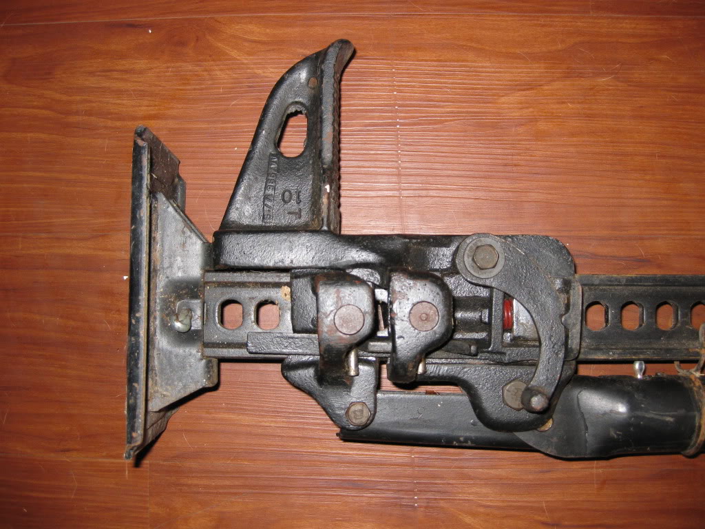

So a little bit of background information...I have been looking around for a used High-Lift Jack on Craigslist for the last couple of months because I really didn't feel like paying $80-$100 for a new one. My patience finally paid off and I was finally able to find one for $40. The only drawback is that it is an older model and some of the paint is chipping away and beginning to rust. Also, it hadn't been used in a while because it was sitting in a storage facility for the last couple of years. I made sure that the jack worked before I bought it which it does but its just not looking too good. So, I decided to clean and paint the jack to protect it from further rust damage and make it look like new again. Here is what I am starting with:

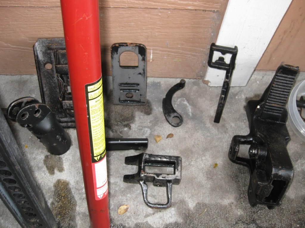

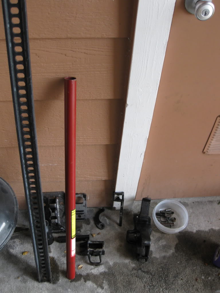

I started by disassembling the jack so I can thoroughly clean all of the pieces. After I completely disassembled the jack I used some cleaner/degreaser to thoroughly clean each part. I sprayed the degreaser on and let it sit for about 15 minutes then I sprayed it again. After another 15 minutes or so I hit the parts with the scrub brush and toothbrush to get all the dirt, grease, and grime off of them. After I was satisfied I rinsed them really well and set them out to dry.
Just waiting for the parts to dry...

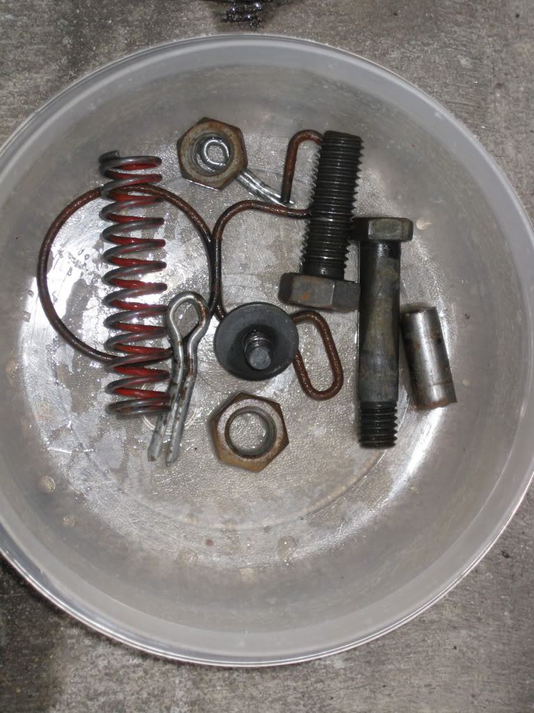

I found that using a toothbrush works best to get into small places and just a regular scrub brush works well for everything else

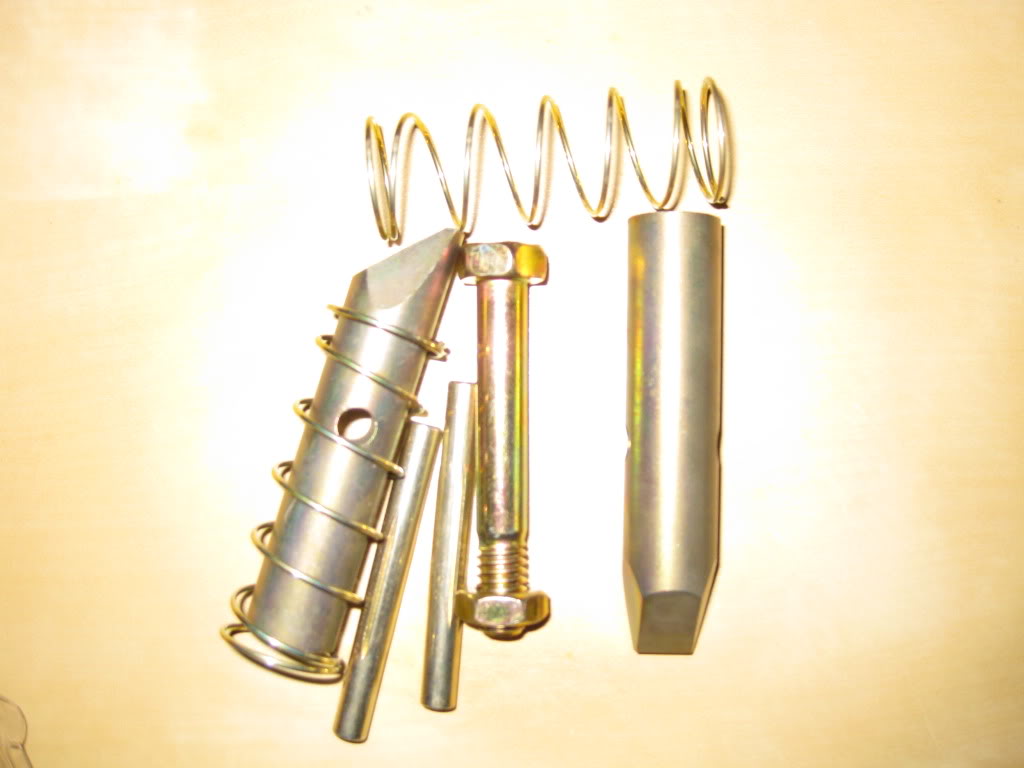

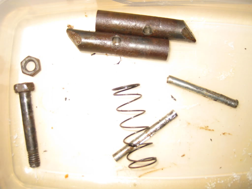

I also picked up a Fix-It-Kit to replace the climbing pins, climbing pin springs, cross pins, and the shear bolt/nut because the old one were pretty much shot.
NEW:
OLD:

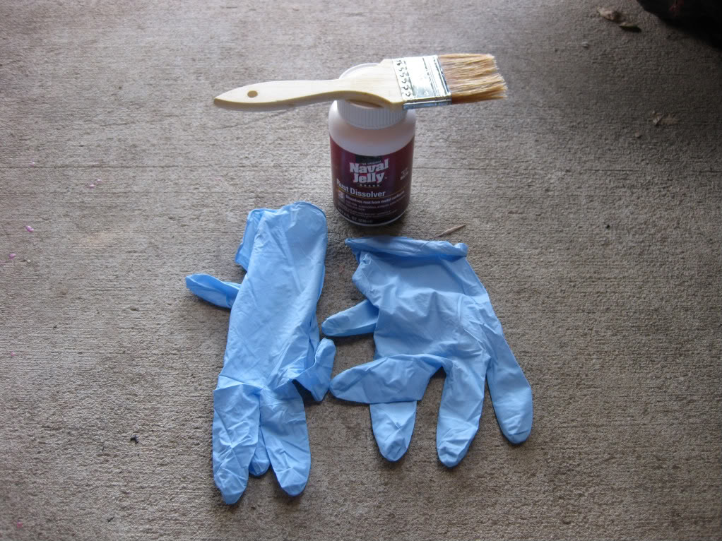

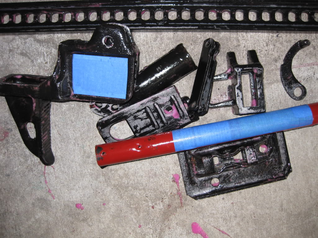

Anyway, after allowing all the parts to dry thoroughly, I used some scotch blue painters tape and taped over the labels. Then I used a cheap paintbrush to apply some Naval Jelly to all the parts. *NOTE* be sure to use protective gloves when applying the Naval Jelly because it will burn your skin!

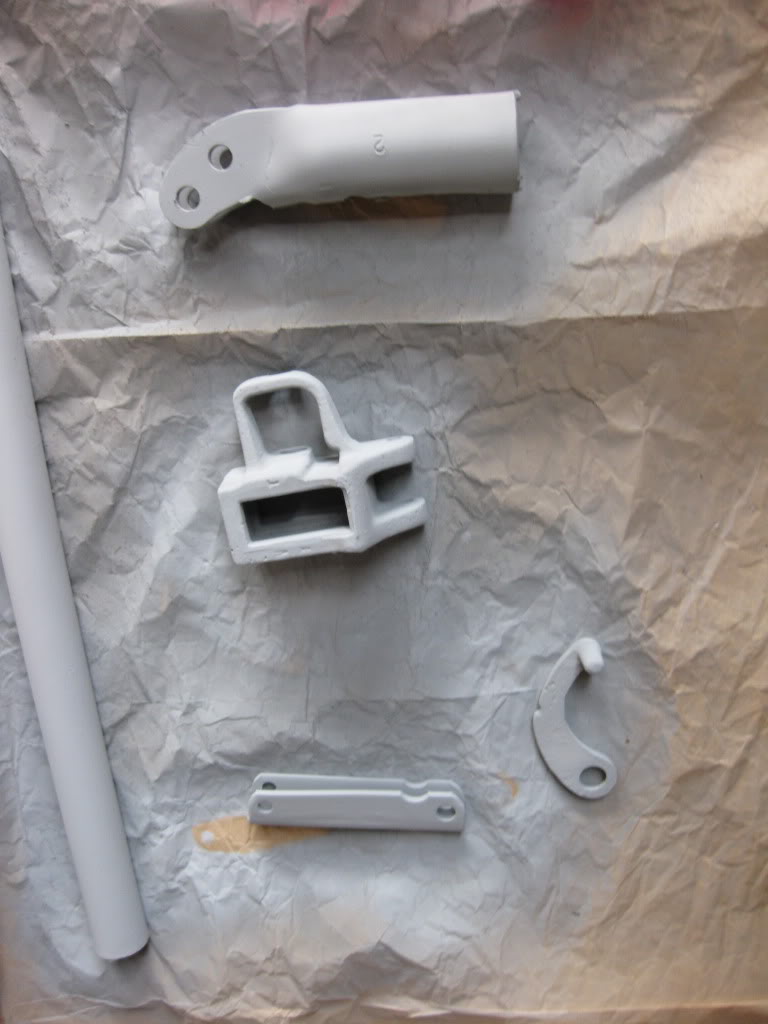

After letting the Naval Jelly work its magic for about 15 minutes, I rinsed all the parts off and let them dry thoroughly. Then it was time for primer. I used Rustoleum Automotive Primer and applied it in 2 light coats about 10-15 minutes apart.

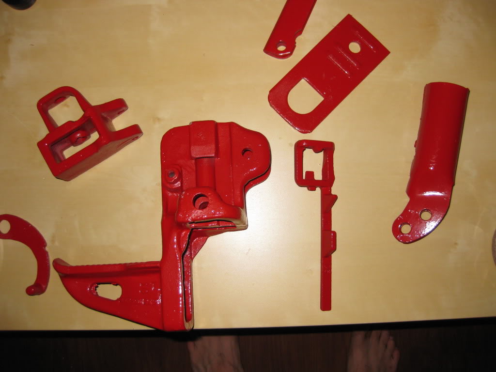

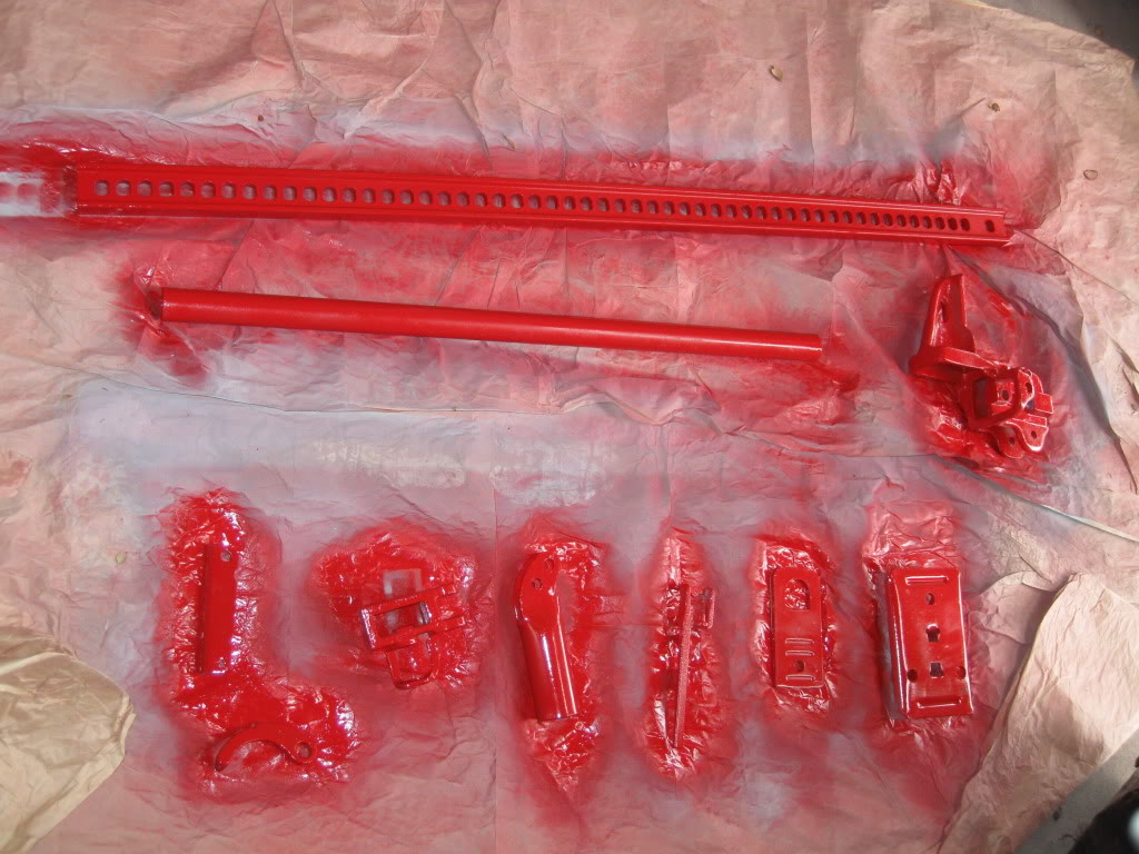

After letting the primer dry overnight, it was time to start painting...I used red Rustoleum Protective Enamel and applied it in 3 light coats
