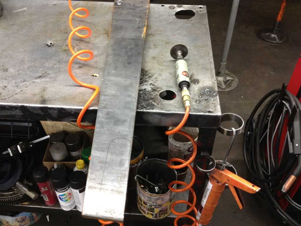

So I'm using some 3/8 steel to make my own shackles . I've used my snap on angle grinder with 3" cutoff wheel to cut 3/8 before and it worked ok , but for smaller projects. I'm looking to cut out 8 shackles 2in wide 7in long. I got a big peice of 3/8 for nothing so I'm gonna use it rather than buying smaller peices to work with. I don't have a plasma , or a band saw. So I'm looking into a better and faster way to rip through this. Any help would be appreciated. Thanks

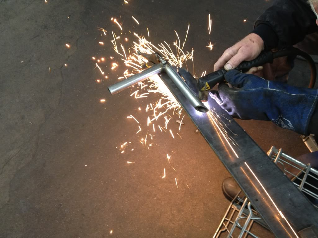

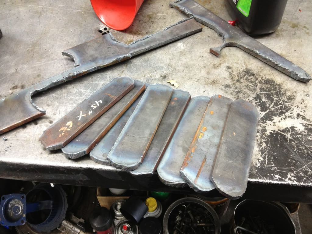

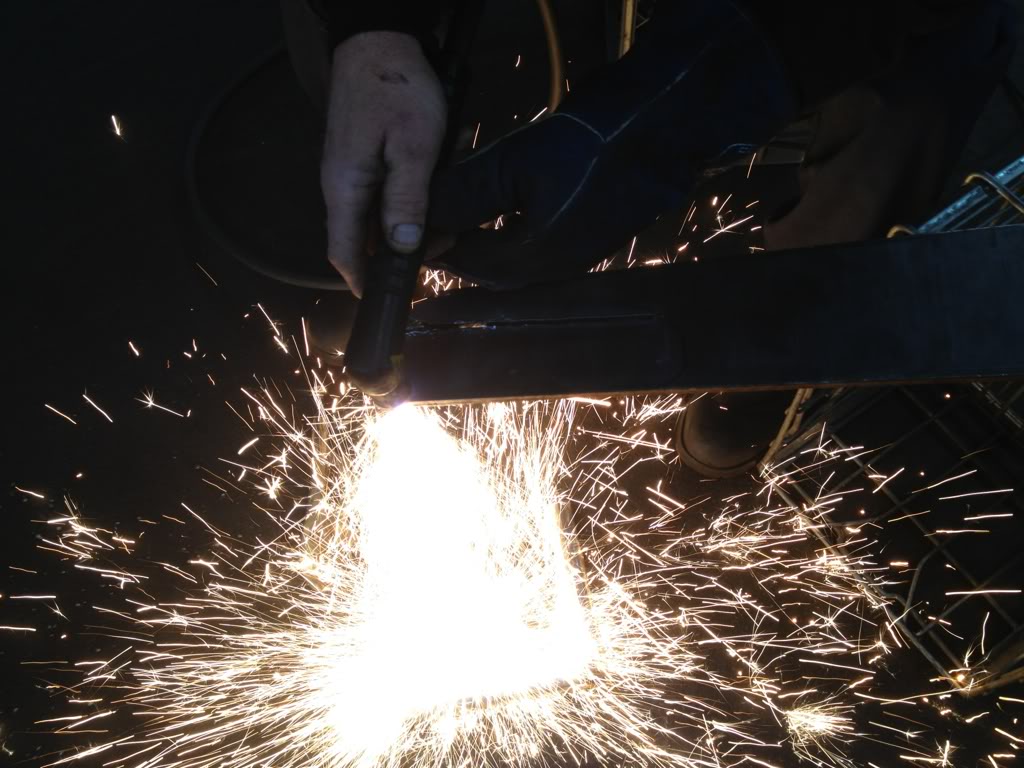

My labor is free , I have a family and other obligations but again my time is free and this build is on the budget side. If I were to pay a shop 40$ or so to cut them out I could have just bought some shackles.
But I did hook up with a guy who let me use his plasma! It was my first time with a plasma , the first cut or 2 was a lil ugly but in the end all 8 shackles were cut out in about 30 min.

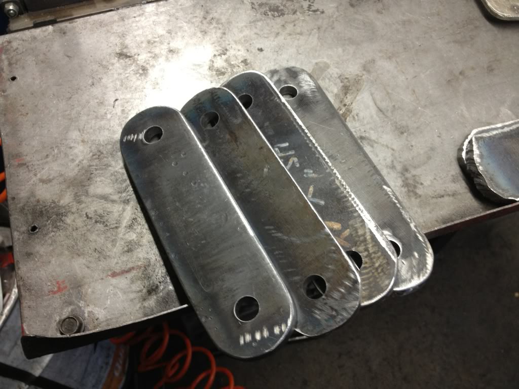

Old Jan 5, 2012 | 06:40 PM
775Toy's Avatar
Joined: Dec 2011
Posts: 415
From: 775 Reno Nevada
Meh, not factory but will work just fine. These were the rear shackles 6in eye to eye x 2in wide 3/8 thick. I'll post pics tomorrow of the 5" eye to eye for the front.

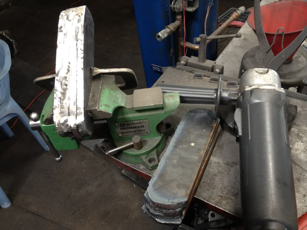

Old Jan 5, 2012 | 07:06 PM
Leviticus6432's Avatar
Joined: Nov 2008
Posts: 302
I like the vise / visegrip setup there... lol either way, looks good man!

Originally Posted by SCToy
haha, never mind you ended up with a plasma. Anyways, next time try using a piece of 1/8th (using a factory edge and clamp it down) for a guide instead of a tube, you can get very smooth cuts that way.
Ya for sure man the Tube was wack. I used a price of angle iron stood up on the last couple cuts. It worked way better than the tube as a guide. It was my first experience with a plasma , it was pretty rad but not as easy as it looks with thick steel. I would had defiantly gone 4.5" cut off wheel if I hadn't found a plasma to borrow.
It actually worked pretty good. I used the vise grips to hold all the plates together while I tried to shape them , and the lil vise to hold them still. The end result is ok, by no means factory but I saved quite a bit of money for a couple hours work. I'm finishing the front shackles tomorrow, I'll post pics of end result.
