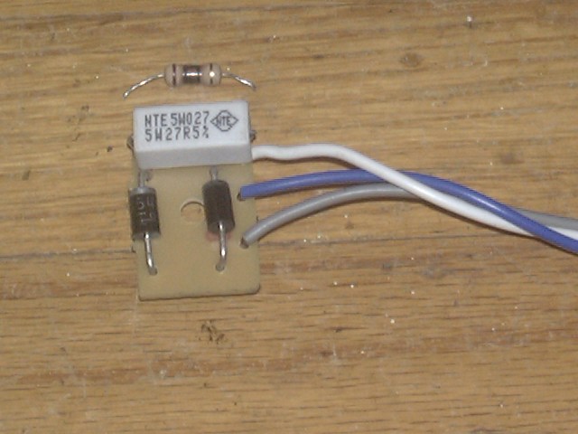

Likely, you need the heavy duty resistor for the black box. Some vehicles seem to pull more current through the high beam indicator/low beam circuit. I have an ungraded resistor in stock now if you want to try it out. All you need to do is replace the existing resistor with the bigger one:
http://www.4crawler.com/4x4/CheapTr...#FineTuningTips
As noted, the upgraded resistor is capable of sustaining a short circuit across the high beam indicator/low beam circuit without overheating. Apparently in some of the newer vehicles, there is some additional load on that circuit that overloads the existing resistor beyond it's design limits. The upgraded resistor makes the circuit self-protecting as it limits the potential current in that circuit to safe levels. This high beam indicator circuit is a quirk of Toyota's design, they saved one wire by sharing the low beam power wire with the high beam indicator light. But it causes all sorts of issues with upgrading the headlight wiring, since you have a circuit where current needs to flow both directions at alternate times.
Here is a picture of the upgraded resistor box (old resistor above for comparison):
The larger resistor limits the maximum current to approx. 400 mA (with a short circuit across the power and ground leads) and the diodes are rated at 3 amps (3000 mA) so the whole unit is able to handle any condition that can be applied to it, at least in a 12 volt system.
