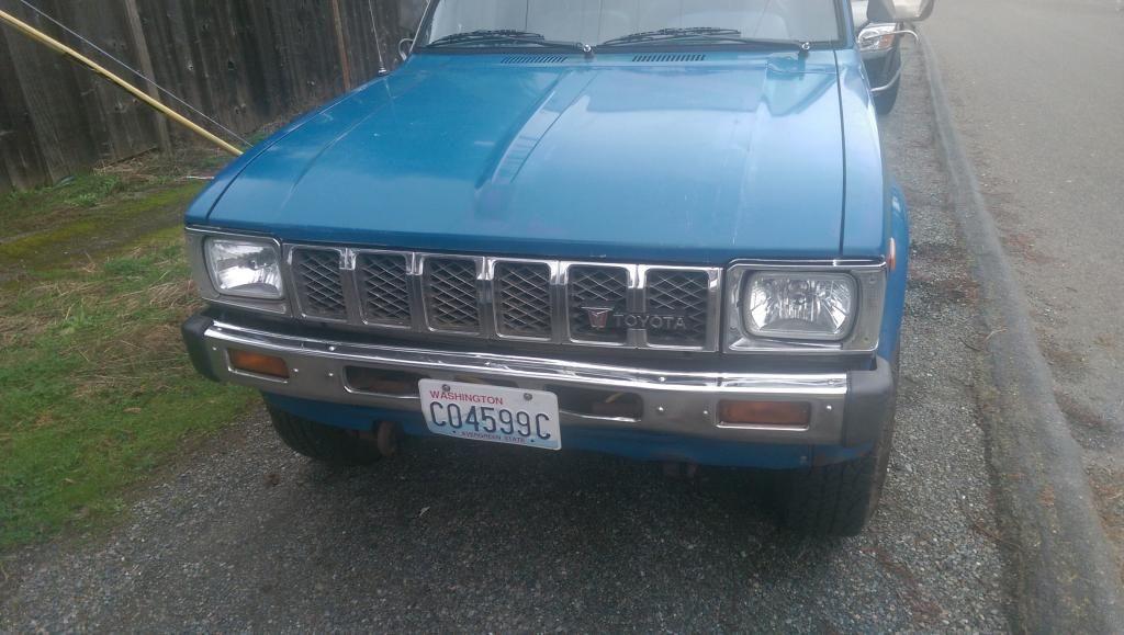

Hi guys,
I bought the Rampage h4 conversion lenses for about 90 bucks. These lenses work in any standard rectangle headlight application, 82 and up.
They bolt right in easy, and are well made of glass and aluminum. Had them in for a month of street use and have had zero quality issues.
The reason I wanted to put this up is that these lenses have a pretty lame beam pattern. While the construction quality is there, the reflector isn't. They're an inexpensive way to beef-up your headlights, but they tend to be rather spotty on the low beam. It isn't a nice flood patern. It works for me because the Sylvannia bulbs are very bright, but if they weren't it would be crippling.
The high beam is usable. It throws well and has a decent flood, but there are all kinds of artifacts and reflections in odd places in the beam pattern.
I would suggest another conversion lense if you are in the market.

I have been using the Putco wiring harness myself. Honestly, if I had to do it again I would make my own harness because it's simple to do. The Putco is a good harness so far, packed with dielectric grease, mounted away from potential water sources and the headlights are brighter.
The best part is that if the harness goes bad all of the old wiring just plops back in.
