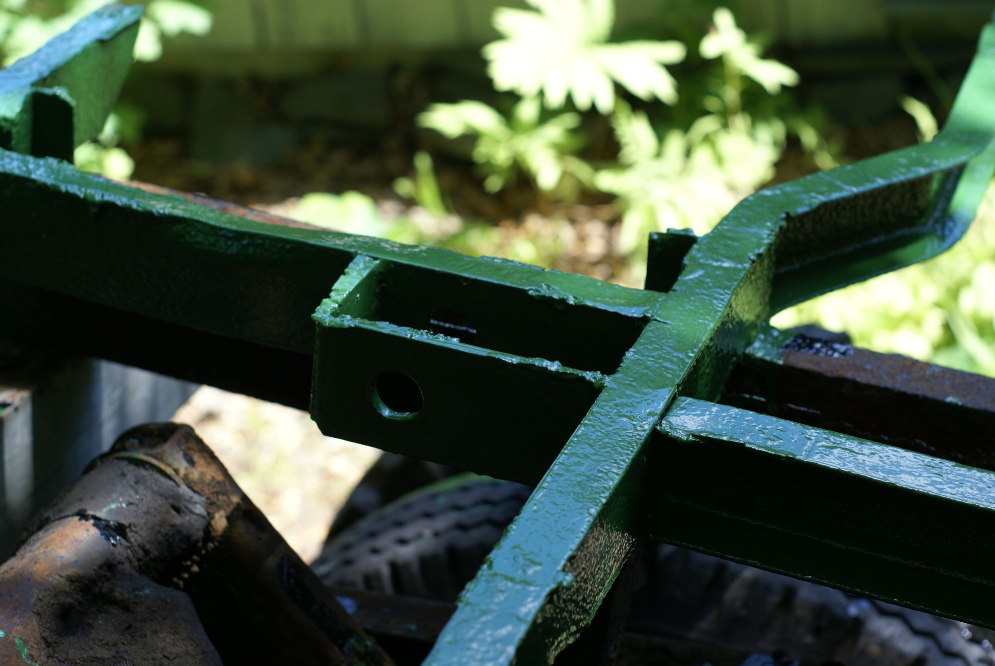

Very happy. Glad I found this topic in a search about chassis saver. I only bought one quart of preventative coating, one quart of por 15 metal prep, so I did not get hit to badly($'s). Plus, the auto parts store I have been doing business for years only carries por 15. I left the auto parts store and it dawned on me that I am only painting a rack body frame, it did not really matter if it matches the cab, as long as it is green-so I went to tractor supply and bought some $29 a gallon Oliver Green. I have been racking my brain for a year trying to find a shade of green that I am picturing in my mind-looked at every green car you could imagine, paint charts, even looked at paint chips at home depot for household paints and I could not find the color I like. Guess what. The color I have been wishing to find for a year is Oliver Green. Very happy. Seems like a great product, glad I read the warnings of this topic.
