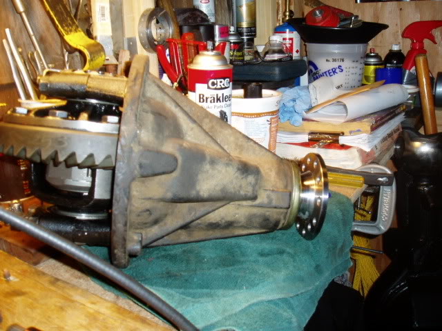

It is installed. Mike at Mikes Specialty Repair installed my Aussie today MSR on Yotatech. Mike was nice enough to let me watch the install. I have to say.. it was fascinating to say the least. Mike was extremely meticulous and tenacious about the install.
It was raining way to hard for me to put it back in the truck when I got home so I will do it in the morning.
Thanks Mike for everything!!
I posted the two most beautiful things in the world hahaha
Christy Turlington
and tucked away within that pile of metal is the elusive (NEW) 4.88 gearing with an AUSSIE LOCKER!!

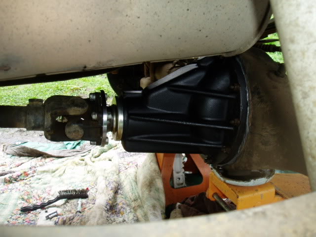

1st thing this morning I took my truck out for a test drive with the new Aussie and the new 4.88's. I live down a muddy semi steep driveway. I normally have a little trouble backing out of the driveway but not now. The truck instantly grabbed and backing out was like never before. I drove the truck up to the market to get the diff oil moving around. It is pouring rain and hail here and the highway is VERY dangerous. I did notice a slight pull to the left when accelerating. I also noticed the truck to grip better. It felt tighter and more stable (not sure why but it did.)
I have yet to take it up the mountain.
One issue I have is with the speedometer. I have 4.88's with the Aussie in the rear and an open diff up front. My tire size is 32 10x 50 Super Swamper TSL's. It seems as if I was going much slower than the speedo indicated. I don't recall reading this in the many write ups I have read on re gearing. I have read many articles on tire size and speedo change. I haven't changed anything with the tires and the speedo reading seems different after the gear install. Any input on this would be nice.
As of this morning I feel very positive about the Aussie. My driveway has always been kinda tricky.
