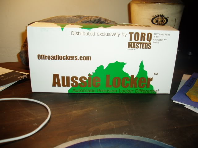

It is here..
Sooooo Matt, you comin over to install this thing?? Jk
Should be in and locking by the end of the week!

Originally Posted by toyospearo
It is here..
You get the third member out and I'll put the locker in and reset the BL, I like that part. I'll give you some pointers when I got a minute later.
