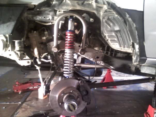

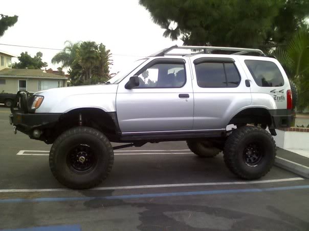

Its owned by a long time friend pretty much my brother. over the last 5 years we have been building it up. we modeled the three link SAS off of all-pros Taco kit. I even think we used there links. a dana 44 up front, with 1 ton steering. it has Fox Coilovers up front at now has 8 pack rears after the 10 pack was to weak and ended up aiding in the rolling of the truck.

this is ride hight on 35's we are planning on doing some trimming and pulling 37" hummvies on it. and my buddy has been in contact with All- pro who may want to start and make a SAS kit for the Xterra and also he may get a proto type Lock right from the engineers at lock right to test in his stock rear Xterra axle
