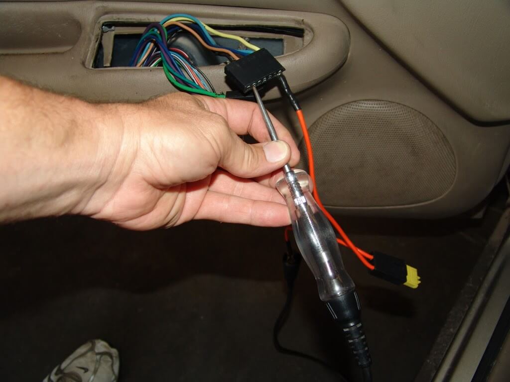

If you cannot lock/unlock the door with the key, but the locks function by pressing the buttons, remove the door panel and inspect the lock actuator mechanism. Replace the actuator if necessary, then test the lock.
If you cannot lock/unlock the door with the remote but the key works, replace the battery in the remote fob. If you cannot lock/unlock the door with the key, the remote, or the lock buttons inside the vehicle, go to Step 3.
On models with power locks, if you can unlock the door with the key but not the remote or inside buttons, check the fuse. You can also remove the switch panel and use a test light to check for voltage at the switches. If there is no voltage, there may be a break in the wiring.
