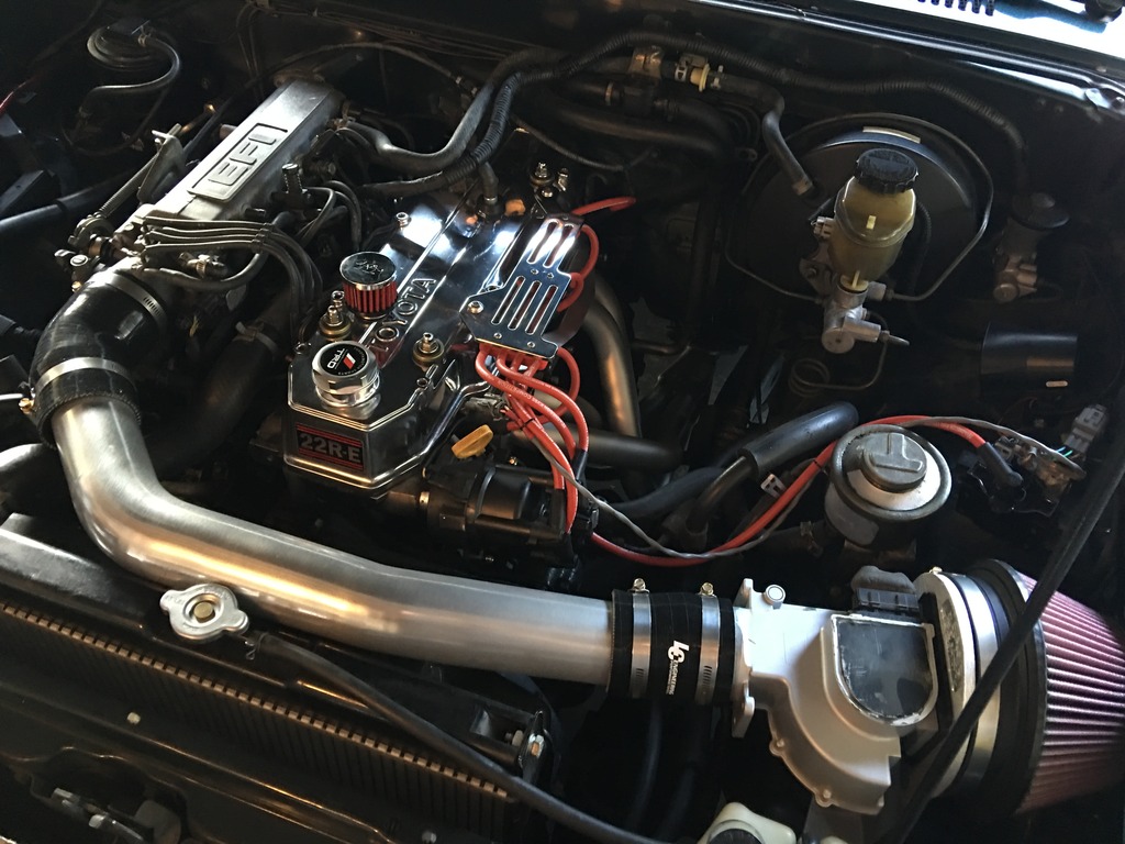

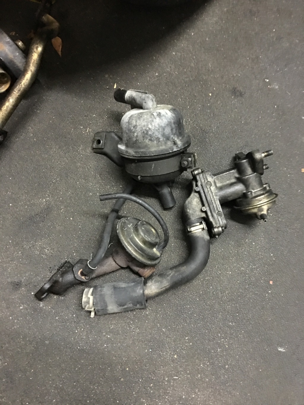

You only need 1045014, 1032000, 1016009 to delete the egr (there is a kit) everything else is optional.
