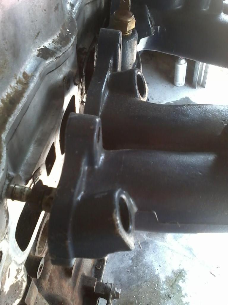

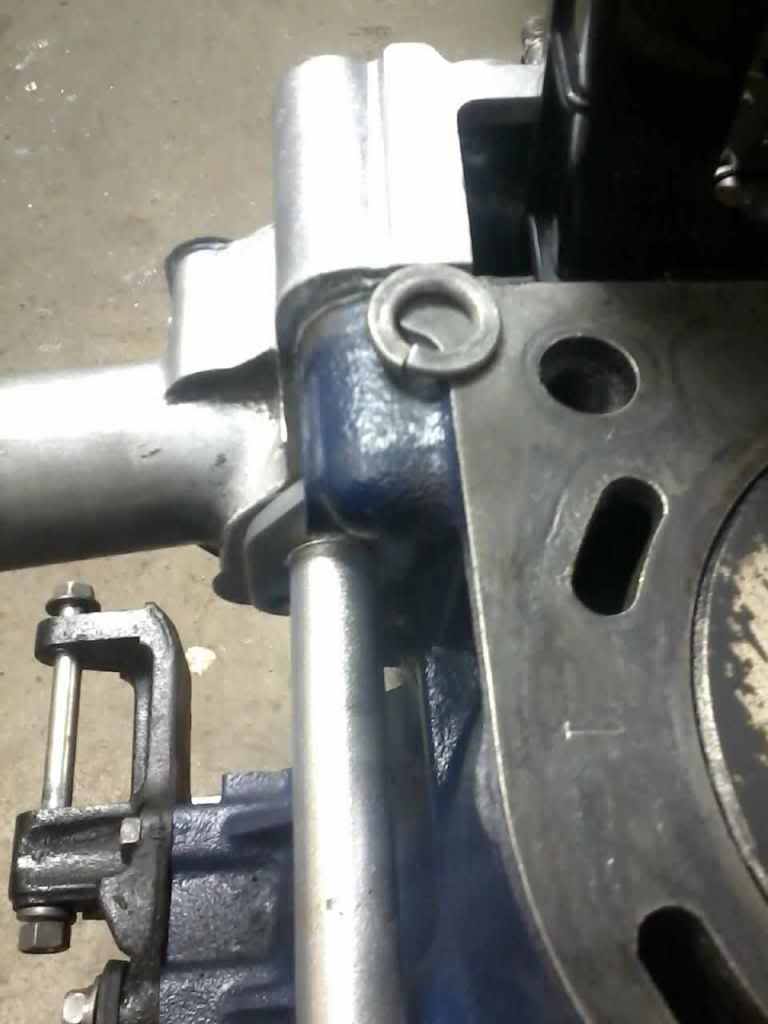

Below is the pictures of my experience of trying to convert the early style block to EFI. The bottom two pictures I am trying to show how the intake bolt holes don't match to the head and the intake bolt holes are different from each other as well. I read that you could convert an older block and with a lot of machine work it might be possible but from what I tried to do, it was not possible, and really not sure what would happen even if I had the bolt holes machined in the head on how the injectors would line up and if the head would accept them.

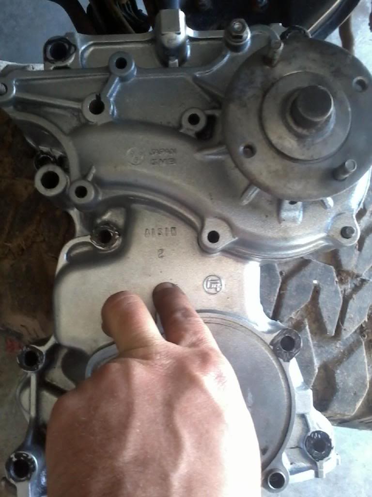

I got my Timing Chain on and had to replace the Timing Cover due to it being worn. I tried to use a early model 22r and they wont interchange. Thought I would put some info up to help others identify what they may have.
84 and older. 22r has no dimples/circles and the number "2" on it. Twistedyota got it right on the height thing, see the last picture for a good example. I also tried to mark which bolt holes for removing the timing cover on down the road when I have to do a chain again. Hope it wont burn off but it if does I tried to come up with an easier way. Never can remember which bolts they are.

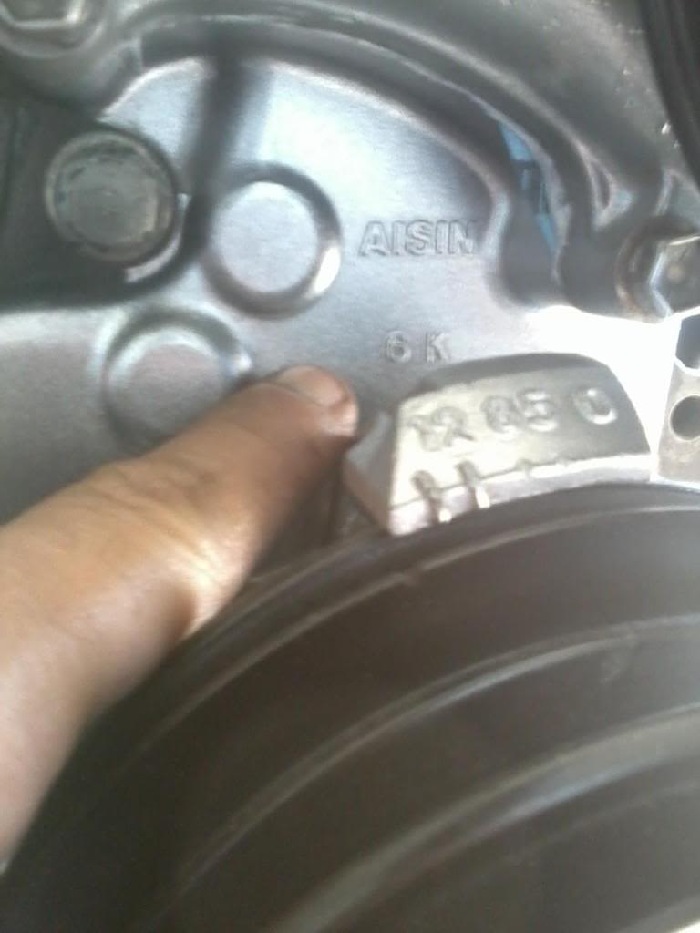

22re has "6k" and dimples/circles. 85 and up.

Here is what I am talking about on the 1/8th inch height. I used a lockwasher to help show how much of a difference. This cover is 22r. Seems like the oil pump bolts were to short. Hope this will save some one some trouble. It is an early model 22r timing cover on a newer 22re block.

Here is a intake manifold that I used for my 86 Runner and something wasn't right on it and had to use another. The first stud up by the fuel pump lines up but nearly all of the rest don't as you get further to the back of the motor.
