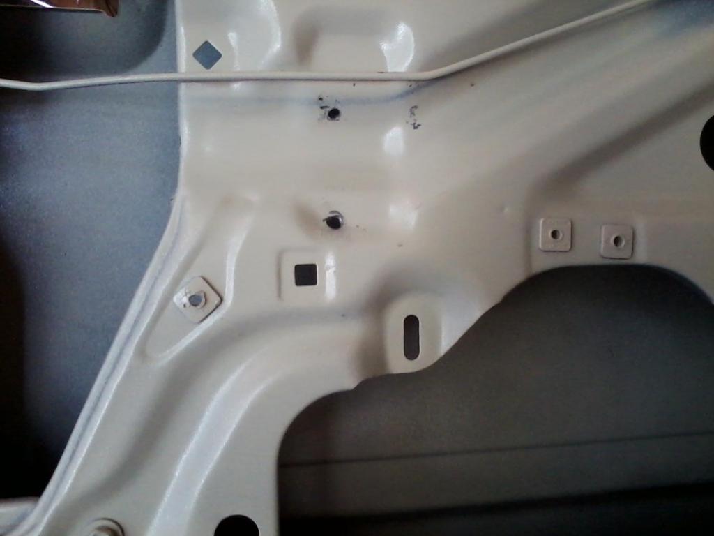

This is my passenger door and it does open like it should from the inside. The drivers side does not. I was comparing the two trying to figure out why the passenger did and not the driver. I then seen this little foam. It helps hold the rod into the valley impressed in the door and that little bit makes the door open.
Here is the valley with the door handle pulled to open it and you can see where it is out of the valley.
Not the best fix in the world but is a better system then what Toyota did and it is working great now. I drilled two holes and used a ziptie. I will see if it is going to interfere when I stick my windows back in and let you know if this will work. Either way it will be a similar fix if it does interfere unless someone has a better idea on to do it.
A friend of mine and me have seen this issue several times and surprisingly I dont ever see this pop up on Yotatech or even seen a thread on it.
High Tech door fix.
