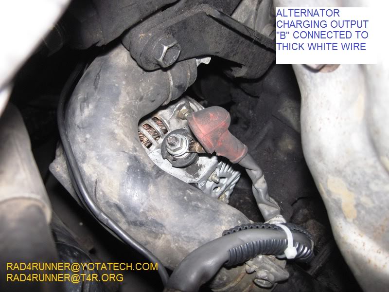

Gotta check your schematic. Look for where the alternator "B" output (thick wire) connects to battery. It's usually among/in between the fusible link and fuses.
"B" Charging output of alternator:

"B" is charging output. Thick wire, Connect to battery among/in between fusible link and main fuses.

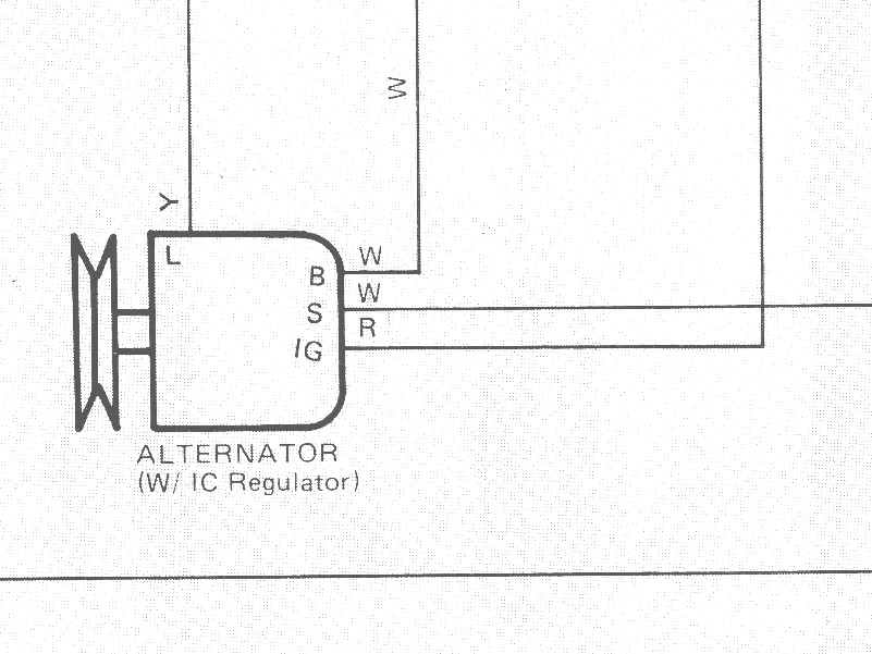

this is the wiring diagram for the alternator hope the link works

No schematic? Need schematic that shows how Alt ("L" output) connects to charge light circuit.

Uploaded with ImageShack.us
Old Mar 30, 2013 | 10:41 AM
cccp's Avatar
Joined: Jan 2005
Posts: 266
From: Summit County Colorado
keep in mind that my connector is different because of a different alternator but the wire colors are the same or at least i think so got to to double check that

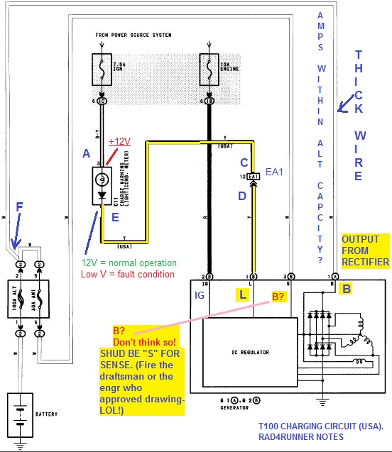

Old Mar 30, 2013 | 02:18 PM
RAD4Runner's Avatar
Joined: Mar 2012
Posts: 7,125
Likes: 681
Happy Easter!
Now we're talking
Please see my notes...
Here are important points to check:
With ignition off, F should be 11.92V
Disconnect connector EA1.
Leave EA1 disconnected. Ignition on, engine running:
With EA1 disconnected, charge light should be off.
If charge light stays on with EA1 disconnected, check Voltage at "E" or "C". Should be high or 12V. If low:
  • Look for shorts to ground.
  • Makes sure nothing is connected to negative side of charge light-diode circuit.
  • Check for any after-market wiring connected to negative side of bulb-diode circuit (eqpt that only come on when IGN is on like DRL).
  • IF Canadian model, also disconnect connection from dDRL circuit to isolate problem.
1) Measure current through thick white output wire (B) with clamp-on ammeter (Harbor Freight is your friend ) Should be within capacity of alternator.
2) Measure volt @ F. Should be between 13.5 & 14.5V.
Measure "D" = "L" output:
  • If 1&2 good, D should be 12V. Reconnect EA1. Charge light should stay OFF.
  • If If 1&2 good but D is low, IC/regulator bad. Replace alternator.
If 1 good, but 2 bad, = bad regulator/alternator.
If 2 exceeds alt capacity- check for shorts, possibly bad battery...
More details if you wanna to analyze ...
Normal operation condition:
A: 12V nominal when ignition on.
B: ALT output 13.5 to 14.5 V
E (=voltage "L") = 12V when ignition on
Volt@A - volt@E = 0 =>> no potential difference across charge light & diode =>> charge light OFF.
F = batt voltage: 11.92 With ignition OFF. 13.5-14.5 V with charging circuit running normally.
IG: (supplies current to stator to regulate output): 12V nominal when ignition on
S (sense voltage: feedsback abbt V to regulatr so regulator cna adjust.
( I think schematic is poorly labeled. The "B" pin connected to regulator should be "S" for sensing battery voltage as feedback to regulator.
Fault Condition:
E: low, approx 2V? 1.1V?
Volt@A - volt@E =/~ 10V = Potential diff across charge light & diode => current flows => light ON

and i do believe that is an S on the wiring diagram just smudged up or something
