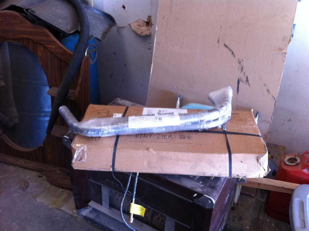

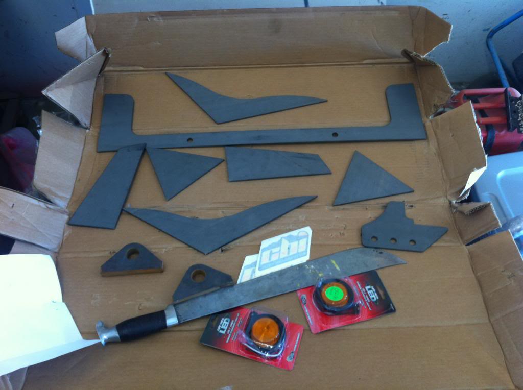

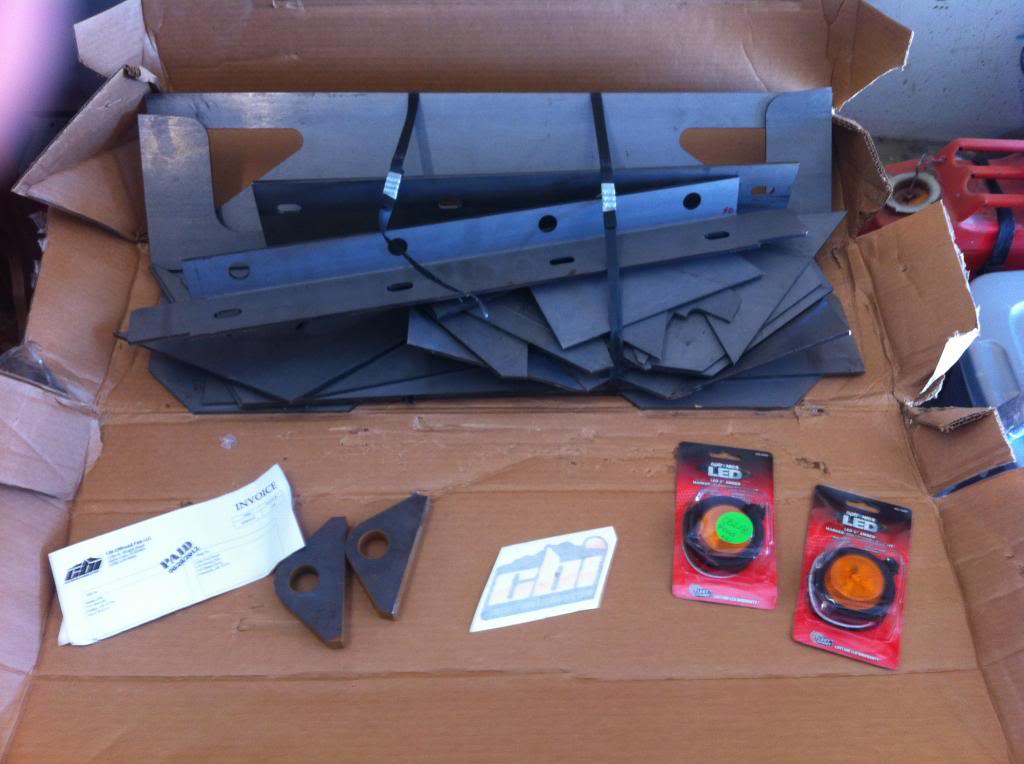

WELL!!! I am excited to receive my brand new DIY front bumper from CBI offroad, it is their new bumper that was designed for the 2nd Gen 4runner, for those of you that have looked at them and wondered if they have one for the 2nd gen, then your in luck, they just finished it not long ago, its still not on their website but should be soon!
I am going to build it and take pictures of the progress as it happens, I"ll post pictures of the package now, and maybe this weekend i'll start welding it together!
No the machete did not come with it

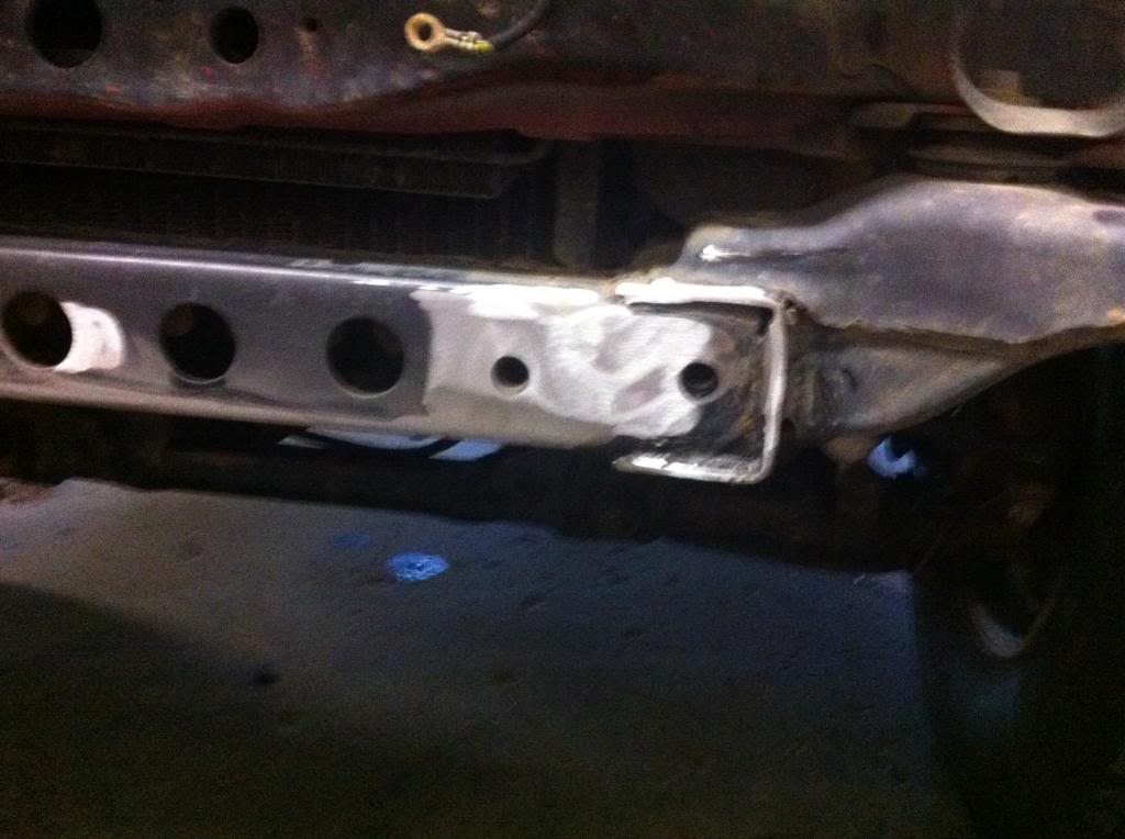

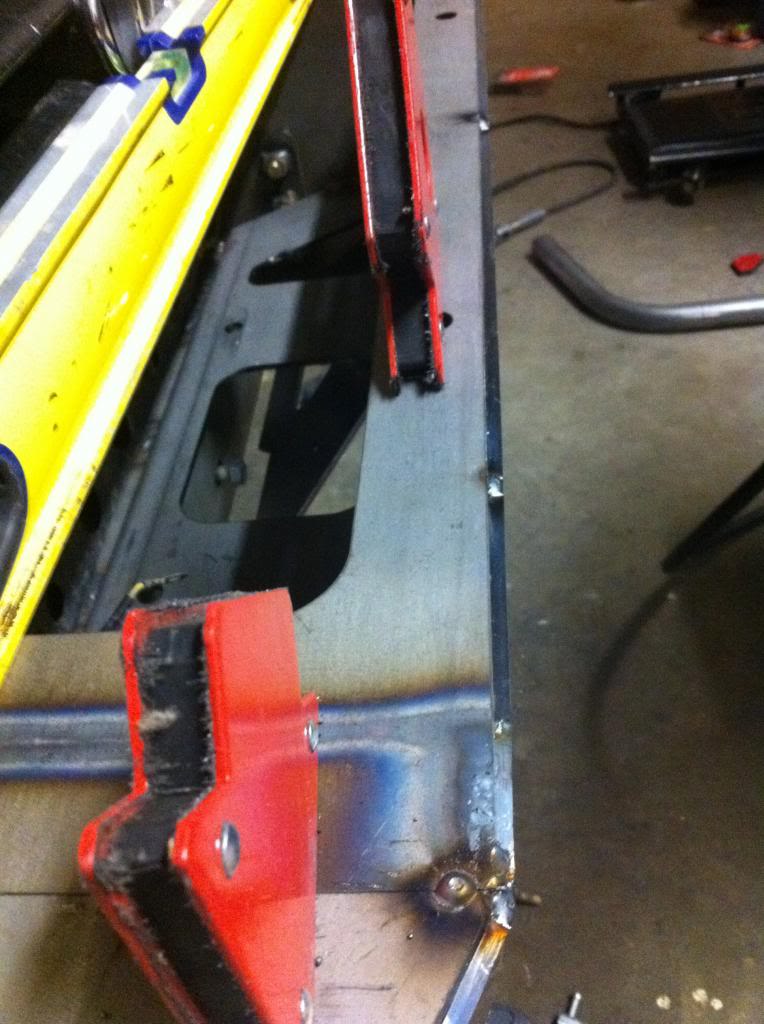

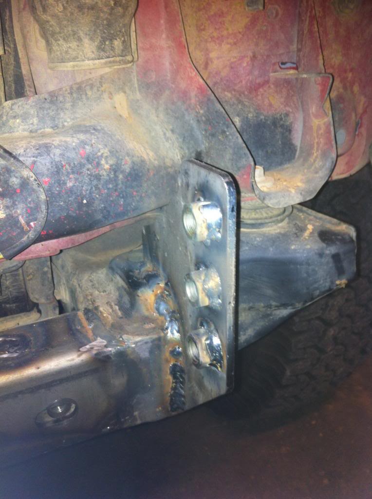

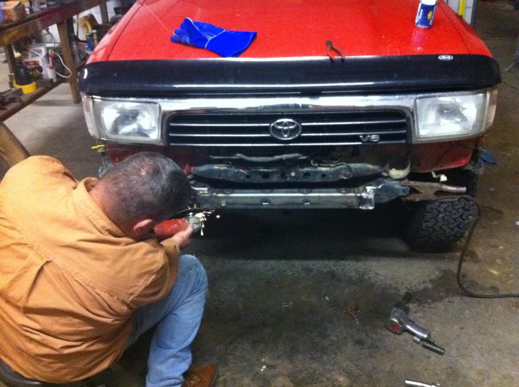

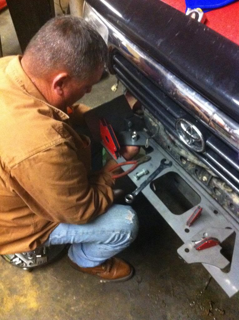

With the bumper off, I ground down the areas that the mounting bracket will be welded too.

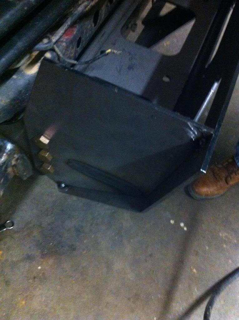

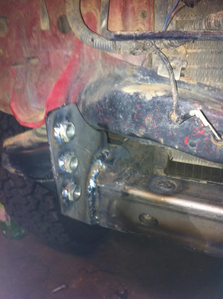

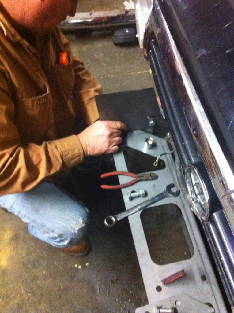

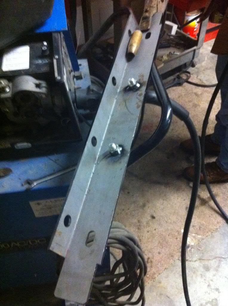

this is the mounting bracket, which we welded two nuts to so that I can bolt the bumper up, there are two existing nuts on the frame on the outside that we used the stock bolts that came with my stock bumper to hold the mounting plate to.

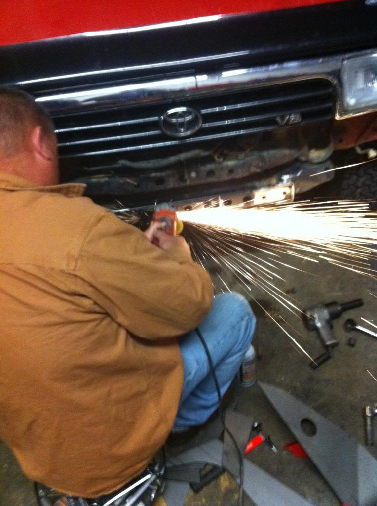

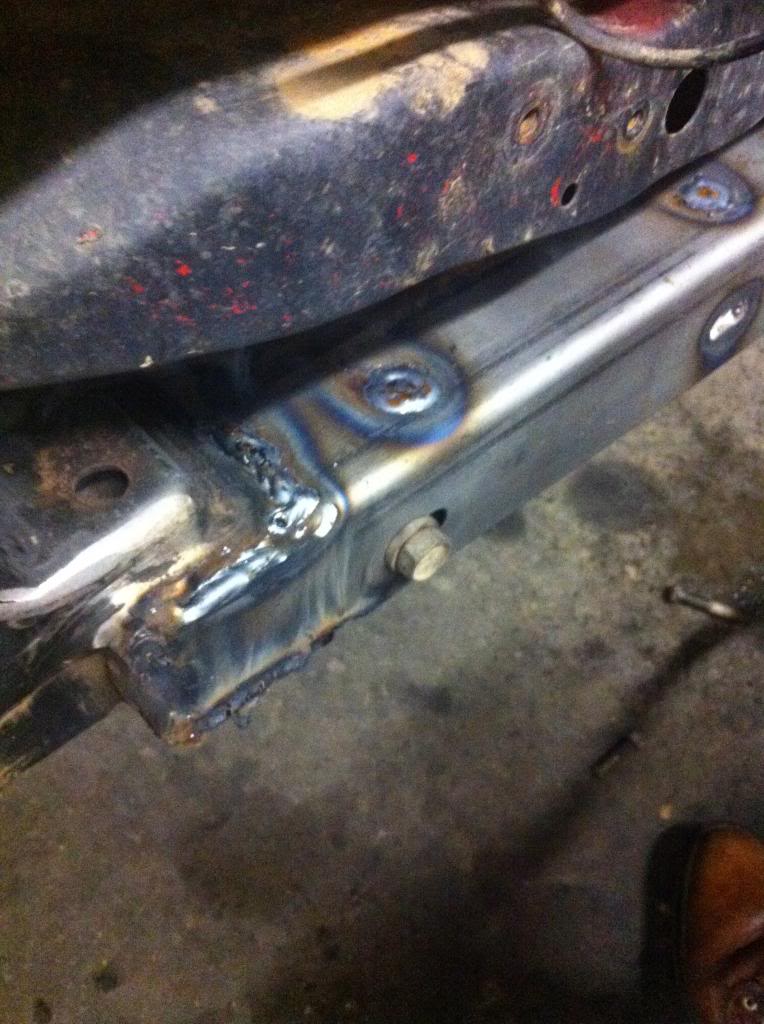

We had to cut the front frame to allow for the nuts that we welded on the back to sit inside the frame so that the bracket would sit flush.
after welding the bracket to the frame we ground down the welds so that everything else would sit flush with the bracket.

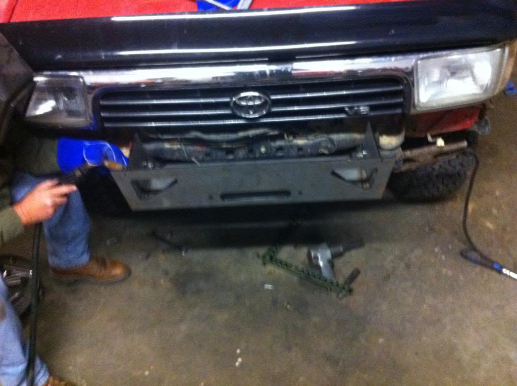

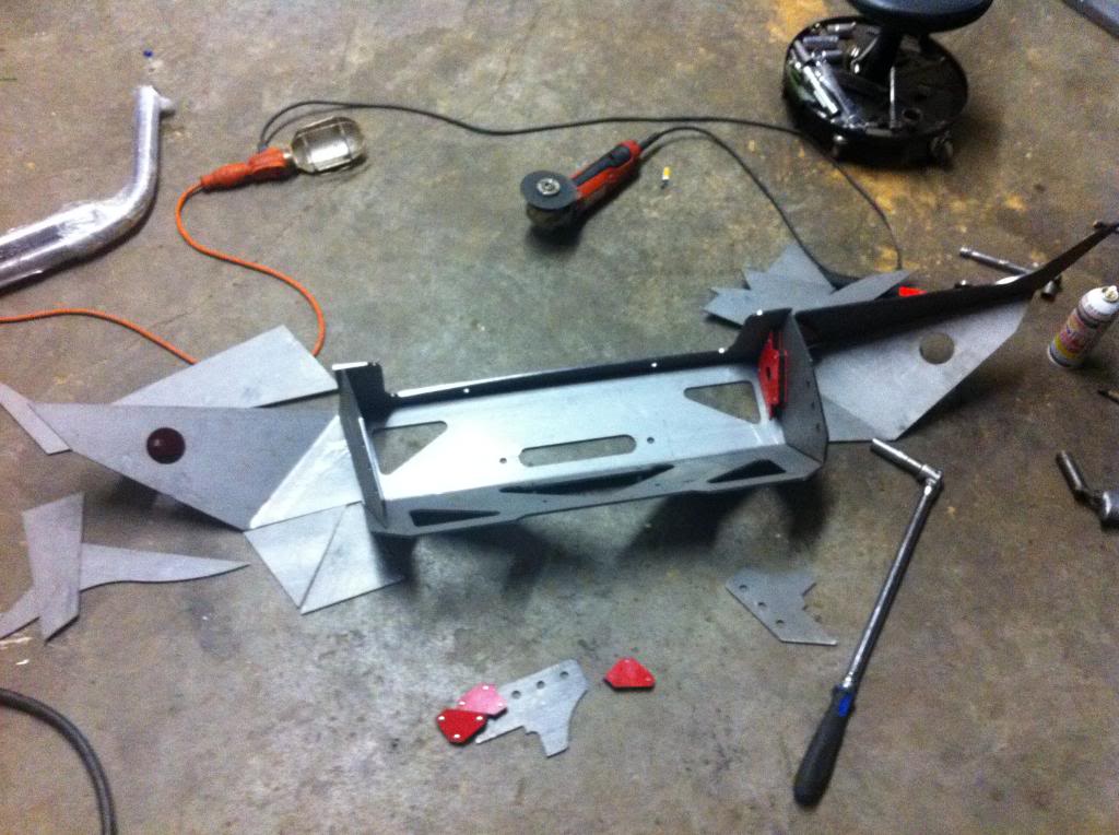

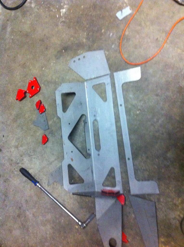

I sat everything out to get a visual of what was going to be the bumper

THere were some holes drilled through the mounting plate that we welded to help give strength to the top side of the mounting plate, My only guess as to why they were there.

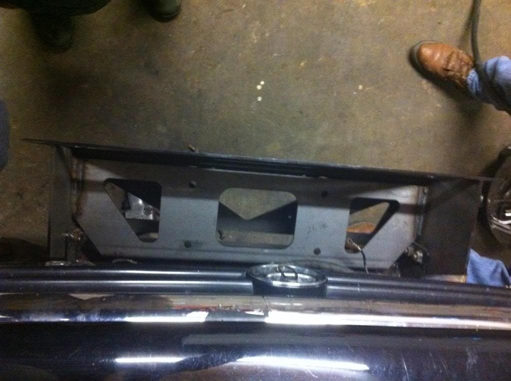

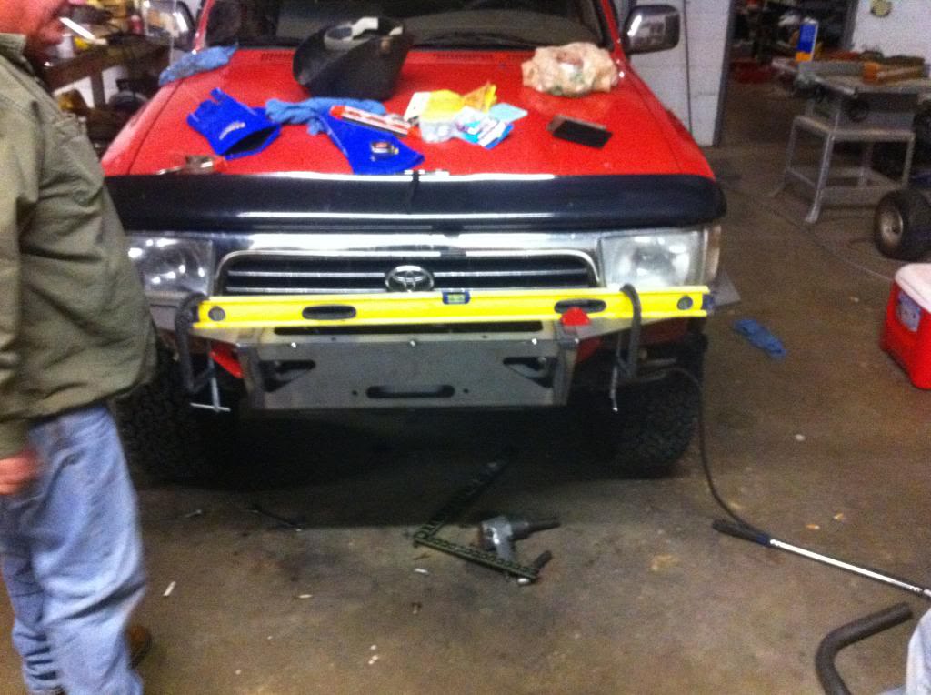

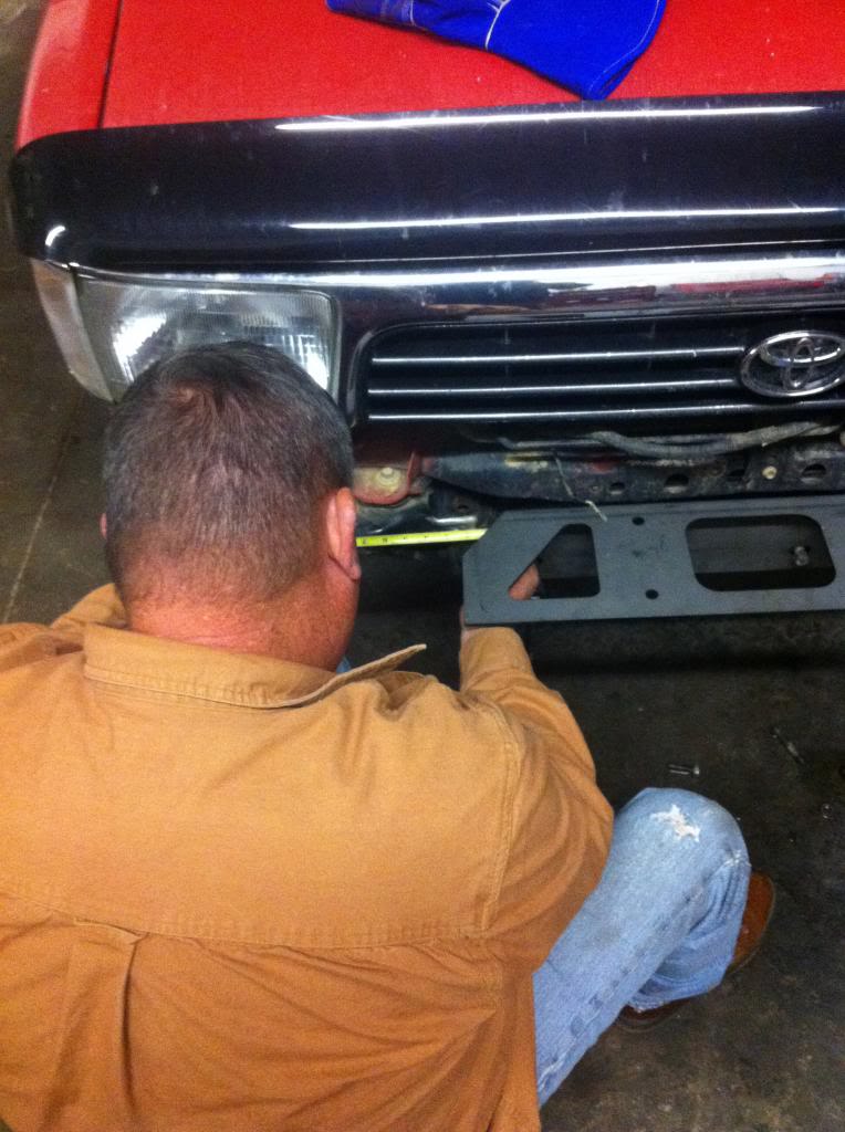

Bolted on the winch plate and then took measurements to get it in the middle
We then mounted the two side peices and bolted them together to see how the side mount and the welded side of the bumper would line up.

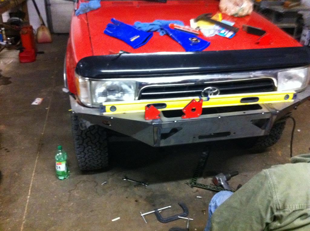

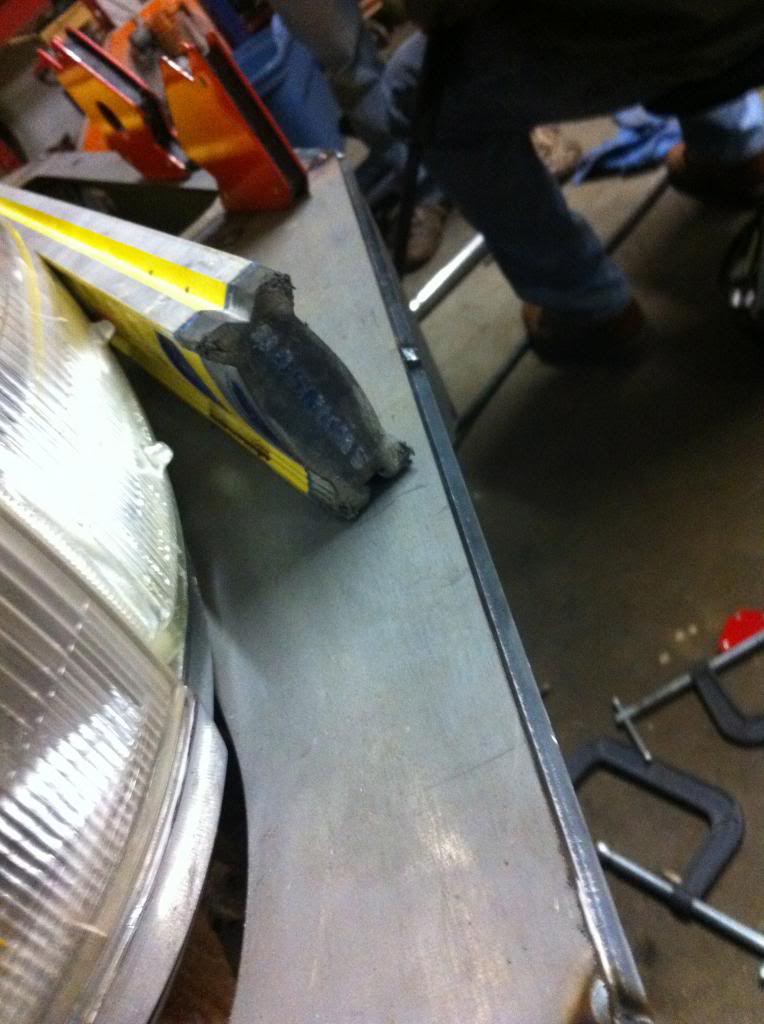

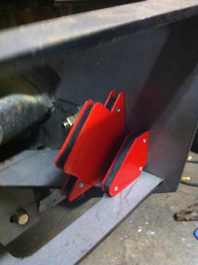

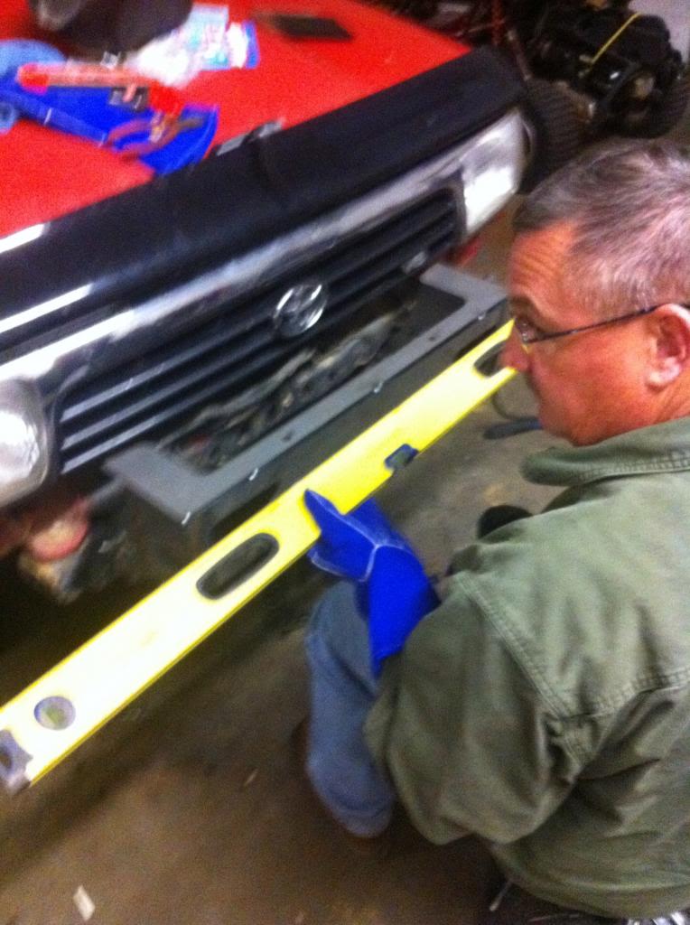

After getting the new bolts, we attached the frame brackets with the bumper bracket and set it up to get measurements and to check its level
(Note: the bolts in this picture, we ended up turning them around, because we decided it was hard enough to get the bumper on and off so we ended up welding up the nuts so that way you didn't have to hold the nut, bolt and bumper while attaching it.)

After we got everything level, we welded the frame brackets up.

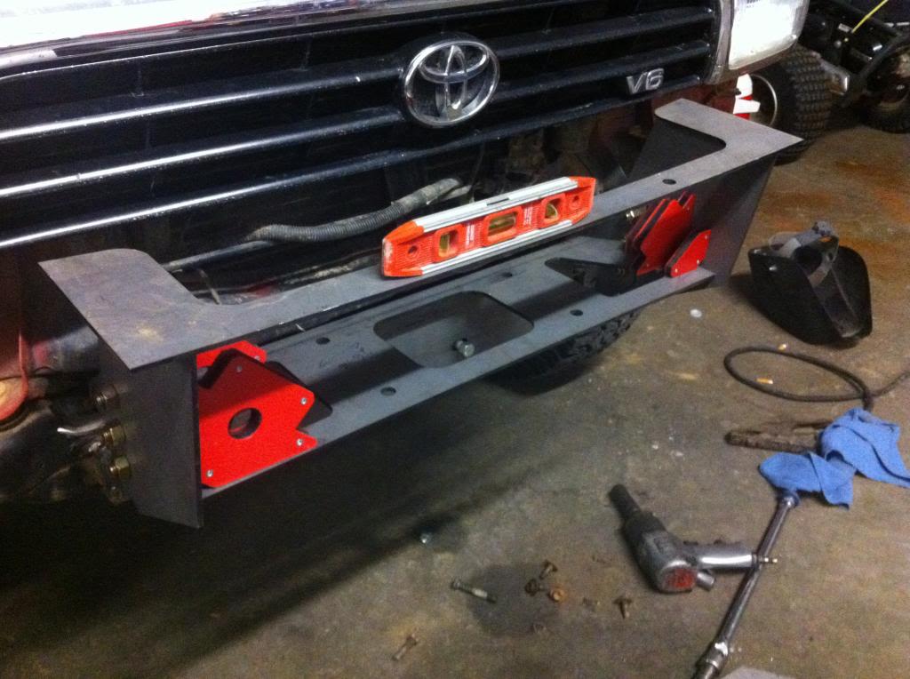

with the brackets welded on, we went with the next piece, which is the winch plate. This was kind of hard, we had to do it twice, we ended up just having someone hold the plate while we tacked it into place.

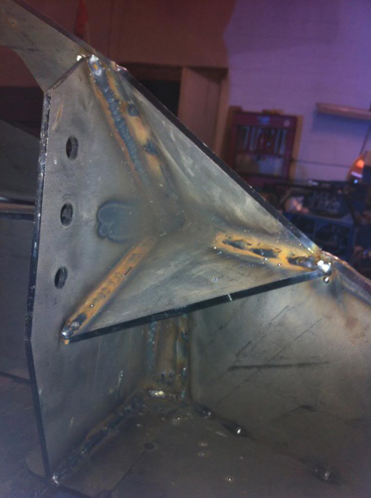

Next we added the top plate, which the sides get tacked to.
With this tacked up, we added the top plates for the sides.

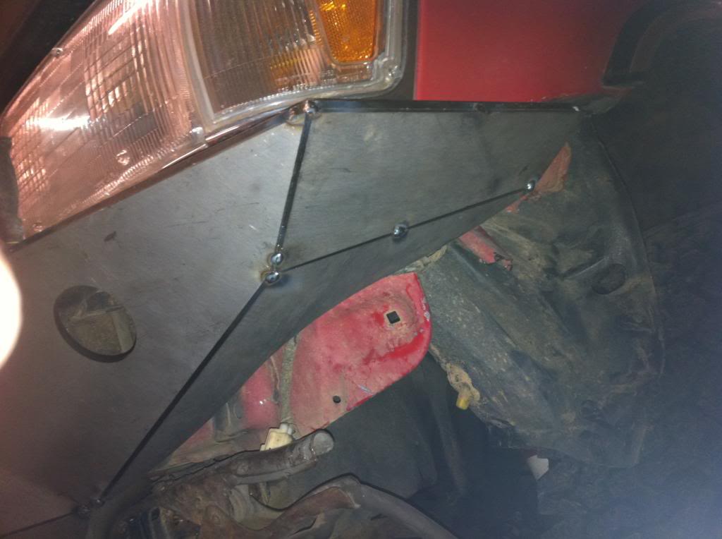

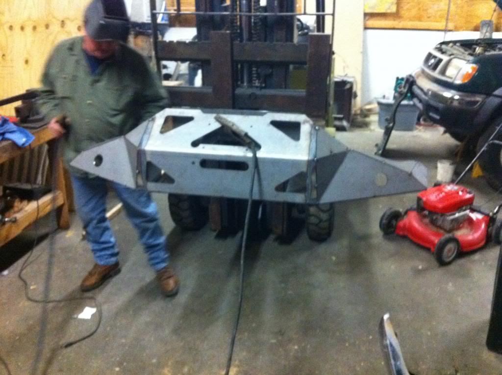

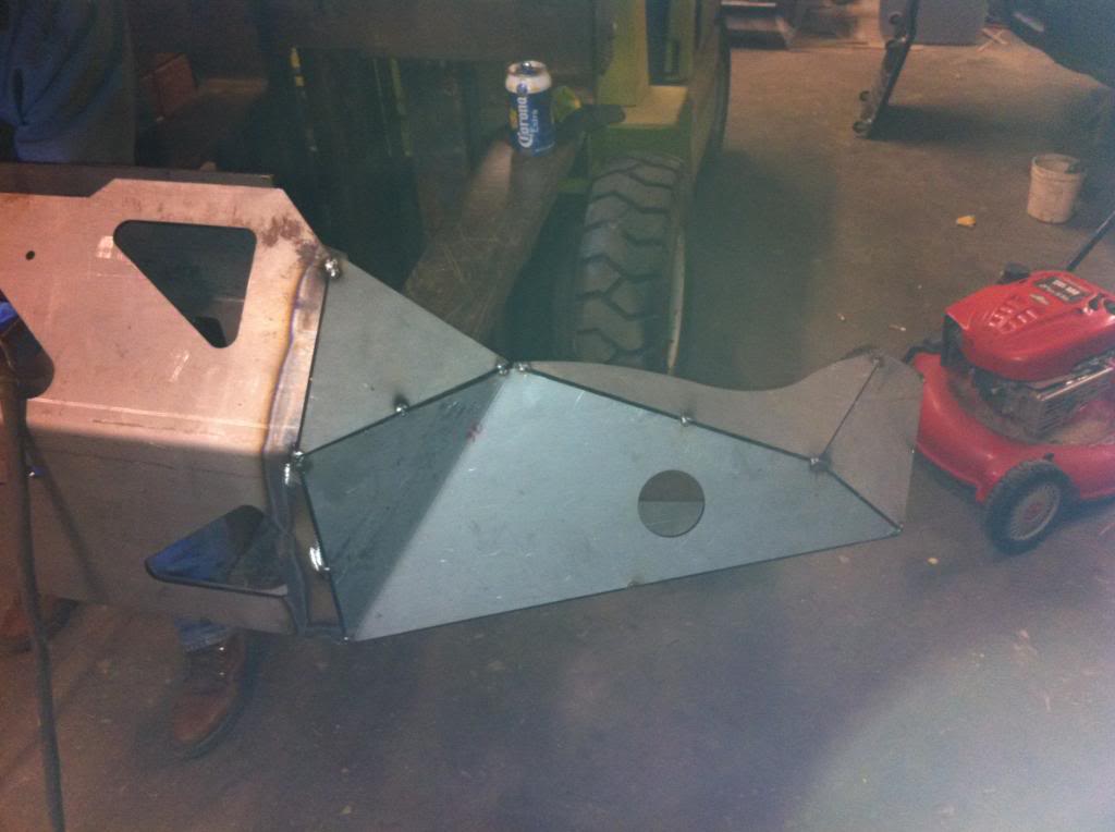

With the top plates on all they way, we decided to attach the two front plates, that have the holes cut out for the turn signals. This was as difficult as the winch plate, cause the magnets just wouldn't hold it right, so carefully we held it in place while tacking it flush with the other plates (leaving a edge to hold a bead)

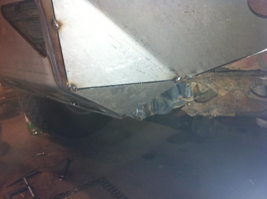

Well I kinda got carried away, with the next two pieces, and didn't get pictures for each one, but I think you get the idea, this really goes together quickly once you got the main structure set up.

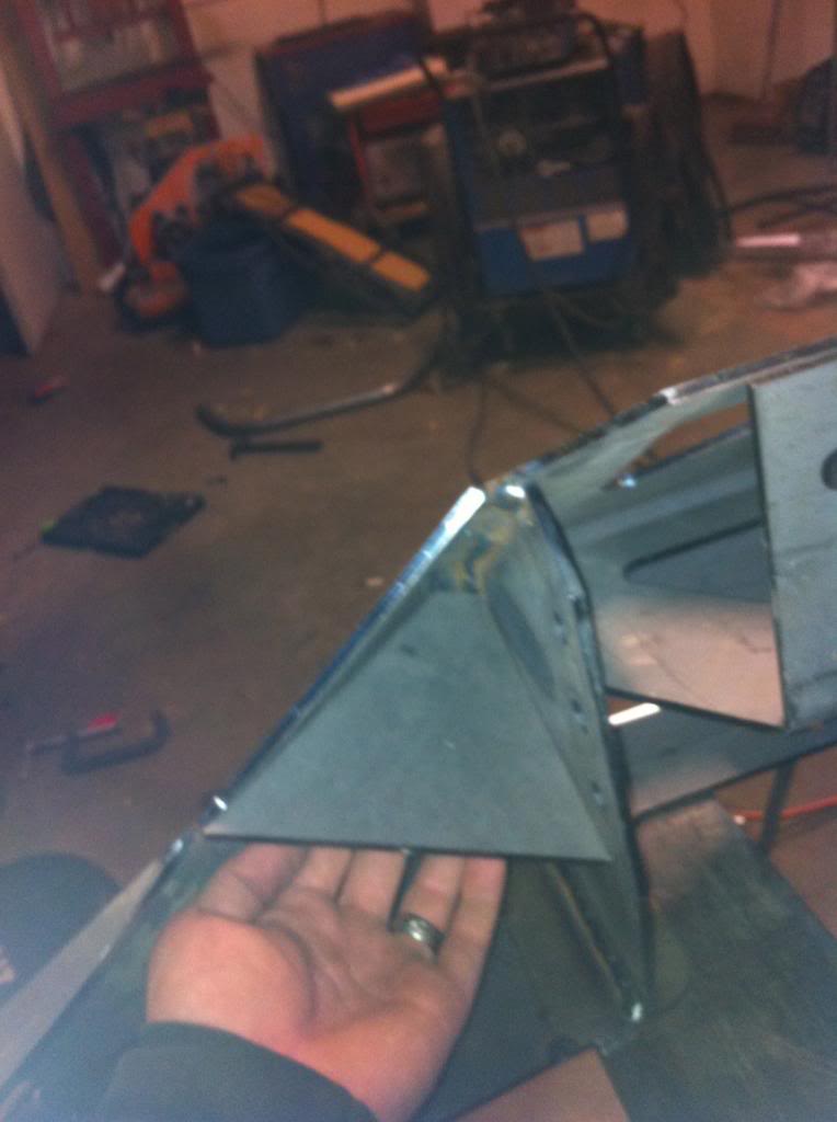

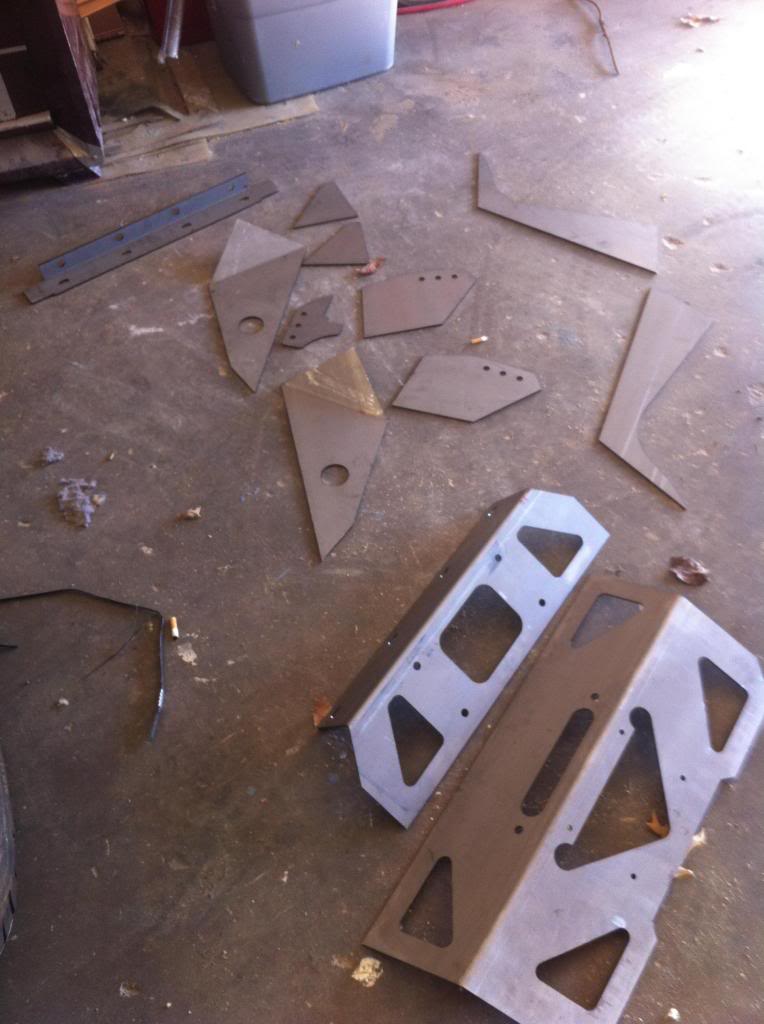

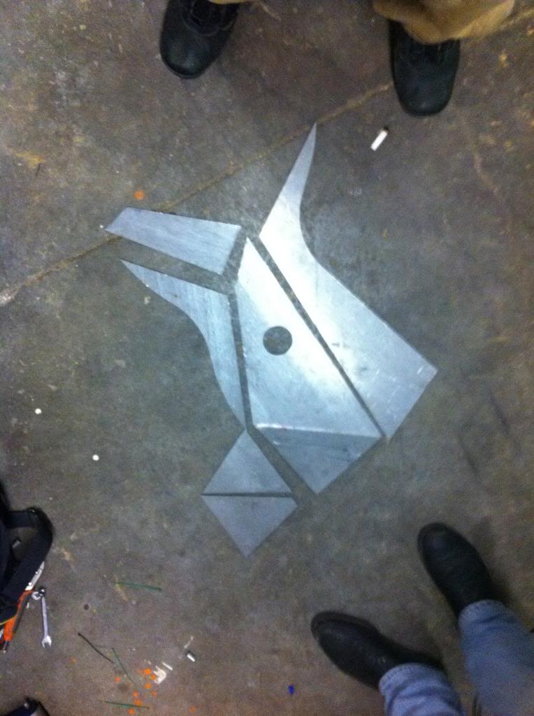

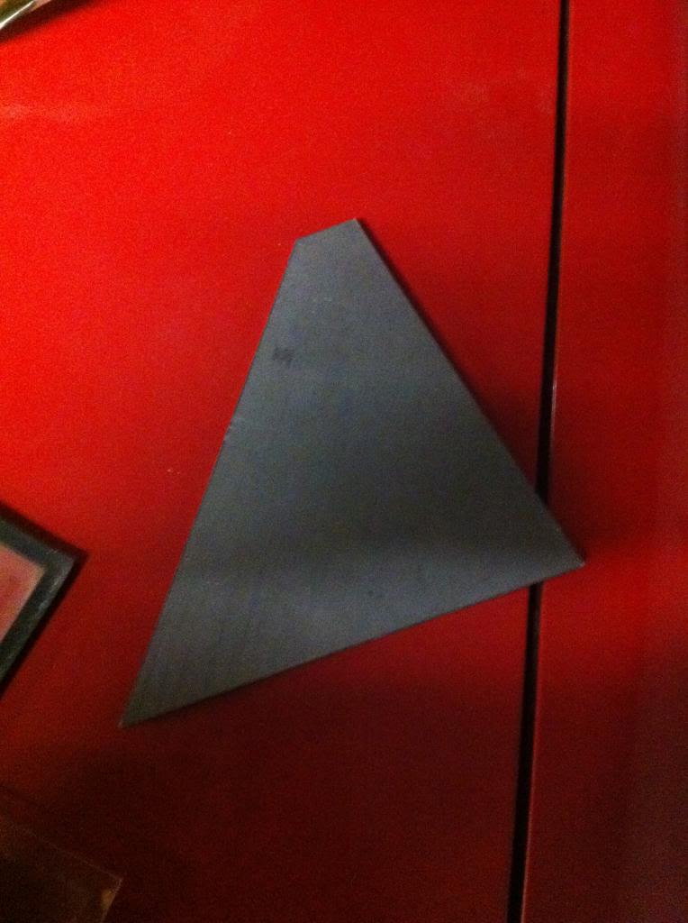

We did run into an extra piece (or so we thought) it came with two pairs of triangle pieces with 1 pair having a flattened tip, so we discarded the flattened tip, because the full triangle fit in here quite nicely

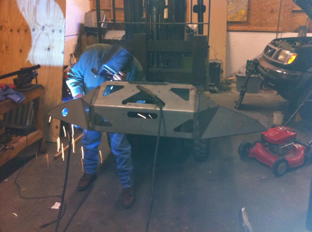

After taking the bumper off to finish the welds where we didn't have to contort ourselves in getting it finished off, it dawned on me that this is where the extra piece went (its there for structural integrity)
Here it is welded in place

Here is another close up of the frame bracket welded up with the nuts welded so you don't have to hold them up there to attach the bumper

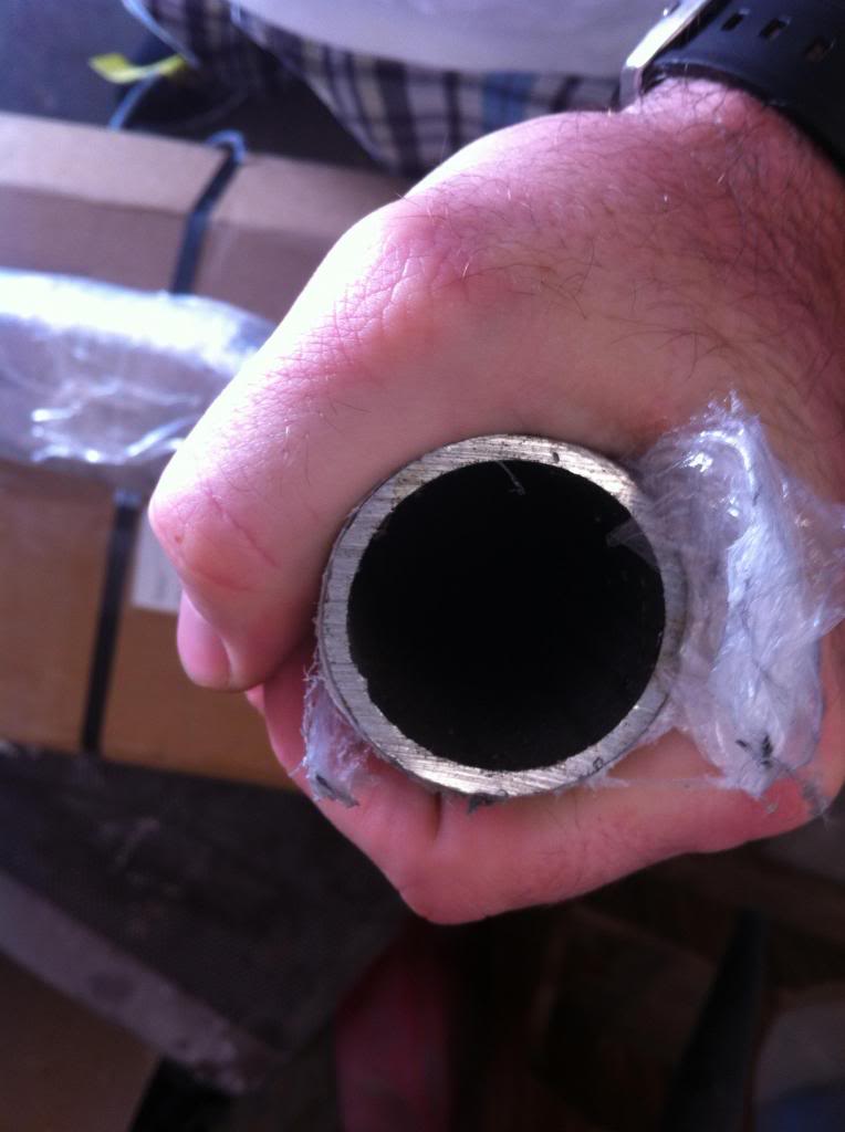

These last few pictures are just showing the different pieces and how they fit together, and lastly I am going to be working on the grill guard pipe (not sure what to call it) and the light bar guard (ditto)

Getting some sleep and starting back at in the morning to work on the protective tubing.

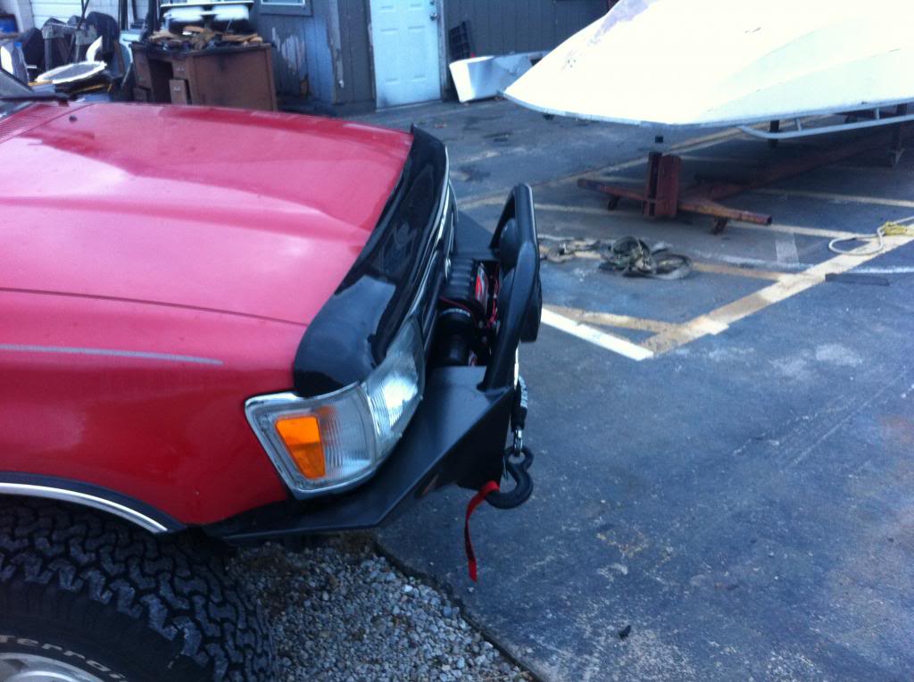

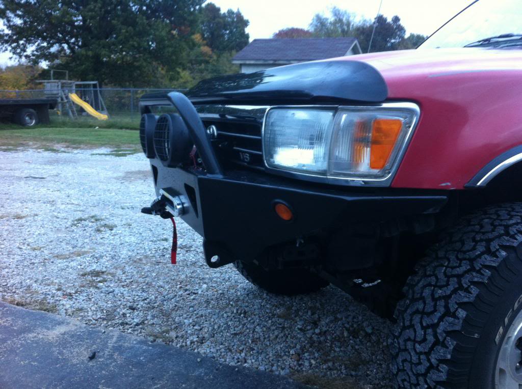

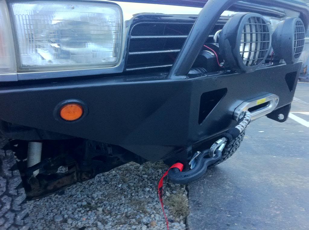

Well I didnt get any pictures of the tubing, except for the finished product....but here it is in al its glory!
I had it powder coated satin black, and mounted my winch, which I had to cut the grill out to get it to fit, its a Recon 10,500lb winch with synthetic line
