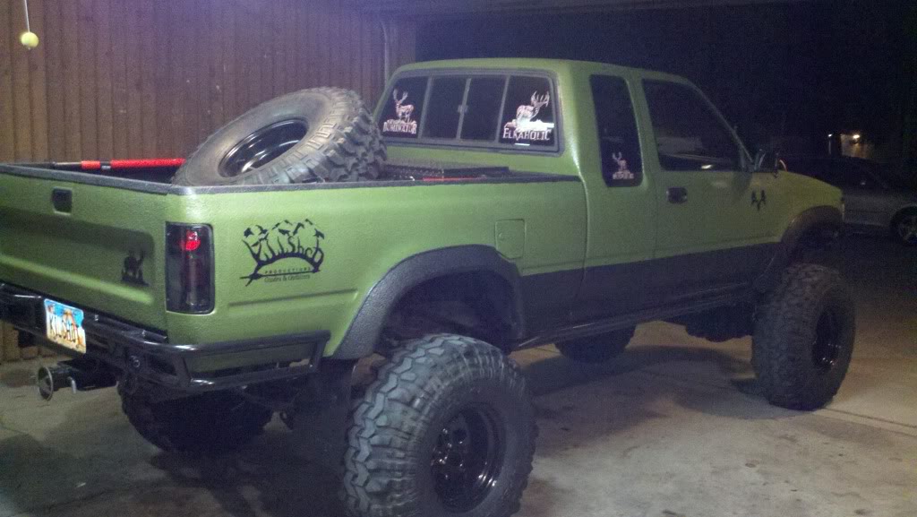

I found a 85 4 runner axle to use as the donor. I completely rebuilt it and added a front diff guard that I built and painted it. I had the truck tore down for about 2 months while I completed everything.
As it sits now:
5" HD springs in front and 5" springs in the rear. 85 toyota 4 runner solid axle, creeper gusset kit, arp studs, custom front diff guard, 4:88's front and rear, lock right in the rear, 36" bias swamper tsl's, 15" steel wheels, custom tire carrier, custom rear bumper, tool box, trail gear front bumper, 8000 lb caisson winch, smittybuilt rope cable, warn hubs, durabak on the truck and bed, tint, new stereo system, 6 under carriage lights, 2 bed lights, 5125 bilstein shocks all around, custom rock sliders, bushwhacker fender flares, magnaflow straight pipe exhaust, high lift and shovel mounted in the bed, I cut out my stock turn signal light brackets off of my stock bumper and welded them on trail gears front bumper to re use my stock turn signals, after market tail lights, head lights, and corner lights, and of course gotta have the camo hunting decals on the windows. Im sure there's more that I haven't listed but you can see it all in the

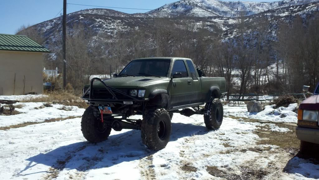

This is my 01 with some more upgrades. It had a TRD supercharger with the 7th injector kit and smaller pulley and ran a 15 flat in Utah in the quarter with 37's on it. With the 4:88 gears I went through a few rear ends with that truck. Had 333 horse power!!

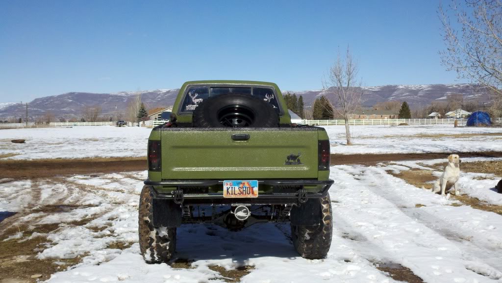

This is my 07 Blacked out with a 6" fabtec lift on 33"s

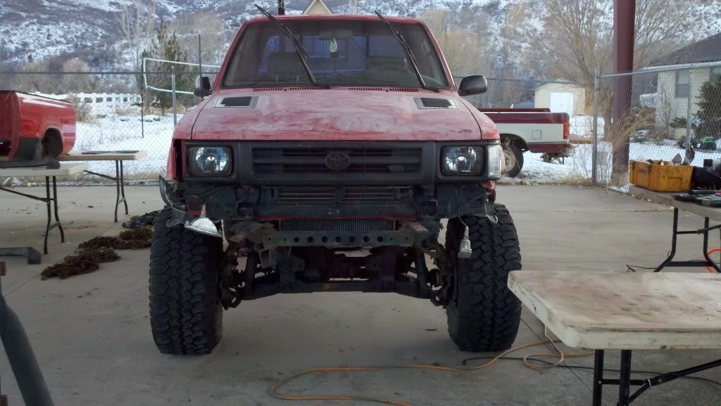

This is the 92 the day I bought it

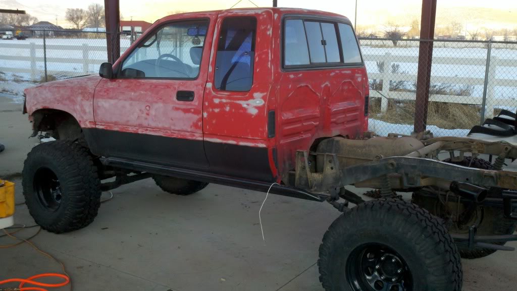

The first day starting to tear it all down.

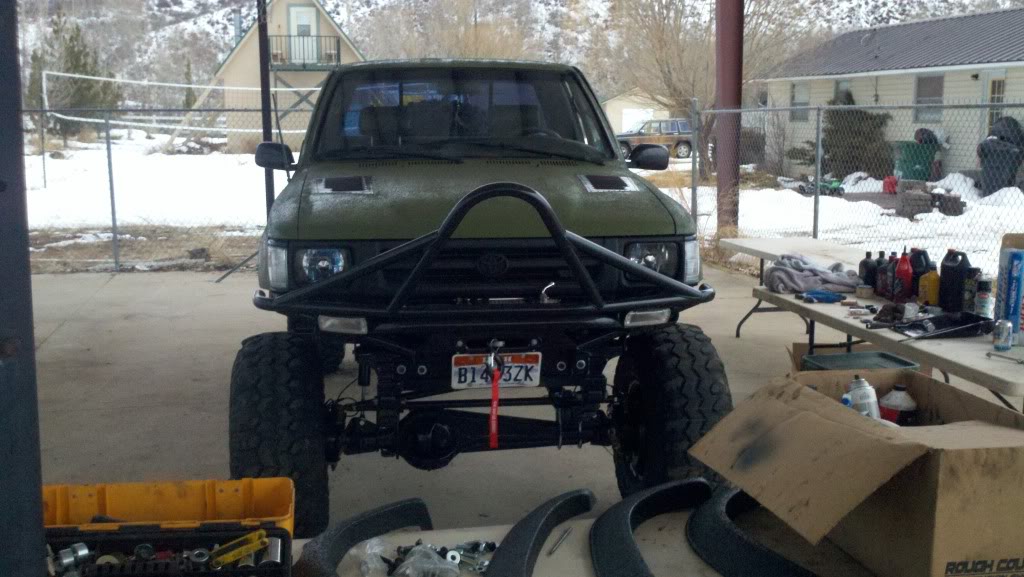

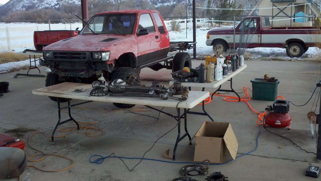

Moved it over to the shop to tear apart the IFS and the rear. What a pain in the ASS all that IFS removal is!! I powder coated a lot of the trail gear parts and painted the rest.

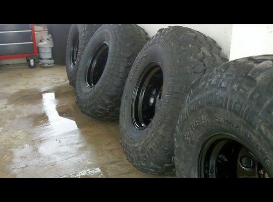

Found a good deal on some 36" swampers with steel wheels and a brand new full size spare to throw on my tire carrier I built.

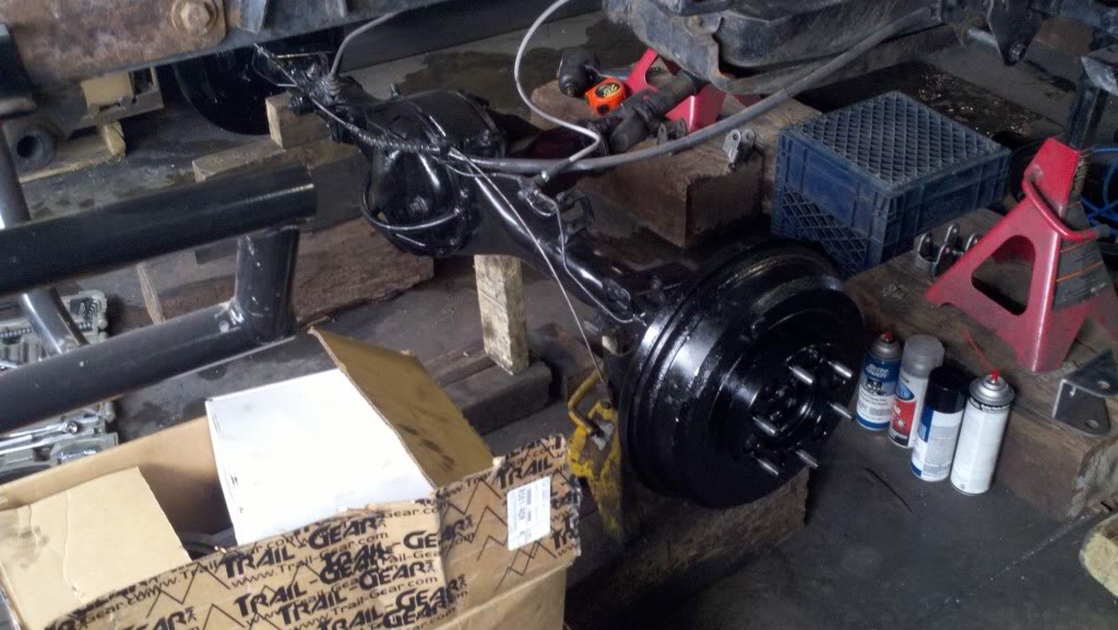

Got the front axle all put together with no major issues.

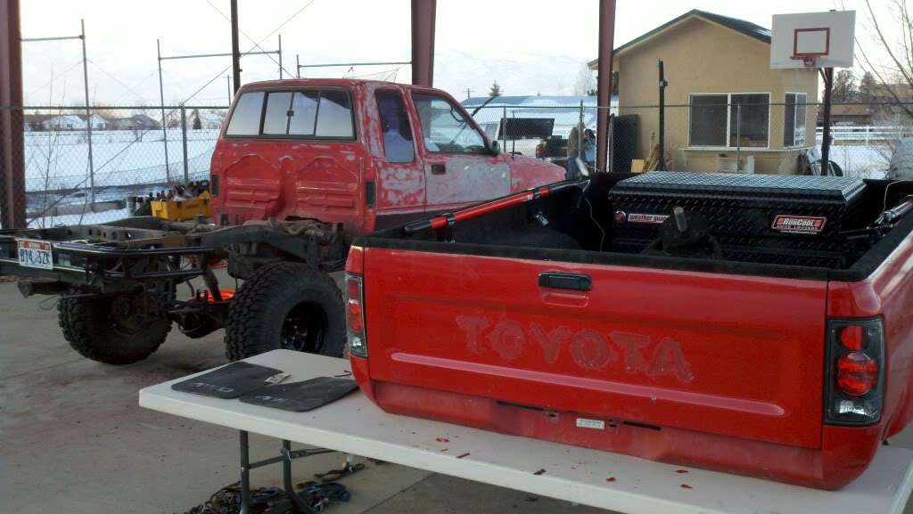

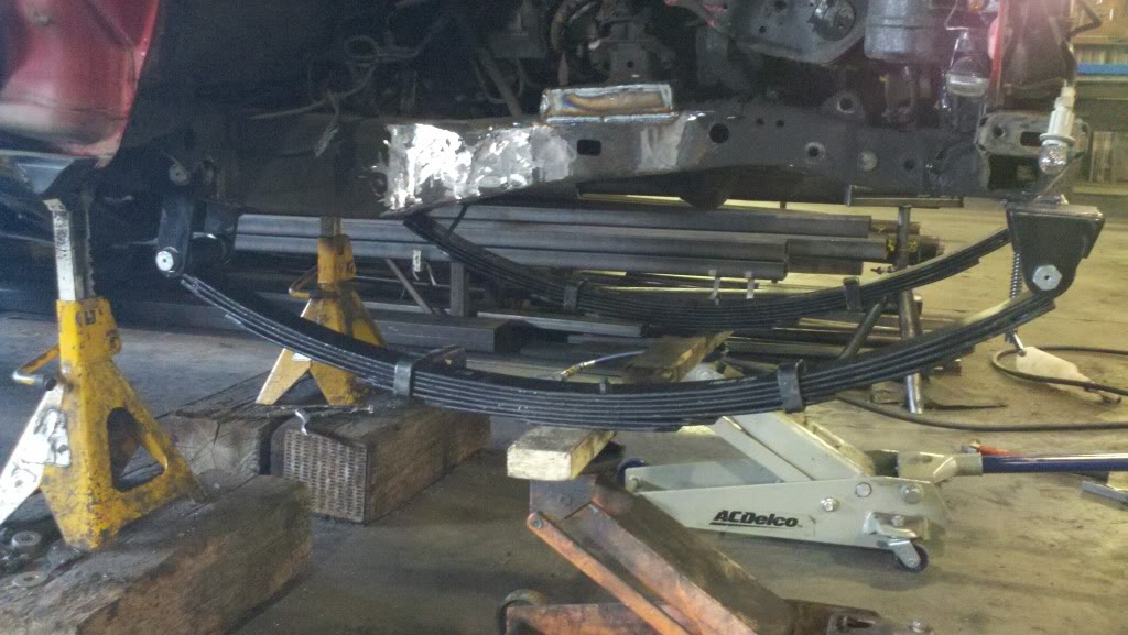

Started working on the rear lift first.
The rear lift about finished
I left part of the stock hanger on the passenger side cause it had my brakelines mounted to it.
Old Feb 29, 2012 | 06:20 AM
BIGTOY88's Avatar
Joined: Jan 2012
Posts: 68
From: SLC, UT
Forgot to mention that I built that rear tube bumper you see while the bed was still on the truck to fit it like a glove!

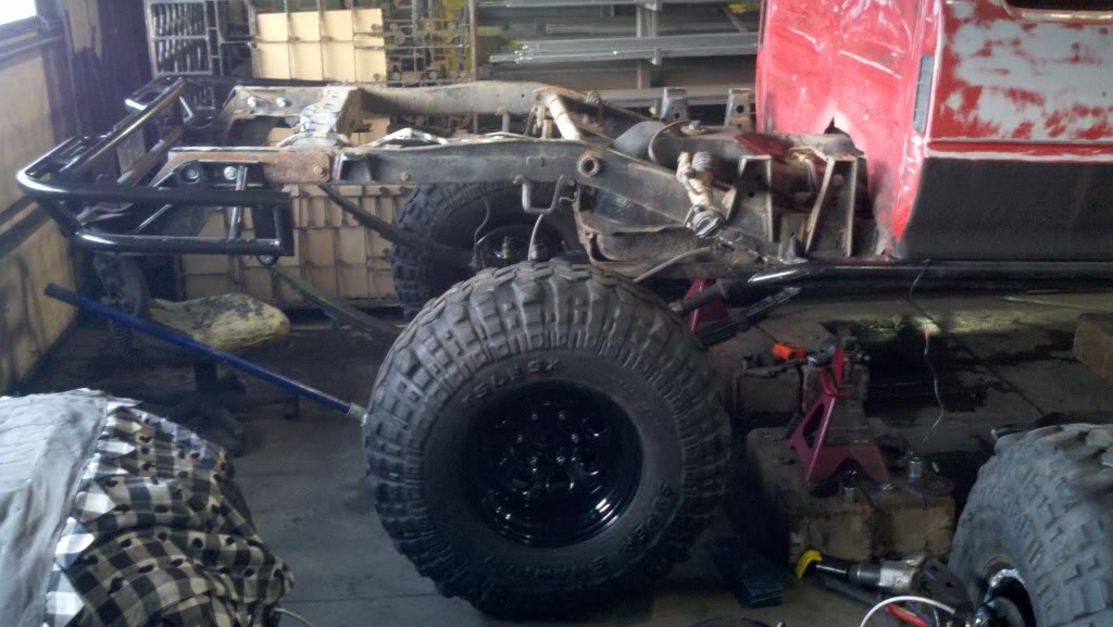

Torched all the IFS brackets off
Then grinded them smooth.
Torched the frame holes and welded the motor mount plate.

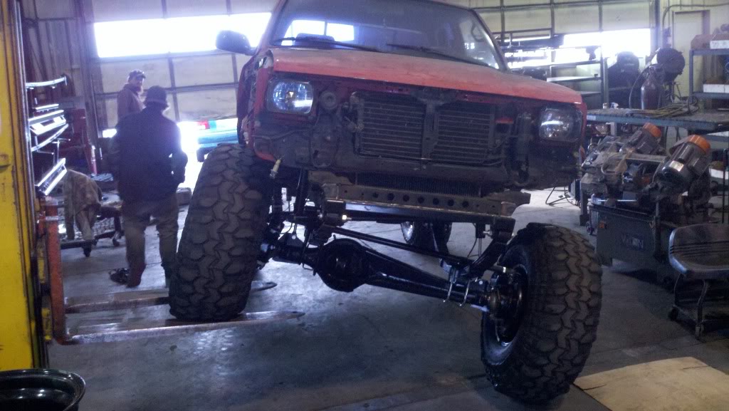

Tacked and clamped the hanger to instal the front springs and then used the floor jacks to test the shackle angle under load.
Welded the front hanger and gussets in.
Moved the front axle in place for intal. Man thats a heavy sucker to move around!!

Bolting it up.
Man that passenger side inner u bolt was a pain in the ASS to get on with my front diff guard!!
Put the shock hoops and braces on and then the shocks.
A little flex test to intal the bumpstops and steering stabilizer.
As it sat after that day.

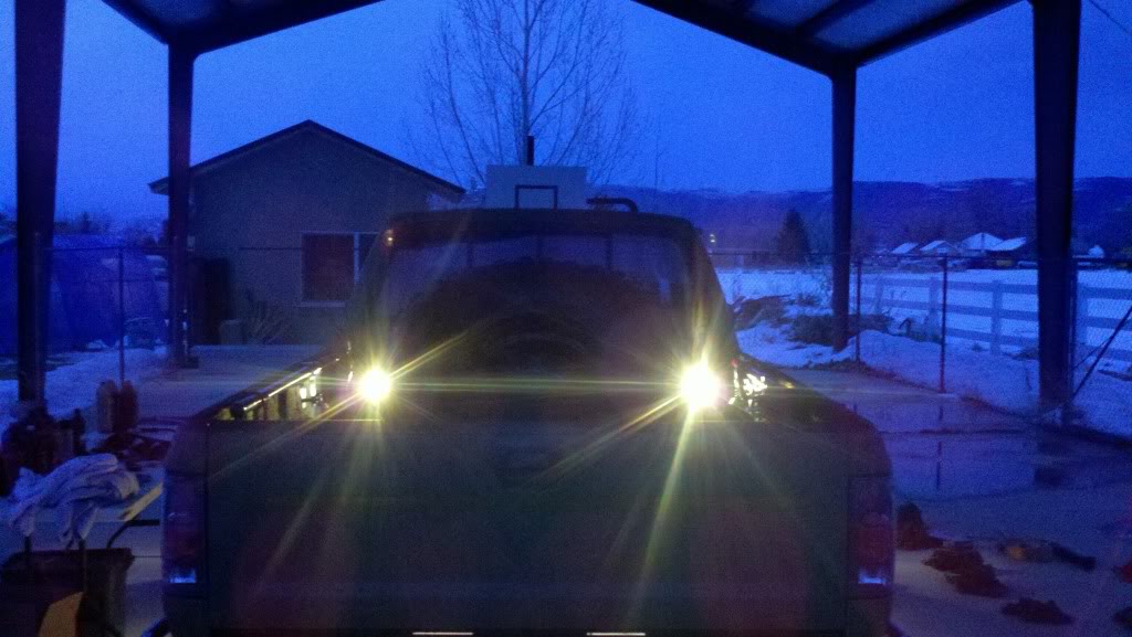

Then I hooked up my under carriage lights and bed lights.

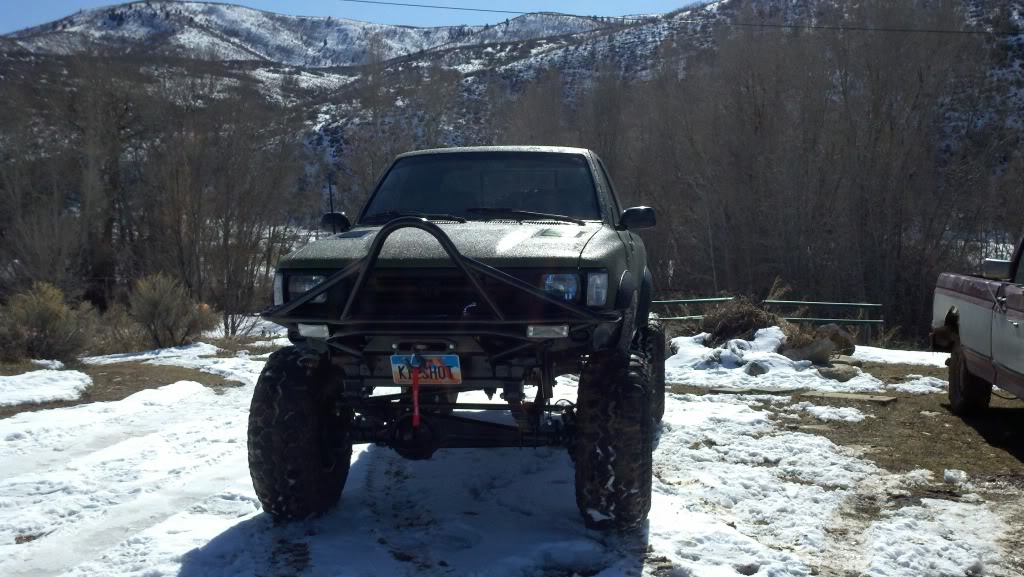

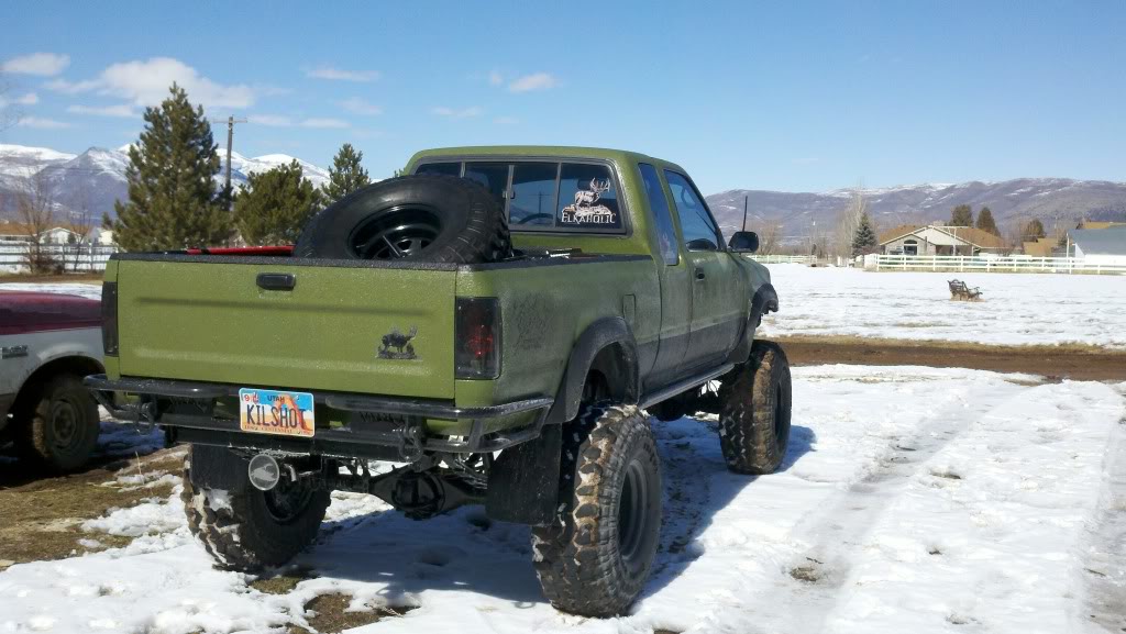

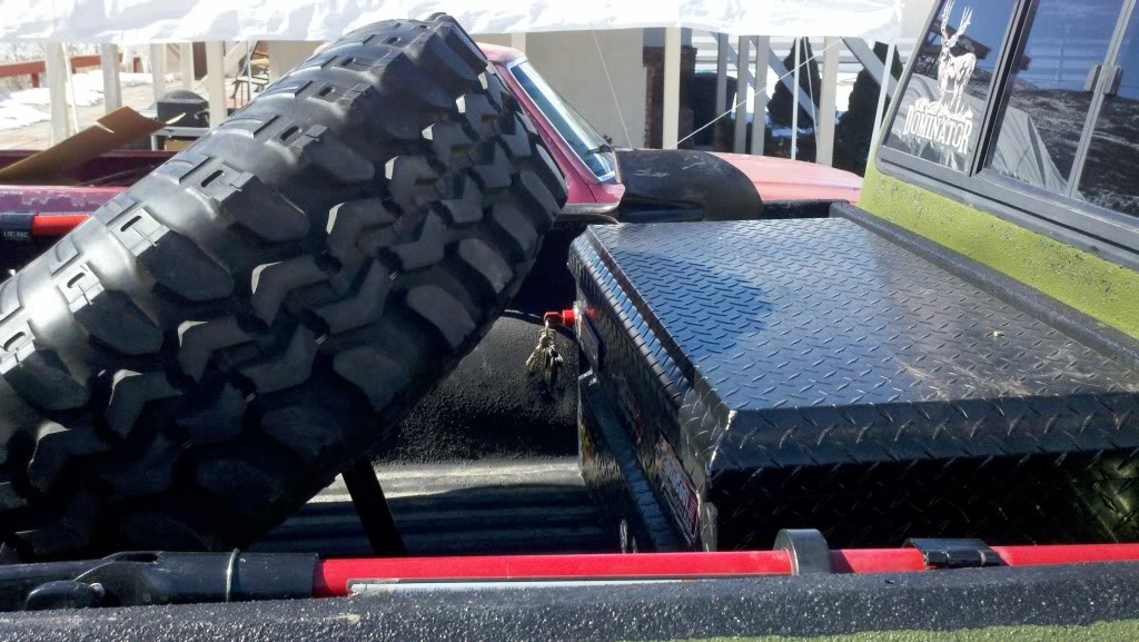

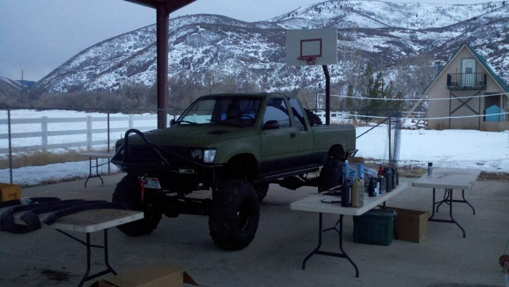

Next I took it down to a buddys shop and had him fine tune the engine for me and replace all the plugs and wires so it runs like a champ now! Heres some pics as it sits today. I still need to figure out a better way to mount my rear shocks to give me more travel on them because there is only about 4-5 inches of rod sticking out of the shaft and it will limit my rear flex.

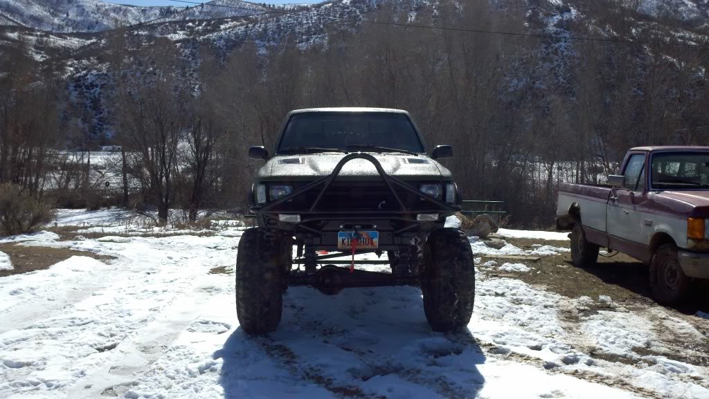

I hope my build up will help some people out with their own and give them some different ideas. It is good to give back to this site as it has helped me learn a lot about these trucks and how to troubleshoot different issues you come across while doind projects like these.
I am picking up my front driveshaft today and will be taking it out on its first wheeling trip this wknd so hopefully I will have some good wheeling pics to post up for you guys soon.
