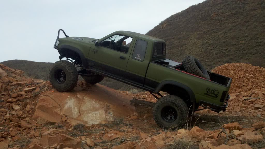

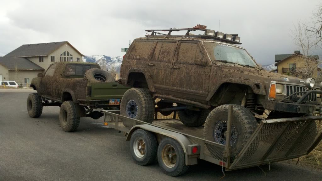

Finally got out and did some wheeling this wknd. The truck performed flawlessly with no issues. Heres a video and some pics for you guys.
Old Mar 19, 2012 | 05:44 AM
  #38
BIGTOY88's Avatar
Joined: Jan 2012
Posts: 68
From: SLC, UT
Doesn't look like the video wants to play on here. Sorry guys. Hopefully the pics will. Cant wait to put chromoly's up front with a locker and really see what this thing is capable of.
