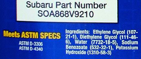

First, if Subaru still sells its "Long Life Coolant", P/N SOA868V9210, you're in luck - its ingredients appear to be identical to Toyota Red: Ethylene Glycol, Diethylene glycol, Water, Organic Acid Salt (532-32-1) (which is sodium benzoate), Potassium Hydroxide (1310-58-3) I would still flush well before switching and not mix the two coolants, just to be on the safe side. This would be my first choice if Toyota Red were unavailable.

where did you find the ingredients for the red coolant? know anyone who's swapped for the subarau long life with good results? if you're right, which you usually are, this is a great option for our engines. here's the stuff:
http://www.fredbeansparts.com/index.php/subaru-long-life-coolant.html?___store=default
it's cheaper, and does NOT come pre-diluted like the new pink stuff, so you get more bang for your buck.

ok here we go:
looks like they are the same! the benzoate (organic acid salt in the red) is a great anti-corrosive agent for mild steel and lead-solder. it also increases AL heat transfer corrosion, which may be why toyota is doing away with it. i haven't found many places that sell the subaru stuff, but i'm gunna call my local dealer on monday and see if they carry it. hopefully they aren't discontinuing it as well...
