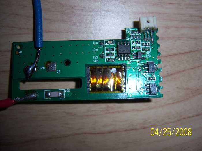

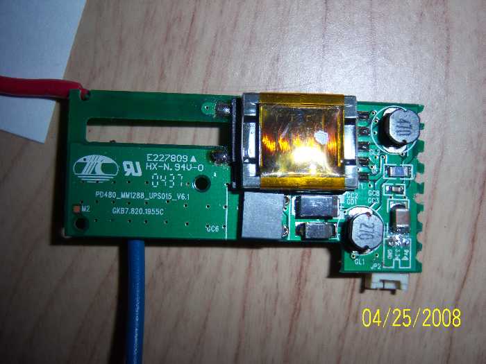

im not sure exactly and that is the problem I scavenged the parts for it off the pc board of the dvd player it came with, an apex digital pd-480. it needs a 9v a 3.3. and a ground. the 9v is going to need varying current im sure cause it has a transformer putting out a lot of voltage 700+. So I was thinking of using some diodes to get the right voltage im not sure what the current needs are I cant find any schematics for it so im tracing out the circuit and im going to make a schematic and try to make sense of it from there. Thanks for the assist.

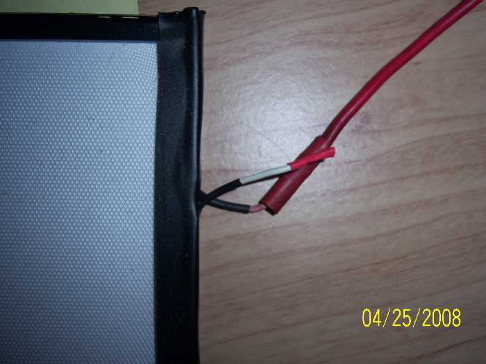

oops meant to show some pics
Attached Thumbnails trouble with circuit for light-ccfl_boardback.jpg   trouble with circuit for light-ccfl_boardfront.jpg   trouble with circuit for light-ccfl_wiring.jpg
