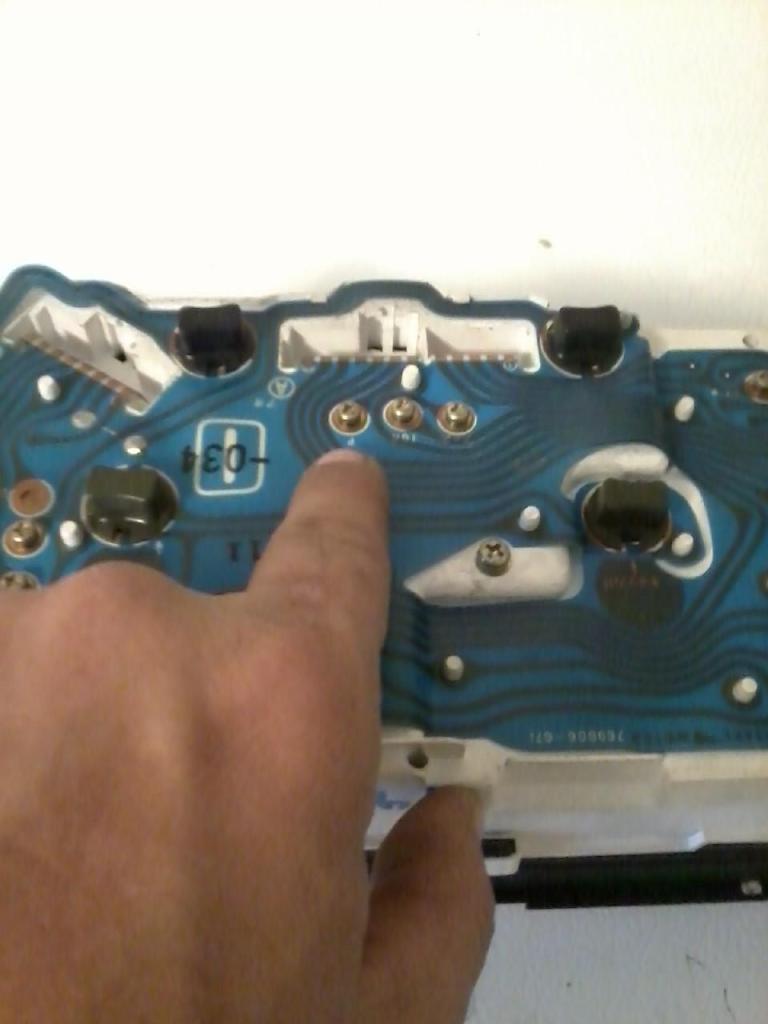

I dont know if you are adding the tach or had one before, but you can run a wire from the ground side of the coil to the "p" on the back of the cluster. Not all trucks are wired for the tach in the harness for some reason.
Back of guage is marked with a "p".

My back of the cluster doesn't look like yours but it came stock with the tach it just stopped working

run a wire from the negative wire of the ignition coil to the "P" screw in the back of the cluster gauges. I just swapped mine from a 3 gauge simple version to the SR5 cluster and it worked for me
