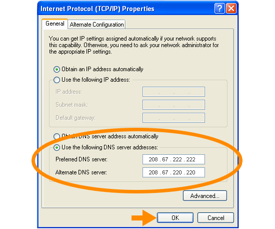

Hey corey about the opendns thing, all you should have to do is change the dns settings in your network properties page for your network adapter. I downloaded the image with the settings:

Thanks Arjan, I inputted as I described over on DSL's forum in both places.
All is working well, the problem has not come back.

I thought I read somewhere that the opendns website wasn't accesable, that's why I posted the dns server addresses.
