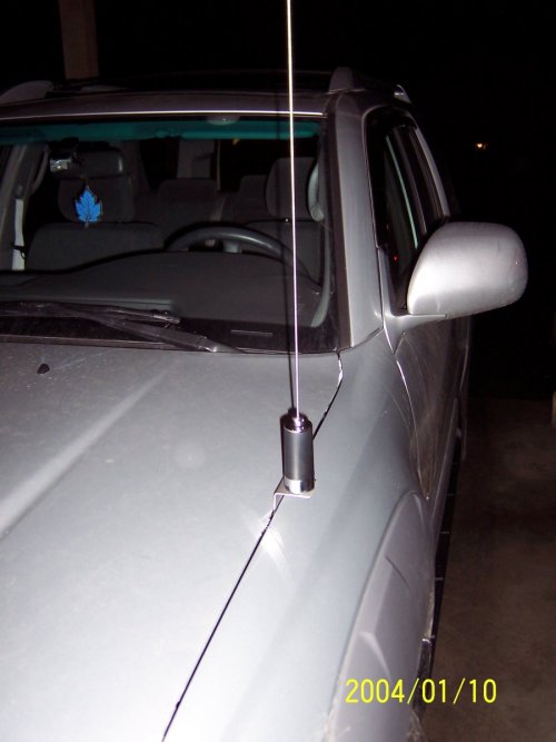

I liked Al's setup so much, that I cloned it on my rig:
http://www.hboss.net/4runner/cb_install.htm
If you want the contact info for the mounting bracket, let me know.

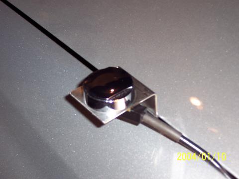

I topped it off with a nice NMO cap too and cloned it further to the other side for my ICOM 2200-H radio.
Attached Thumbnails Limited Use CB Antenna (to use with Cobra 75WX)-nmo_cap.jpg   Limited Use CB Antenna (to use with Cobra 75WX)-4thgen_maxrad_mlb2700_antenna.jpg

Anyone have experience with the Lil-Wil mag mount from Wilson? I was thinking of it or the 1000.
yabedude, that is slick. Do you have info for the mount and do you have issues with it rubbing at all, like flex from offroading?

No rubbing problems. I used heat shrink tubing around the base, up to the level of the hood, in case it did decide to come loose. So far so good. Both sides of hood are still firm/solid. It's been thru the bush on a few occasions, and both sides got tugged on more than a few times -- I've got the scratch marks on the sides as evidence. No issues to report.
The bracket was purchased from:
http://www.cbcity.ca/index.php
CB City
16806-118 Avenue
Edmonton, Alberta
T5V 1M8
Canada
(888) 451-4141 or (403) 451-4141 if that doesn't work.
This is what they call a "Z" bracket. Note that they only have (had?) 3/8" holes in their brackets and, if you go with my setup, you'll need 5/8" to fit the Maxrad NMO. I got my brother to bore the holes larger. Cost was $10 + $0.70 GST + $6.53 shipping = $17.23? To ship to the US will probably be a bit more -- assuming they'll ship south that is. Don't assume anything.
