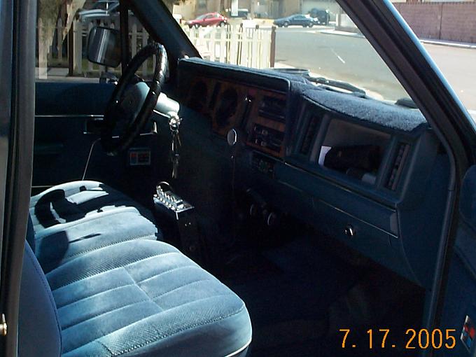

Were you able to get the CB installed? That cobra 29 is a pretty big radio for our little trucks. If you go to a home improvment center like home depot or lowe's you can get a piece of flat steel & bend it like a U shape (flat on the bottom) Then you can mount it onto the floor on the transmission hump & drill 2 holes on each side to hold the CB in place upright. I have done this to a few of my trucks. Here is a pic of a cobra 29 in my Bronco II. Good luck.

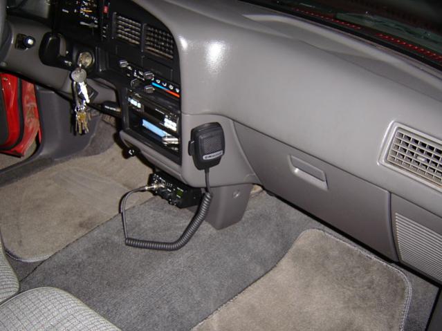

Here is the CB in my 90 Toyota. It's a smaller midland. I wanted something smaller that would fit in this truck a little better since it's kind of small inside.
