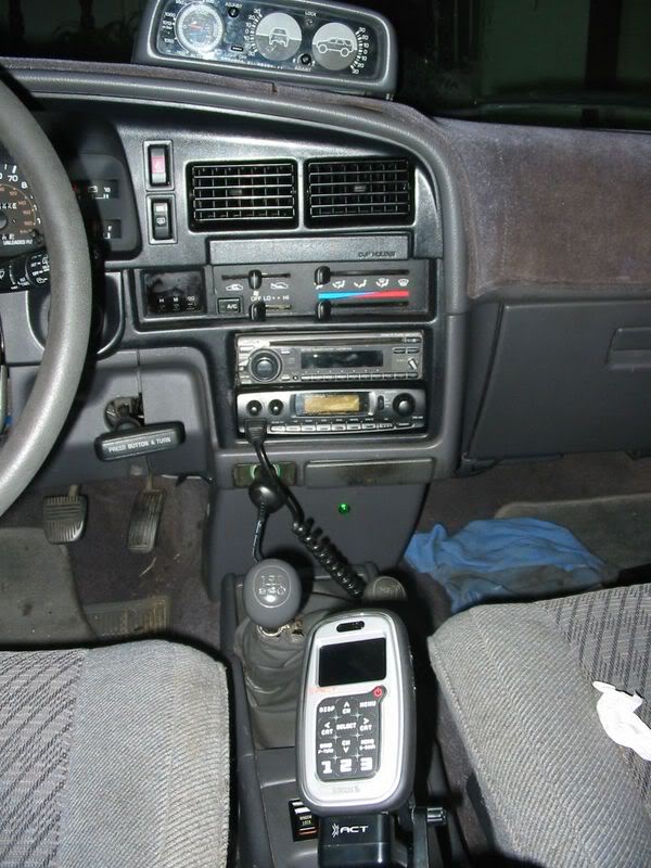

I too went the ashtray mount
I have been pretty happy with it so far

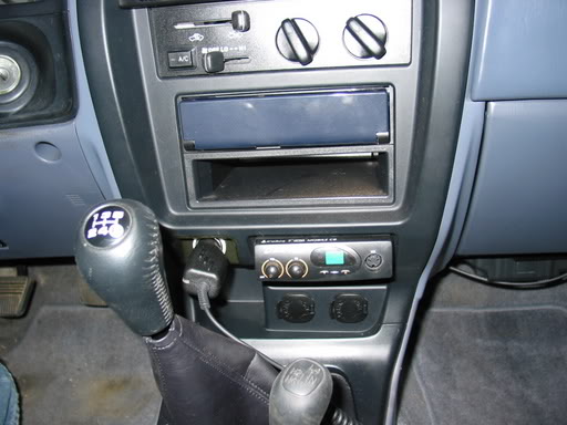

I used the empty pocket underneath the radio...
I mounted the mike to the shifter. The mike has up/down channel buttons, so I can change channels w/o having to look at the radio.

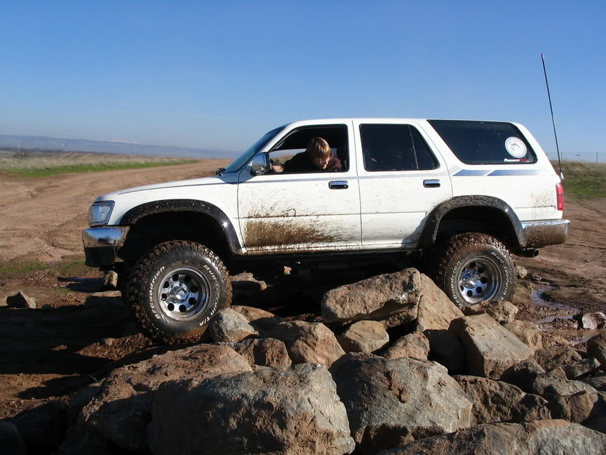

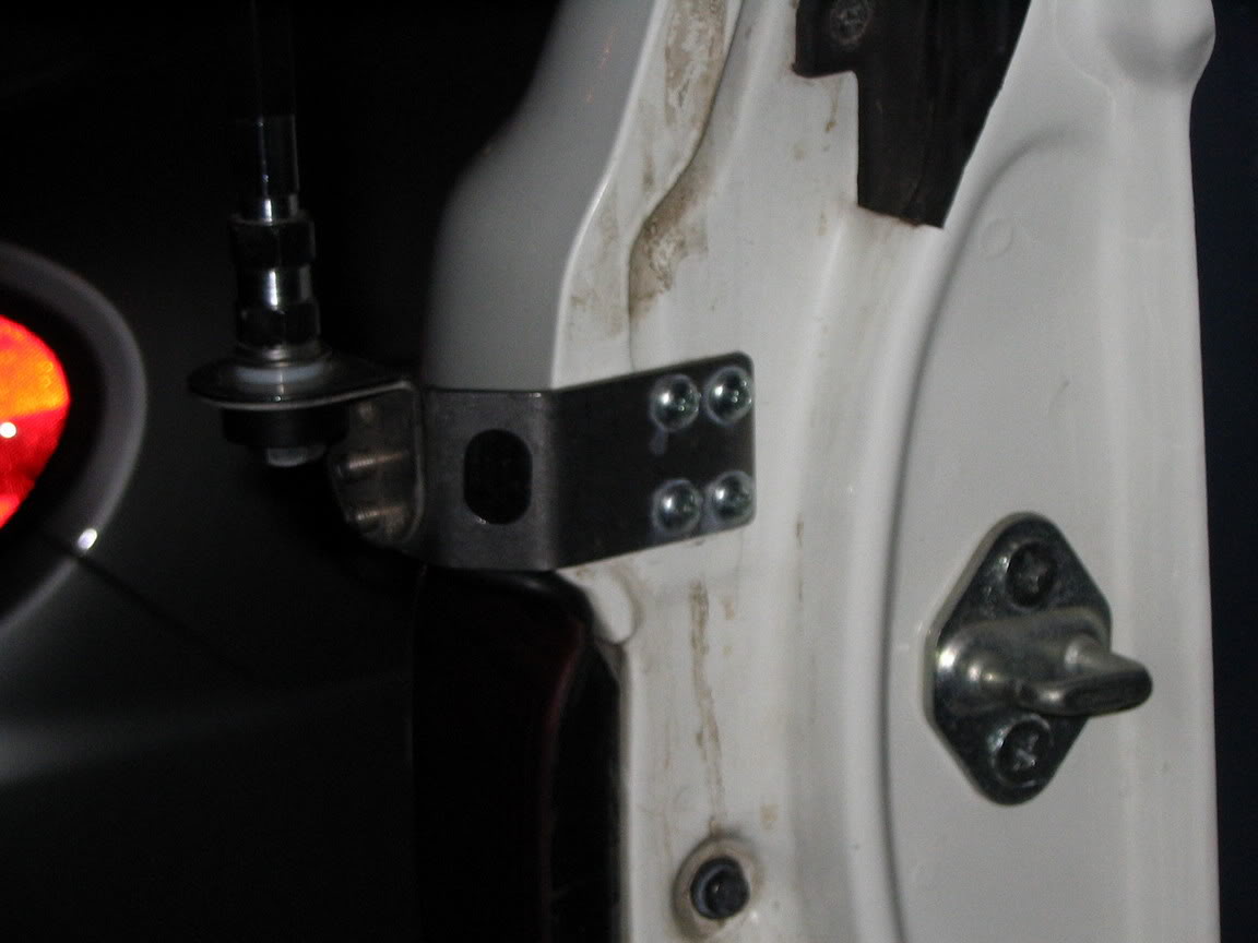

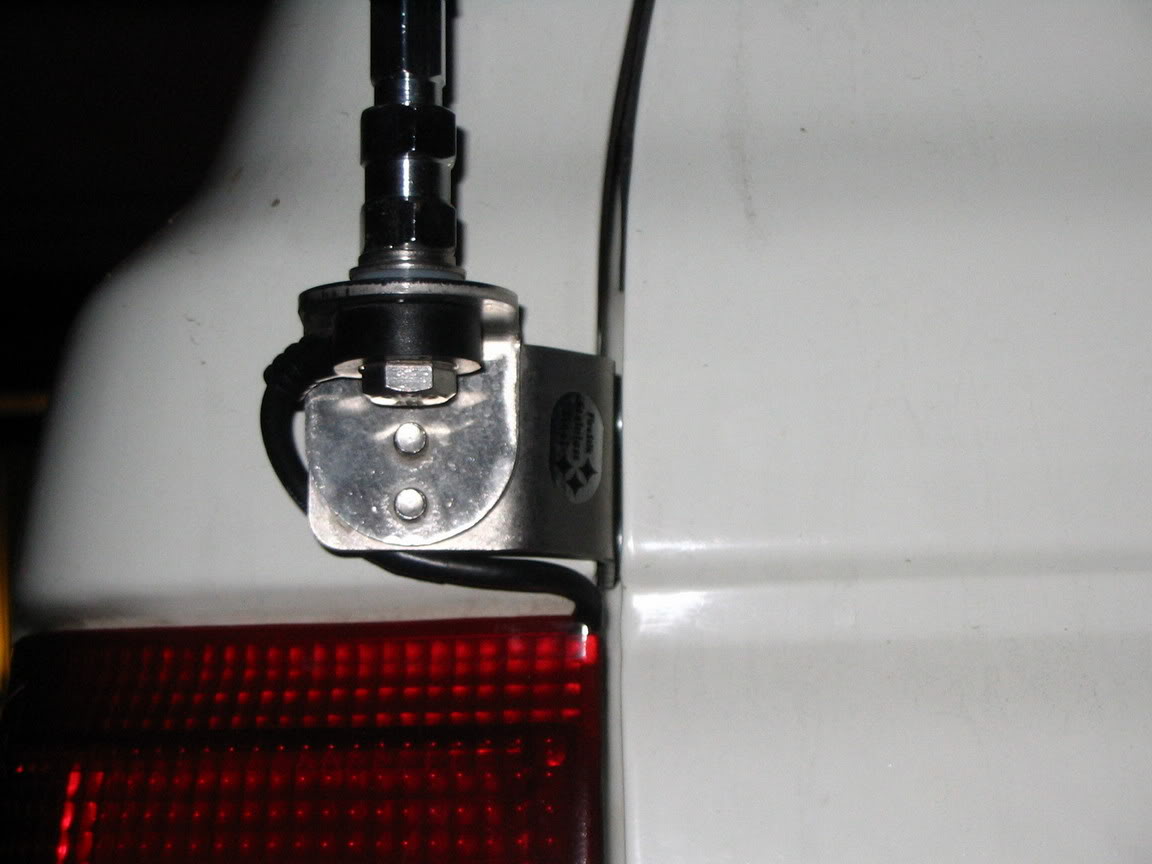

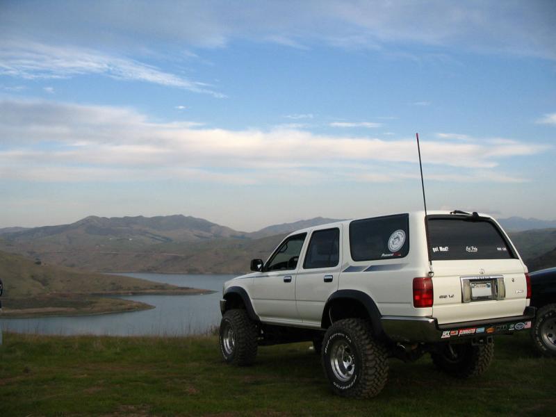

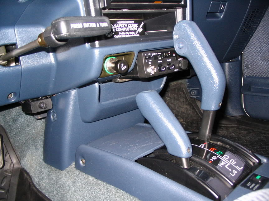

Here's my install...
BTW, that's a 4' antenna...

Runner kid I think I'm going to do my antenna like that. How did you attach the mount to the body? Did you use some kind of metal screws Mine is a truck but that shoudln't really matter. Thanks for the ideas guys.

4RunnerKid,
Where did you get your CB mount? I've been looking at local shops, but haven't seen one like it. Does it have a brand name?
