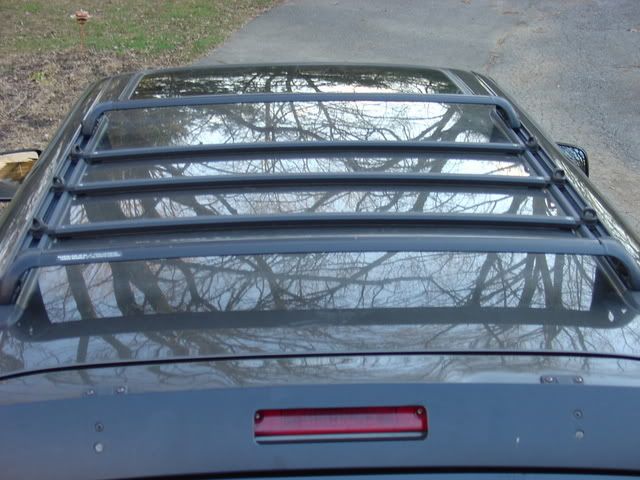

Is it possible to mount a CB antenna on the Rear Roof Rack Rail?
I don't know what basic principles apply to a mounting CB Antenna since I have only had experience with The magnetic mount...
I read somehwer that they had to be grounded?
Is this correct?
Just a newbie to the CB world and needing some advise...
Here is a pic of the rail I am talking about...
Any imput is greatly apprciated....
The magnetic one was mounted right in the center behind the bar before...

you could probably ghetto-rig some sorta CB mount to the rail but you would need to run a separate ground wire as those rails im sure arent a good ground. run the ground straight to the frame if possible. otherwise, have you looked at a rear mount such as on SC4Runner's runner? i had mine like that but i don't think i got any pics of it that way

Yeah, teh Rails are a mix of plastic and metal (can't tell whcih is which really...)
If I have to run a ground I will...

they make non-grounded CB antennas let me see if i can find the thread.

It is JacksonPT that had the roof rack CB. he used a NGP or Non Ground Plate antenna.

Hey I already replied to you with a lengthy PM, but, yeah, these guys know what they are talking about.
You need a NGP antenna to run up on the roof-rack, and regular if you plan on having a rebounding surface behind.
