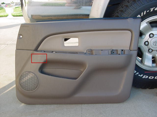

I just got a new set of CDT EF-61cf components and I tried mounting the crossovers in the door panels of my 99 4runner, but couldn't get them to fit.
I was wondering where you guys mounted yours.

I've got a set of the EF-61i's. I believe they have the same crossover (SatNet 560). I mounted mine in the door panels turned sideways. I attached a pic (stolen from http://www.hboss.net/4runner/door-panel-removal.htm) to show the location.
They barely fit without the grills and the window/door lock panel just barely clears them. I think I screwed one side to the plastic speaker panel and the other side to the door. I also took a dremel to the back side of the door panel to remove some unnecessary plastic that was in the way.
