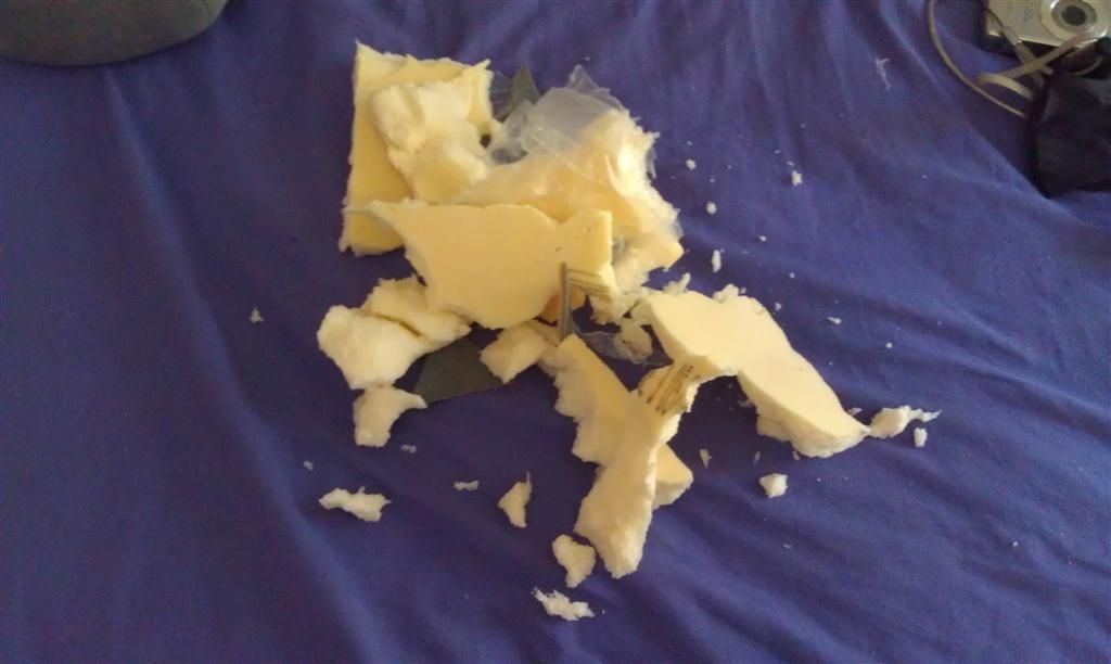

so step one was to take a deep breath, cut open the material, and dig out a void

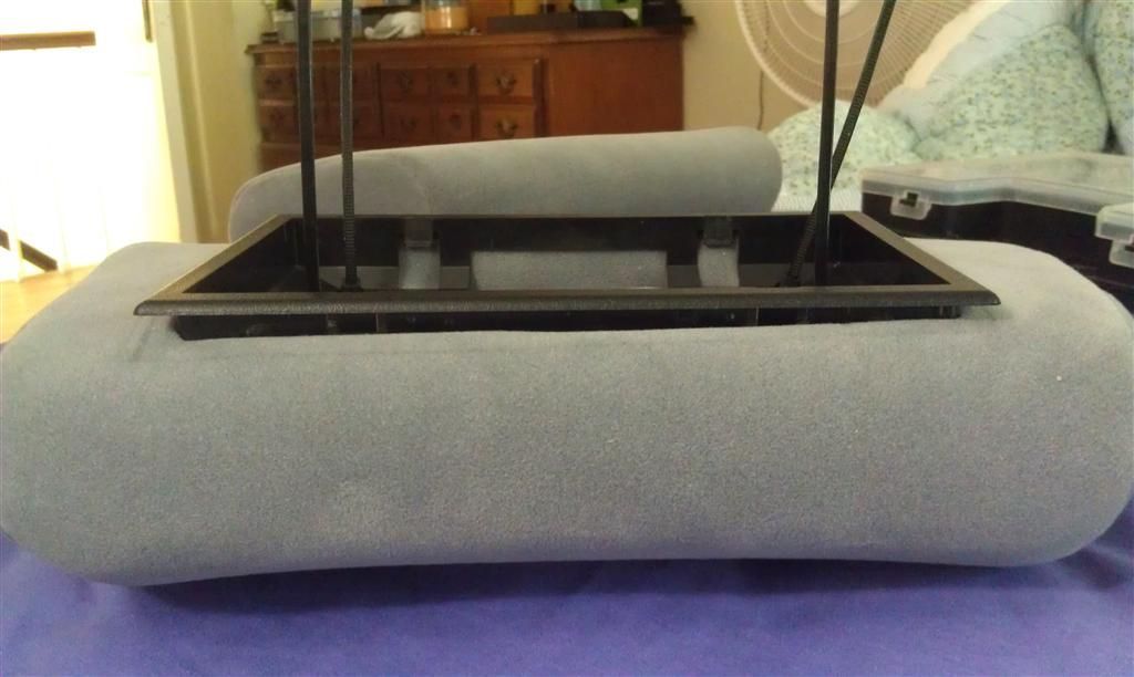

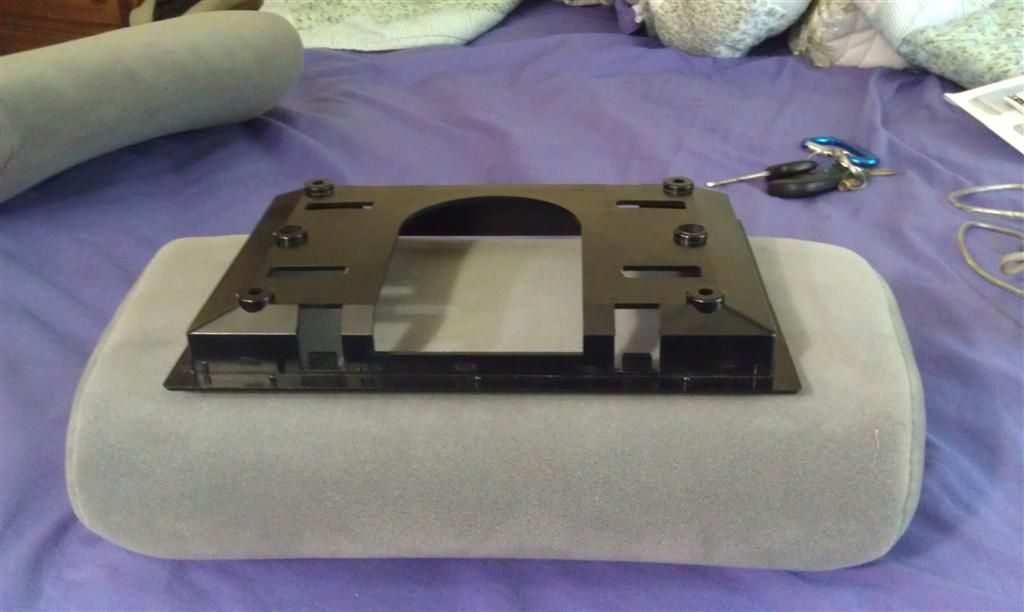

they're suppose to mount by setting the bracket down into the void, fastening the bracket to the metal support beam in the headrest, and then you can just pop the screen itself into the bracket. UNFORTUNATELY, the rear seat headrests are not quick thick enough, and the bracket only sits so far into the head rest before it hits the metal support bar... thus making the bracket stick out and not sit flush with the headrest...
easy solution, just slip the bracket inside the headrest and BEHIND the material, flip the material over and into the bracket, and then push the screen down into the bracket, and it fits EXTREMELY tight, so they're not going anywhere. but this actually made the finished product look really clean since there's not a large edge around the screen itself
