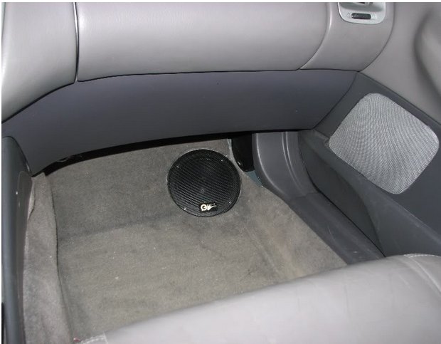

Only thing I can think of
Attached Thumbnails Pickup speaker placement/mounting?-floorbass.jpg
Wow that looks functional
I try my best for great success
