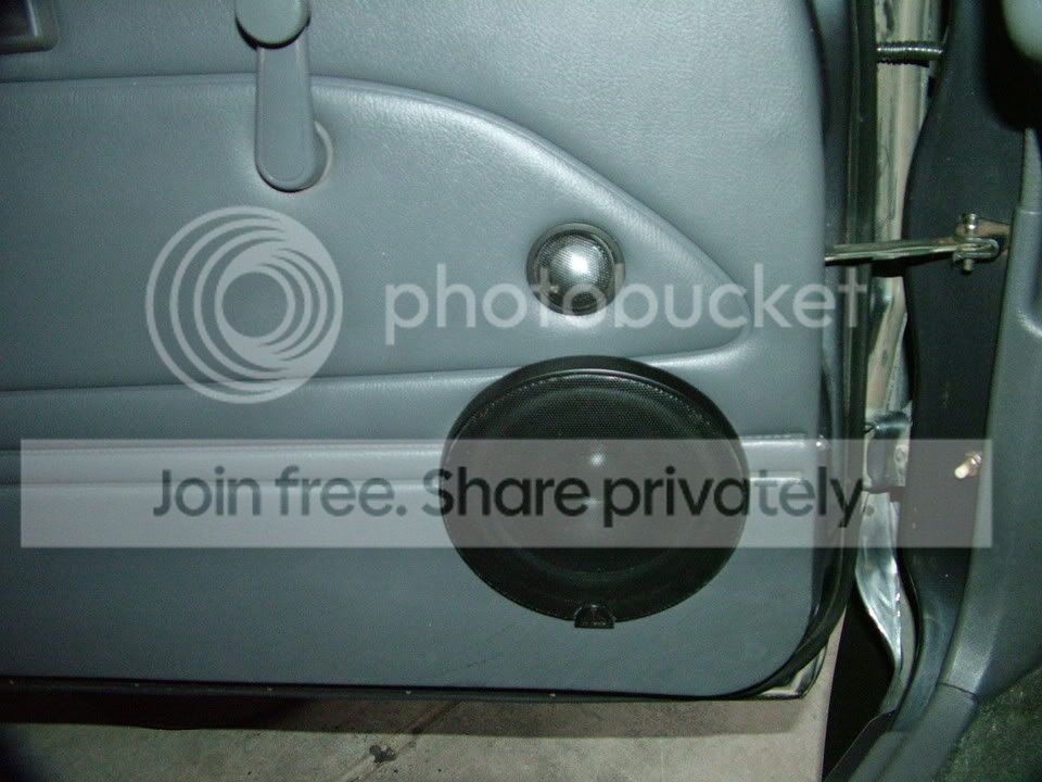

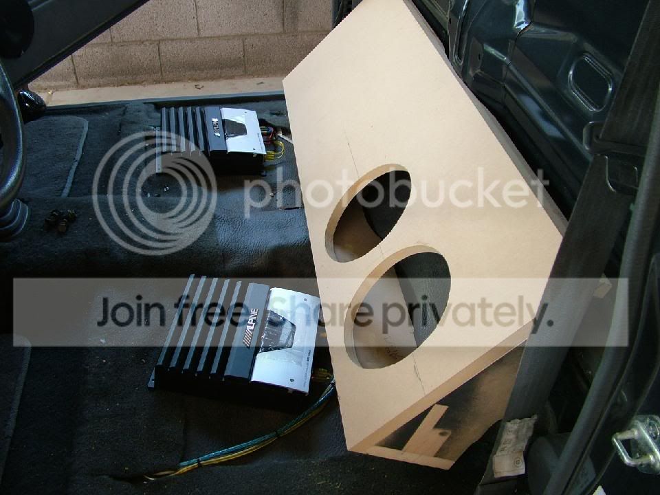

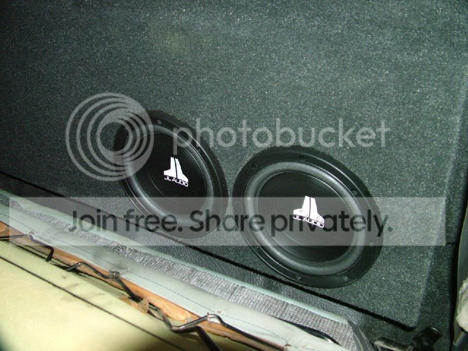

Heres what Im using........
Im using JL Audios in my '91,mids and tweets in the doors(JL Audio xr-650's) and 2-8's behind the seat.Alpine head unit 9827.
Im 6'1" and still have plenty of leg room for long journeys.Not only that but I have a jammin system that I really enjoy.Great sound qaulity and more than enough volume to leave your ears ringing if you want.
heres a few pics.....

First I would go to www.crutchfield.com to see what would fit in the doors. They have a very nice fitting process that will give you an idea what you can do. Then I would fabricate a box to go behind the seat to hold the amp and sub. In a regular cab pickup you can really get some bump.

Working in a small space like a std cab, When it comes time to build an enclosure, think "fiberglass".
Glassing around odd-shaped panels and uneven floors will let you get more internal volume vs truck space used instead of using flat pieces of MDF. I would still use MDF for the panel the speakers mount into.
Techiques for glassing cabinets inside vehicles are available in many places on the net, its easy to do.
