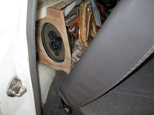

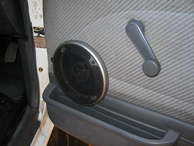

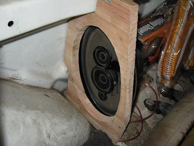

Ok basicly the problem with a hilux sr5 is that there is no space anywhere inside for speakers.
so what i did was put some 4" speakers in the front doors, (cant fit any bigger as the window and door hinge get in the way)
Then i put some 6x9" speakers behind the rear seats, mounting them onto wood and having no box, this works well as it turns the entire seat into a box for bass so as a result the 6x9" speakers put out some impressive bass.
so if anybody is looking for ways to change the wimpy toyota stero then try this, its easy

Thanks guys, yeah i just got fed up of having no real stero so i made this . in total it cost me about $20 , £15 for the speakers from the local scrap yard and $5 for the wood
and the spekers work well but they dont produce as much trebble as they would normally because there behind the seats, so there more for bass than anything, you could always put some small speakers into the dash and have some behind the seats so youve got trebble and a bass ? even without doors
