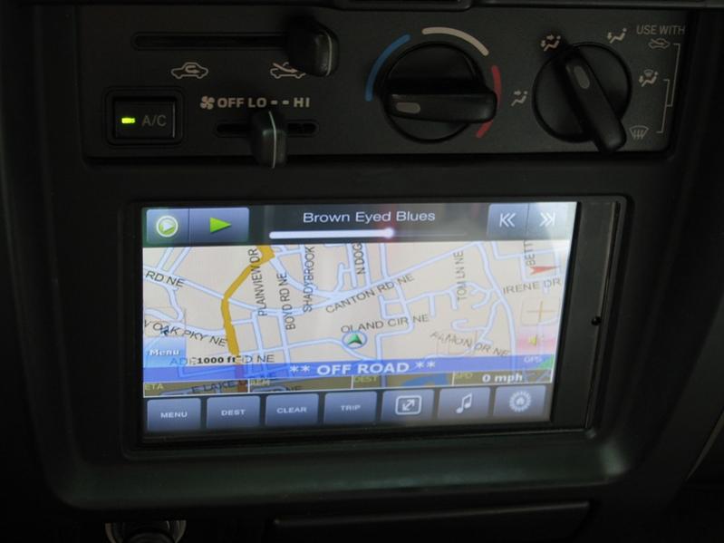

CarPC photos
Here are a few photos of my touchscreen... I use Centrafuse (by Flux Media) as my front end, iGuidance for navigation and the OBD (built into Centrafuse).
