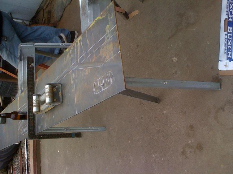

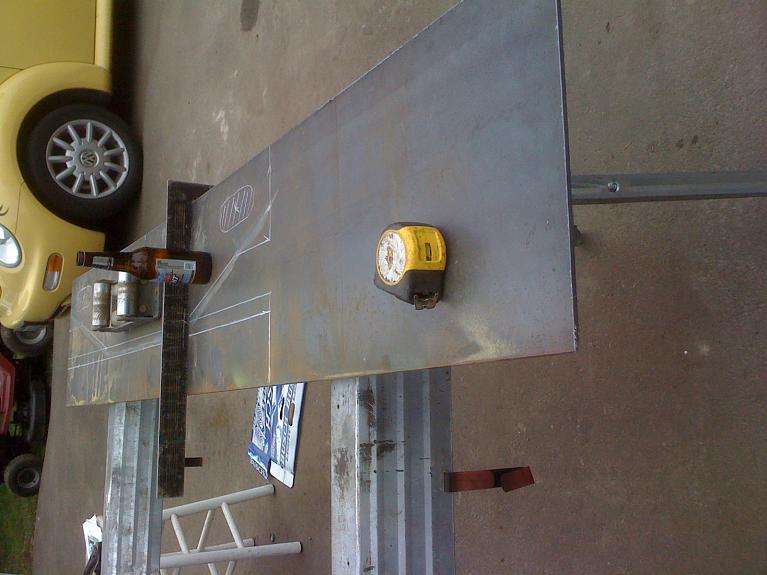

Alright so started on building my bumper today, took a few measurements. Lined out cutting points on the steel. Im using 3/16" steel because its not heavy like 1/4" but it still can take one heck of a beating .
Should be cutting it out on monday then depending on my schedule putting it together this week. I also did a block test today since ive suspecting a head gasket problem and i was right so i will prob be doing a head gasket job this sat too ha. i have a few pics and ill keep them coming no worries guys. Dont know why the pics are sideways ha. Also suggestions and tips before its built is greatly appreciated.
Attached Thumbnails Yoder's bumper build-iphone-pics-077.jpg   Yoder's bumper build-iphone-pics-076.jpg

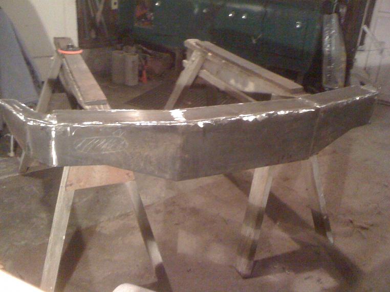

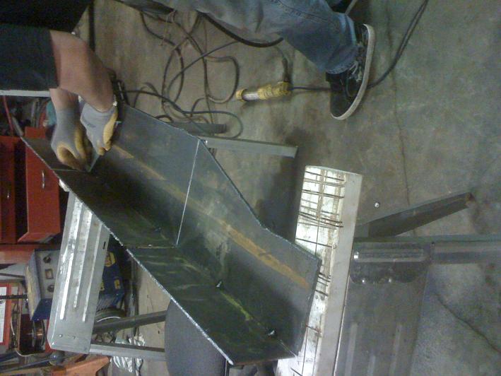

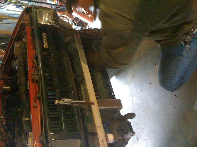

finally put most of the bumper together to give it a shape
Attached Thumbnails Yoder's bumper build-iphone-pics-078.jpg   Yoder's bumper build-iphone-pics-079.jpg

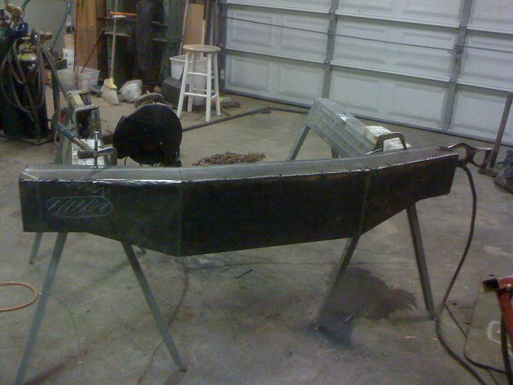

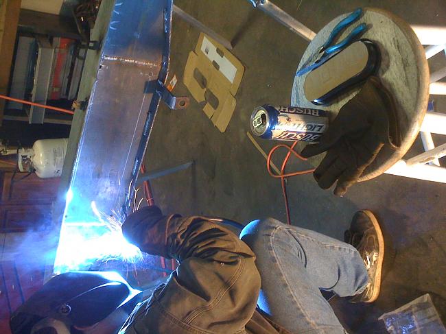

ha actually its my neighbors but if you throw cash at him he dont care ha, here are a few pics. It's almost done!just have to weld a few spots where worm holes occurred cuz the wire feed was too fast and i ran out of gas , did 45 degree corners also bought lights with the grommits fer the blinkers.
Attached Thumbnails Yoder's bumper build-iphone-pics-080.jpg   Yoder's bumper build-iphone-pics-081.jpg

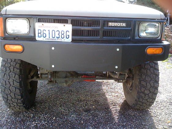

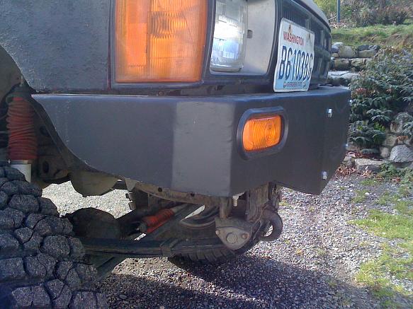

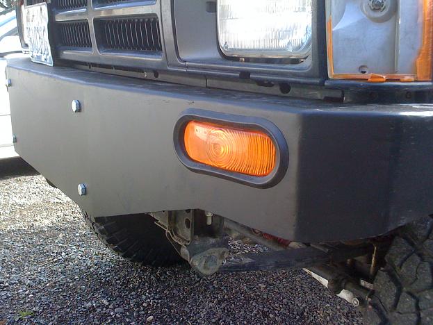

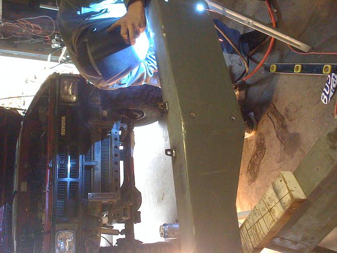

Alright guys so basically i have finished my bumper for now, will be putting in a little more tubing and pull points later down the road. Also a winch will go on when i have the money ha. here are a few final pics
Attached Thumbnails Yoder's bumper build-iphone-pics-082.jpg   Yoder's bumper build-iphone-pics-083.jpg   Yoder's bumper build-iphone-pics-084.jpg

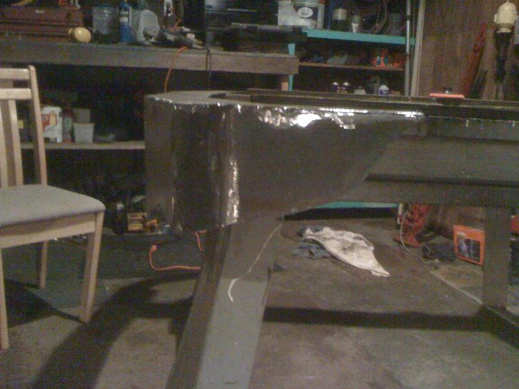

sorry about the sideways pics, here it is finished!
Attached Thumbnails Yoder's bumper build-iphone-pics-090.jpg   Yoder's bumper build-iphone-pics-089.jpg   Yoder's bumper build-iphone-pics-088.jpg
