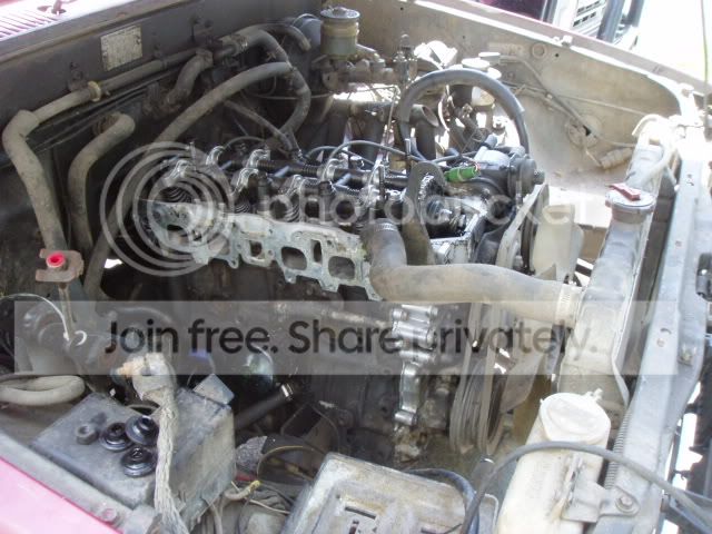

Yesterday when i stopped:

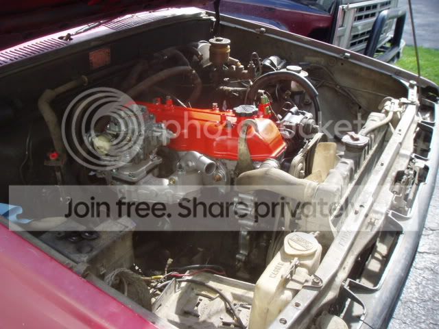

Today ~ 6:00
When i ran out of daylight:
The motor is pretty much together and done now. I should have opened up the ports on the head while i was in there, but oh well. Im not shooting for gobs of horsepower, but she should run out pretty good.
Ive got some stuff to take care of tommarow still before I get it running, like wiring the fuel pump, running fuel line, hooking up vaccum lines and heater hoses. I also need to fabricate some blockoff plates for the EGR ports, but that is not something that needs to be done to get it running. Barring any more unforseen household issues or weather problems, it should be ready to try and start by noon tommarow.

Engine looks nice. Makes me wish I painted my valve cover. Are you just going to run the advance vaccum line on the distributor?
Ideally you should run both you can just plum the other vaccum line for the distributor into the manifold somewhere.
I would just chop the air valve tubes and weld the ports shut. I did that to my exhaust manifold air tubes.
You could do the same deal to the EGR stuff too chop it off weld them shut. Works the same as a block off plate until you can get one.

I just had to be lazy and not pull the head before. Today tried to get it to start, and it just wouldnt fire. Compression was way low. Can you see why?
Old Jun 11, 2005 | 05:32 PM
  #60
934rnr's Avatar
Joined: Oct 2003
Posts: 1,264
From: mayport FL
no headgasket?
