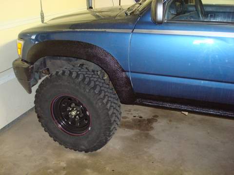

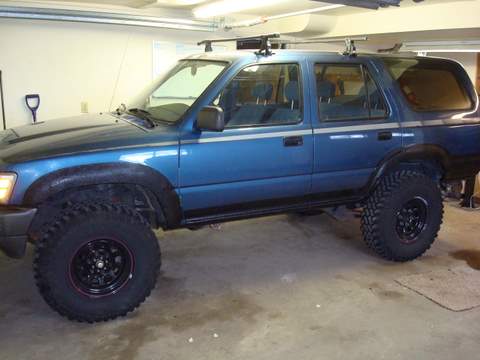

OK, that last post of mine didn't work. I was trying to insert a picture from my picassa web album. Anyways, I got the welding done on the three rust spots. It was a total pain in the butt, but it looks good now. I'll attach some pics of the final product. The welds were not the prettiest, but after I threw on the Herculiner, you can't even tell. So anyways, Im a big fan of the Herculiner now. It went on really easy, and I think it looks really good.
