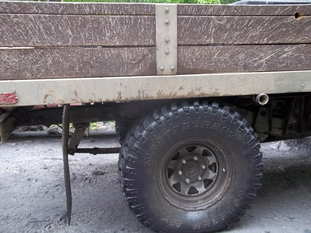

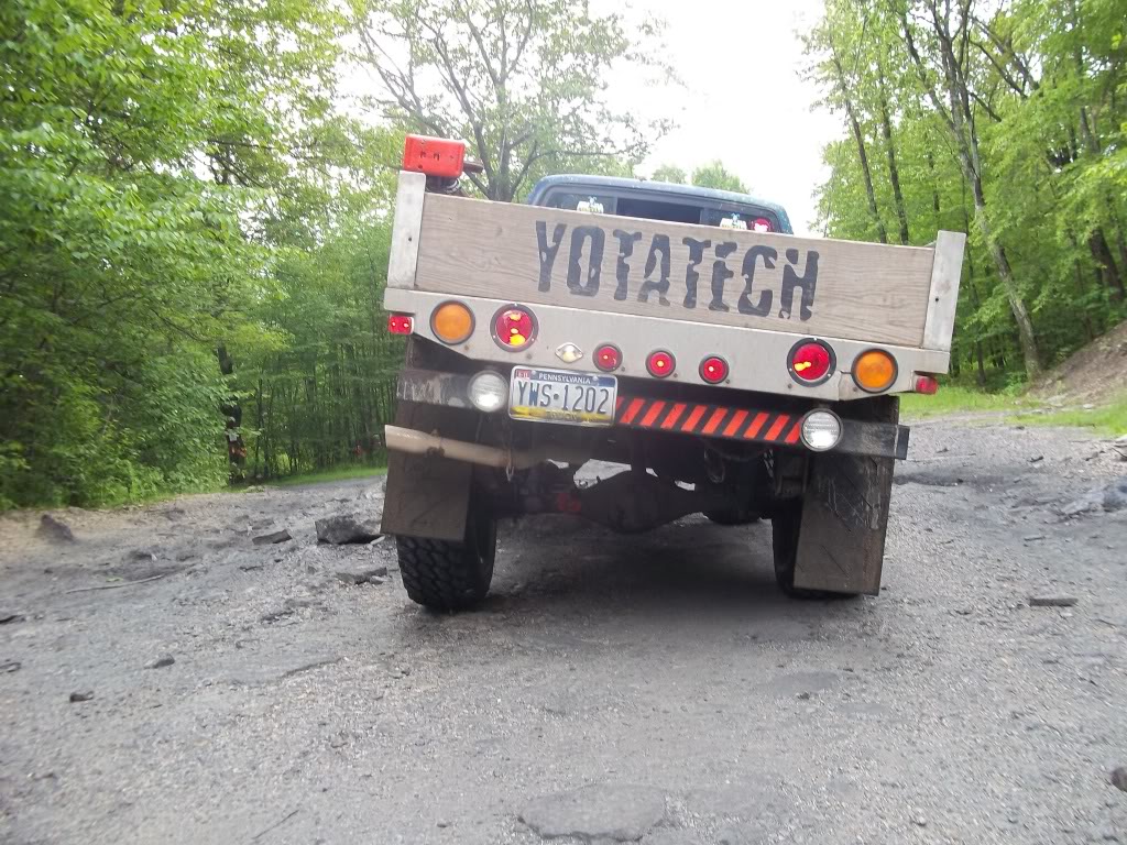

I haven't had any issues with mine as well. It's just something to watch out for when converting to any type of flatbed. All-Pro's not including.
Full uptravel, it doesn't stuff any higher then this due to bump stop. If I were running 35's, I'd have issues.

Right on. Thanks for the help. One other question, if I may...where do you guys get the lights for the back end? This has been my main problem designing my flatbed. Also, what lights are required by law? Thanks again!
Old Jun 28, 2011 | 10:56 AM
  #199
xxxtreme22r's Avatar
Joined: Aug 2009
Posts: 13,574
Likes: 72
From: Wilkes-Barre, PA, USA
Laws vary by state, might wanna Google up your local DMV website. I don't know about toyospearo, but all mine are are 4" tractor trailer type lights and some 2" ones thrown in. The tractor trailer type clearance lights in the corners. The 4" lights you can get the push in grommet style or the screw in types. I have both on mine. The screw in ones are more secure and less prone to theft.
