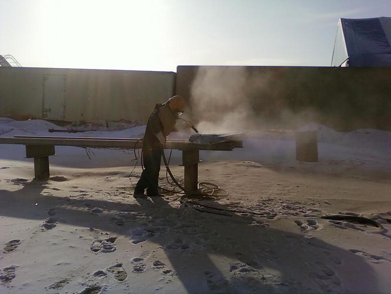

Step 1, tore it all down and sandblasted the heck out of it, man sandblasting is fun!

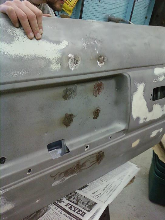

Step 2, cut off remainging bolts from carrier and put some weld around them and then ground those smooth and get it ready for bodywork!
Attached Thumbnails Tailgate revival-cimg1211.jpg   Tailgate revival-sspx0109.jpg   Tailgate revival-sspx0112.jpg

Step 3, going over all the banged and dented areas,, pretty much the whole thing, with a heavier fiberglass body filler, then sanding that down
Step 4, going over it with a lighter filler to make up the small dents left, more and more sanding
As of now its niiice and smooth, and amazingly youd never even know the 8 or so ugly bolts left over from the carrier were ever there!
got booth time set for monday, also doing fenders and hood, to get a few coats of prime and then maybe even paint by tuesday! cant wait for it to actually be all one color!
Attached Thumbnails Tailgate revival-sspx0114.jpg   Tailgate revival-sspx0116.jpg   Tailgate revival-sspx0118.jpg

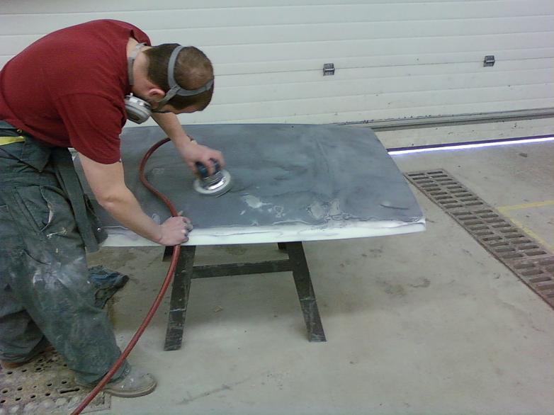

another full day of sanding and bodywork,, filling ,, sanding,, and finally priming!!
Attached Thumbnails Tailgate revival-sspx0129.jpg   Tailgate revival-sspx0131.jpg   Tailgate revival-sspx0134.jpg

a good 3 or 4 hours sanding the primer,, 220, 320 and finally a 400grit,, 400wet on the tailgate and ready for paint!! rockerguarded the insides of the fenders and tailgate, and along the bottom of the fenders
Attached Thumbnails Tailgate revival-sspx0136.jpg   Tailgate revival-sspx0140.jpg   Tailgate revival-sspx0142.jpg

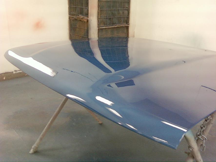

wew! and this is how they turned out!! just sprayed em a few hours ago so they'll be sitting untill tomorrow afternoon to be brought home one at a time.. :S
unfortunately the phone camera doesnt do it any justice
next.. putting the tailgate back together (shoot me)
Attached Thumbnails Tailgate revival-sspx0144.jpg   Tailgate revival-sspx0145.jpg   Tailgate revival-sspx0148.jpg

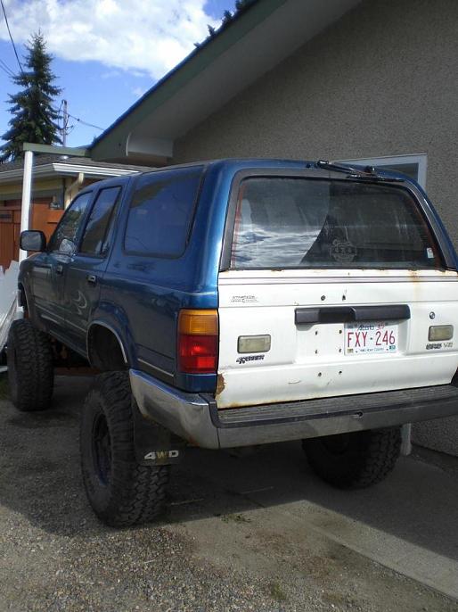

Thanks for all the compliments! Im super pleased with how it turned out,, the rust was definitely an issue though,, the fenders were from my old 4runner, so they were hiding quite a lot of rust under the chrome edge stripping.. or whatever its called.. :S
Which is why most of the flaring on the fenders had to be filled,, just due to holes showing up after sanding/grinding off all the rust,, also why the insides of the fenders got some pretty intense rockerguard treatment
Tailgate also had pretty deep rust along the top and bottom,, and had to be filled with the fiberglass stuff to make up the big dips and holes,,
but yeah now she should be pretty much rust free! the other reason i picked up that body, was cause i literally couldnt find anything on it,, which is amazing for here,,

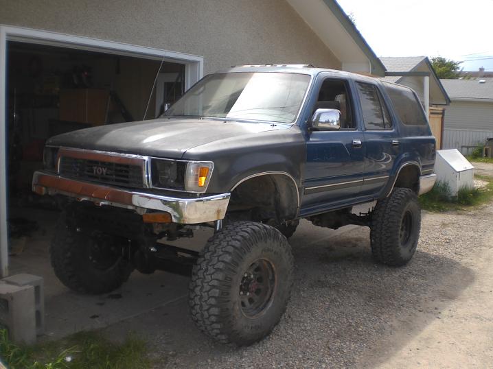

Thanks! Well it wasnt really a body swap,, it was an everything else swap!
I grabbed the blue runner out of a friends junkyard, however it was only the body,, no engine, drivetrain whatsoever, tailgate, hood or fenders, no dash, no front seats, interior was pretty stripped,, and then i built it up from there,, swapped over the good stuff from my old grey 4runner,, tranny,fenders, hood, seats, dash, rear axle, my already once swapped tailgate, swapped the w56 and turned the blue one into a manual, it also had a bit of a wrinkle on the front drivers side corner so i cut out that section from the other 4runner and swapped that over,,
and also did SAS and put a 7MGE from a 89 Cressida in, because it was sitting in a yard the wiring was also pretty stripped and crazy to try and figure out so most of the wiring also had to be custom done, even for simple stuff, park lights, headlights, brake lights,, still havent figured out the reverse lights,, but it will come
As far as a body swap goes,, knowing what I know now I think it would be a lottttt easier to find a good body/frame and build up around that, thats what i did more or less its taken lots of time but its really worth it
haha (dont ask about my 'engine hoist') the single 2"x8" held it just fine!
