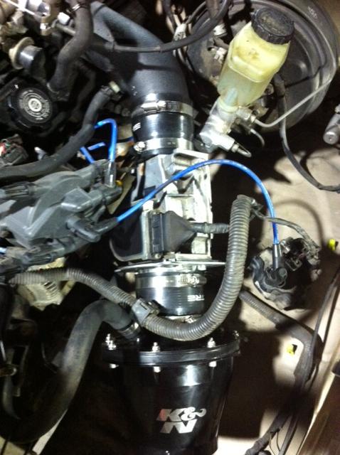

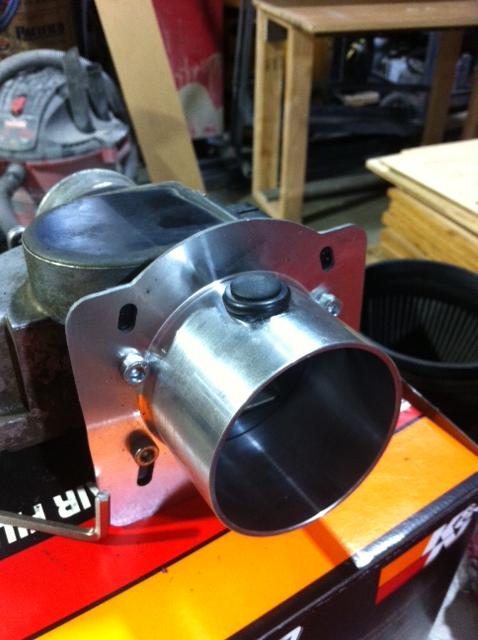

Mounted a 3" inlet adapter (spectre) from Advance Auto to the MAF. This was a 'Universal" part which meant I expected it to not fit at all and I was right. The pre-drilled holes in the aluminum adapter were spaced too far apart. However it came with a plastic insert which had perfectly spaced holes (this part is meant to be a fit for the Camry MAF which I know people have swapped in)... So a quick whirl with a sharpie and a trip to the drill press and boom... On it went
Next hurdle... The K&N apollo enclosed/inline air filter I had purchased to be the main filter element had a 70mm outlet on the MAF side... and the adapter was 3"... So my temporary Mcgyver fix was the magical duct tape to increase the diameter of the filter outlet to make it fit snug in the adapter
On everything went for a trip to the parts store take 2
As you can see... It is a tight fit with the adapter adding enough length to push the long filter element/housing up into the back of the headlight... This just would not do, as I need room for an elbow through the fender wall.
This was the solution I came up with
Junked OEM rubber flexy downtube thing for a 3"-3" rubber adapter from Intake Body to reused K&N FIPK tube (handily tapped for a vacuum hose already), once the hose clamps cinched down they fit snugly. A 3"-2.5" rubber adapter for plastic FIPK tube to MAF which required nothing other than a little persuasion. And a 3"-3" rubber adapter worked great for the MAF-filter outlet tube, the hose clamp was tightened down around the neck of the K&N and it is solidly attached and sealed.
Last thing to note was I (as seen in pic) tilted the MAF so the sensor is tilted to about 0130... This made it clear both the master cylinder and distributor cap and positioned it so there isn't anything fragile for it to bounce on/around come the inevitable offroad jolting.
I also routed the valve cover breather tube up and over the FIPK tube, under the throttle cable to a small filter element right underneath the upper portion of the hood, I figure if I am in water that deep I've got bigger problems than water in there
Now there is plenty of room for fiddling around with the inevitable erector set of PVC to come

What I have so far
Pulled K&N FIPK (biggest waste of $100 bucks...), only thing worth keeping out of that whole kit was the molded plastic elbow which came in handy
FIPK junk apparently found a new home in my toolbox,

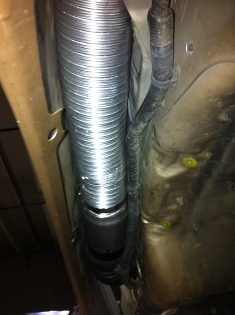

Then it was a simple matter of routing the piping I wanted to the back of the fender, where progress halted for the day. I ended up reducing the piping to 2" ABS after the flexible hose portion for fitment issues w/ 3", I may go back up to 3", all depends but this seems to work for now
The last thing I did was grab a 2" pipe clamp, bolt one end into the fender and bend it 90* so it holds the 2" ABS pipe securely (unless I go upside down in which case I have bigger issues

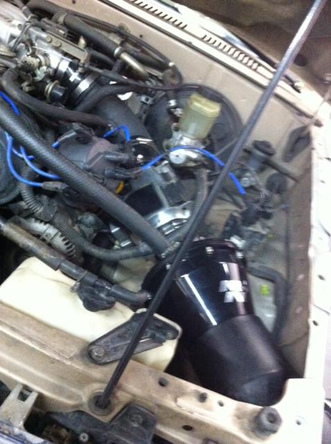

A crappy picture of inside the engine bay and everything attached (I am singlehandedly helping spectre intakes turn a profit this quarter)
Next step is deciding if I want to route it up the A-Pillar to the roof or just pop it through the fender straight up. I have decided at this juncture to run a pre-cleaner or scoop. Anyone with experience can chime in right... NOW
Any my last question, is 2" ID ABS a large enough pipe to keep from robbing precious horsies from an already under-powered engine?

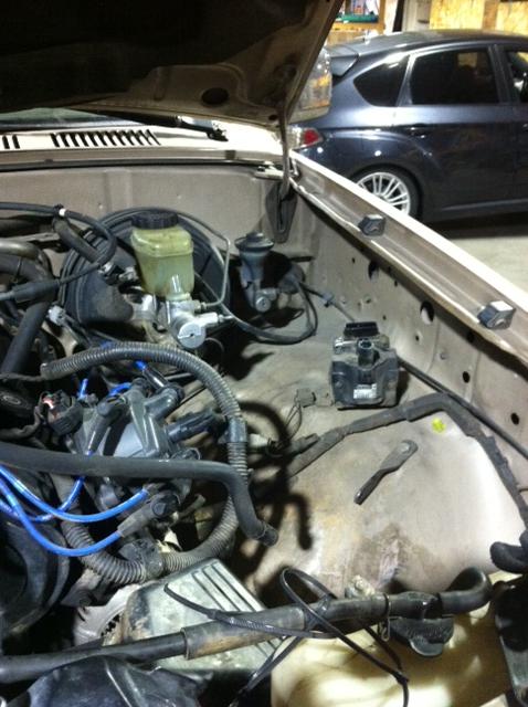

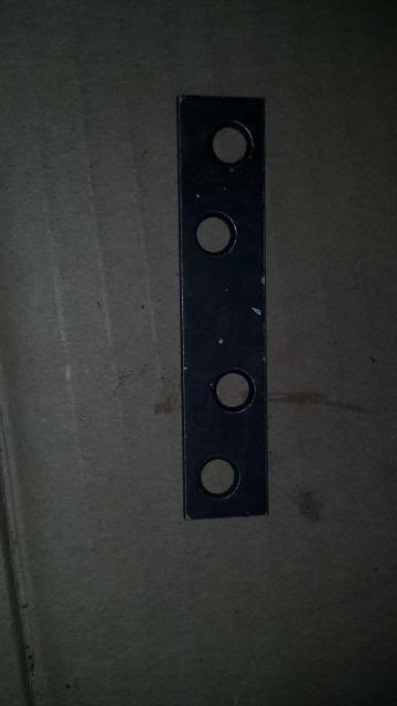

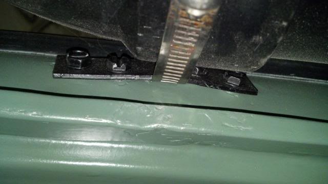

I used flat metal straps, from Lowes (in the hardware section) held down with 4 self tapping screws and hose clamps.. the snorkel has been on the truck for 4 years with no issues other than knocking the head off it a few times... I think the adapter I used was the problem there.. I have a rubber one now so it flexes better and I try harder to watch for low hanging limbs...
If you want I will try to get a close up picture for you tomorrow..

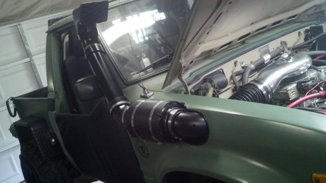

Well progress has halted for a few days, mountain vacations will do that so not much of
and a lot of
... And am currently researching head/pre-cleaner options. There seems to be a significant lack of heads with inlet ID's of anything close to 3.5" (OD of 3" PVC/ABS pipe)... Am currently looking into options and a way of adapting it w/o making it into a telephone pole of adapters/brush snagger. OD of ABS pipe is 88mm (avg) and all the "3.5" heads are 85mm... Inquiries sent to multiple places
And as far as pipe diameter I have driven with it a couple hundred miles (hwy commuting) and not really noticed any problems or lack of power, will prolly stick with the 2" (or 2.5" if I can find it) for now and a ram head... Great info though and when I can get around the rear inner fender support and pipe fitment I will look toward larger piping later down the road... There is a rear leaf swap imminent (waiting on parts) and a homebrew swing away has been drawn up, waiting for the swap to check shackle clearances on any bumper supprots... this is sort of a side project to take up the intervening time... Hehe... There are perks to only partial gainful employment

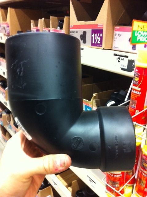

This is a picture of the pipe I routed underneath the fender once the chop was complete... It is the bendy neoprene to a 3" ABS piece of pipe, and then a 3.5" (the OD of 3"ABS pipe) to a 3" reducer. I then got a piece of flexible dryer tubing (which is surprisingly tough) and routed it from the coupler to a 18" long 3" exhaust pipe I was using as a test piece, I originally tried using flexy exhaust tubing but it wasn't bendy enough
